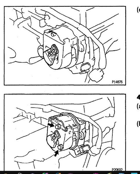

    the rotor will end up in the 1 o'clock position.
    Sounds like you have fuel then.

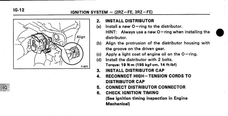

    Should look like this with 1 on TDC

    It sounds like you installed the distributor with the engine at TDC at the end of the #1 compression stroke, but maybe you got the distributor gear one tooth off. It kind of rotates as you install it.

    I honed the cylinders and the head was machined and pressure tested. All new rings, bearings, gaskets, water pump, and gaskets. I pressure tested it and all cylinders had good pressure. All hoses are connected properly. I installed the distributor as shown in the picture above.
