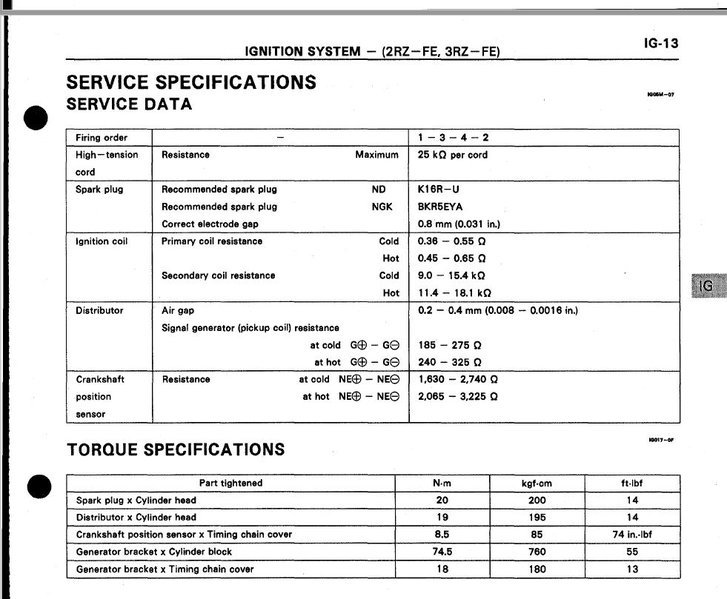

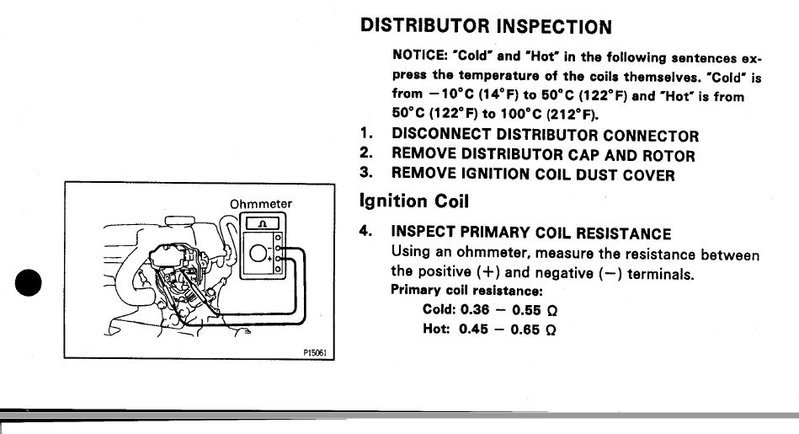

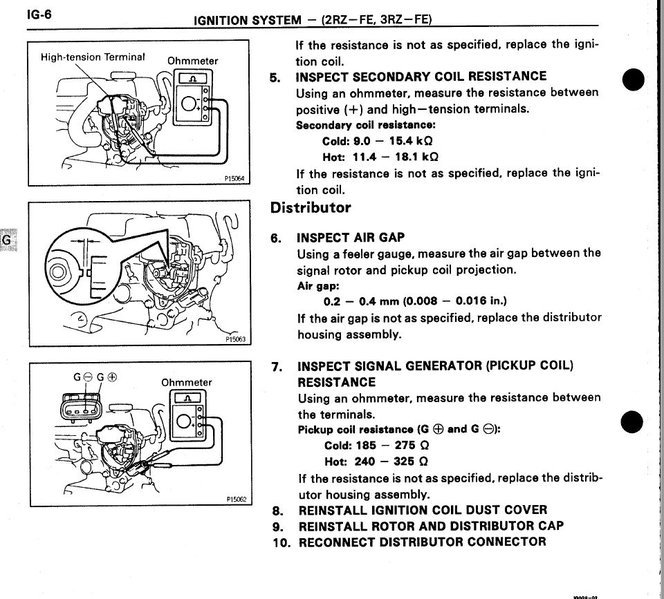

    Make sure the dist is turning also.

    page ig-13 of the pics I posted under distributer.
    and make sure it turns with while cranking engine.
