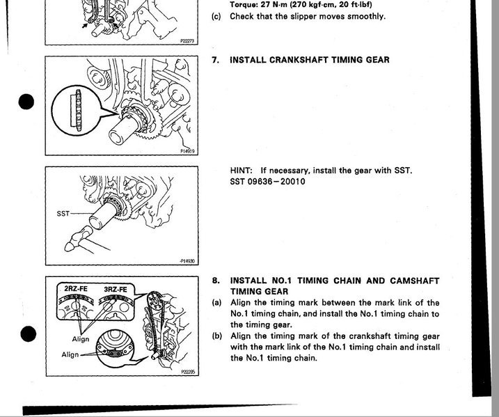

    not sure but according to manual it uses the plated link method. Odd colored link lines up with marks.4cyl timing.jpg

    They actually have a special service tool number for a ball pin hammer. Awesome.

    SST = Stainless Steel Tapper
    :rofl:
