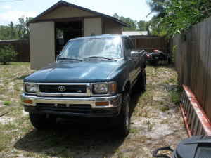

    I'm headed to look at this truck tomorrow. Owner says its a 1995 with 112k miles. 4wd, V6 auto. Can anybody tell me by looking at the picture if this is a Tacoma or a "Pickup"? I understand that 1995 was the crossover year for the two.
    In either case, can anybody tell me anything in particular to look for on these trucks? Price is $4400, btw.
    Thanks,
    Josh

    That's not a tacoma.
    Tacoma's started in 95.5 (yes, half year).
    The 95 trucks were pickups.

    those v6 are notorious for blowing head gaskets, but toyota is still replacing engines that are blowing them to this day, i have no references but you can google it, should be nice, 15 year old and only 112k, good luck

    That's a 'PreTaco'. The V6 is the 3VZ (early VZ series ancestor of the Tacoma's 5VZ).
    I had a 1993 3VZ XtraCab 5-speed. The engine didn't have much 'pull' for a V6, but it cruised well. I got about 150,000 miles out of it before some !*Z#*&% totaled it. My only issues were the classic 3VZ head gasket (replaced under warranty @ circa 60,000 miles when it showed signs of failing) and a water pump @ circa 90,000 miles.
    The 3VZ isn't quite as bad as its reputation would suggest, but it's definitely the worst engine Toyota ever put in a mini pickup. I don't imagine an automatic would help it at all ...
    There's essentially no aftermarket upgrade support for the 3VZ. The most popular mod for a 3VZ truck is to swap it out for a 5VZ. If you're looking for a long-term build project, it might be a good truck if you're willing to commit to an engine swap somewhere down the line.

    Easiest way to tell if the head gasket was done is to call any Toyota dealer with the vin and they will let you know. Of the three gen 2 Hilux's that I had, all three were done under 100k miles so I was comfortable buying them. Other than that, there is nothing to worry about with these - my favorite style to this day. Was well ahead of its time when it was released, with its smoother lines and simple design. Other trucks from that era look way, way more outdated.

    not a tacoma. but looks pretty damn clean for a 95. mileage is great too. i would pay 4 for it too :thumbsup:

    Other than having one of the worst Toyota engines ever designed and put into one of their vehicles, it looks nice. Bad power, bad fuel mileage, blown head gaskets, etc.

    thats not a tacoma, thats the first crossover of toyota pickup truck. i have the 95 first gen. tacoma. if you don't know, look at the side of the door panel under the side mirror and it should say tacoma.
