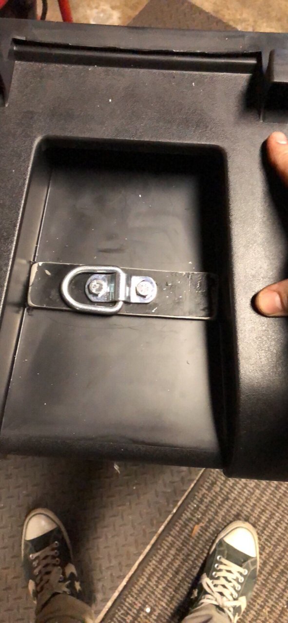

    Sorry after trying to look for the link I messed up the name. Plano is the company.
    I have two of these https://www.walmart.ca/en/ip/plano-storage-trunk/6000066423343
    And one of these
    https://www.walmart.ca/en/ip/plano-191900-sportsmans-trunk/6000194834296
    I used aluminum to sandwhich the plastic so I could put a d ring. This allows me to properly strap them down and still be able to have access to the bin.

    SPC LR UCA's Bilstein 5100's OME 885's OME Dakar MD pack Timbren Active Off-Road bump stops w/ U-Bolt flip Cooper S/T Maxx 255/80/17 ARB Twin Compressor Husky Weatherbeater's
    Thanks for the idea on strapping them down, I have unlimited number of those d-ring's as they use them at work so I can loot all I want.
    I got 2 of the plano ones from Amazon last year but wanted to strap then down so I could get inside with out unstrapping them.

    Yeah. Just some aluminum or steel or even a thick plastic to sandwhich the bin so you you don’t rip the rings out.
    Nothing worst than haveing to unstrap when you need one thing. This allows you complete access and still be able to remove them if needed (compared to a drawer system that I also looked at doing). For swisha want to move the kitchen away from the sleeping area. Can unstrap and haul the kitchen tote to the cooking area.
