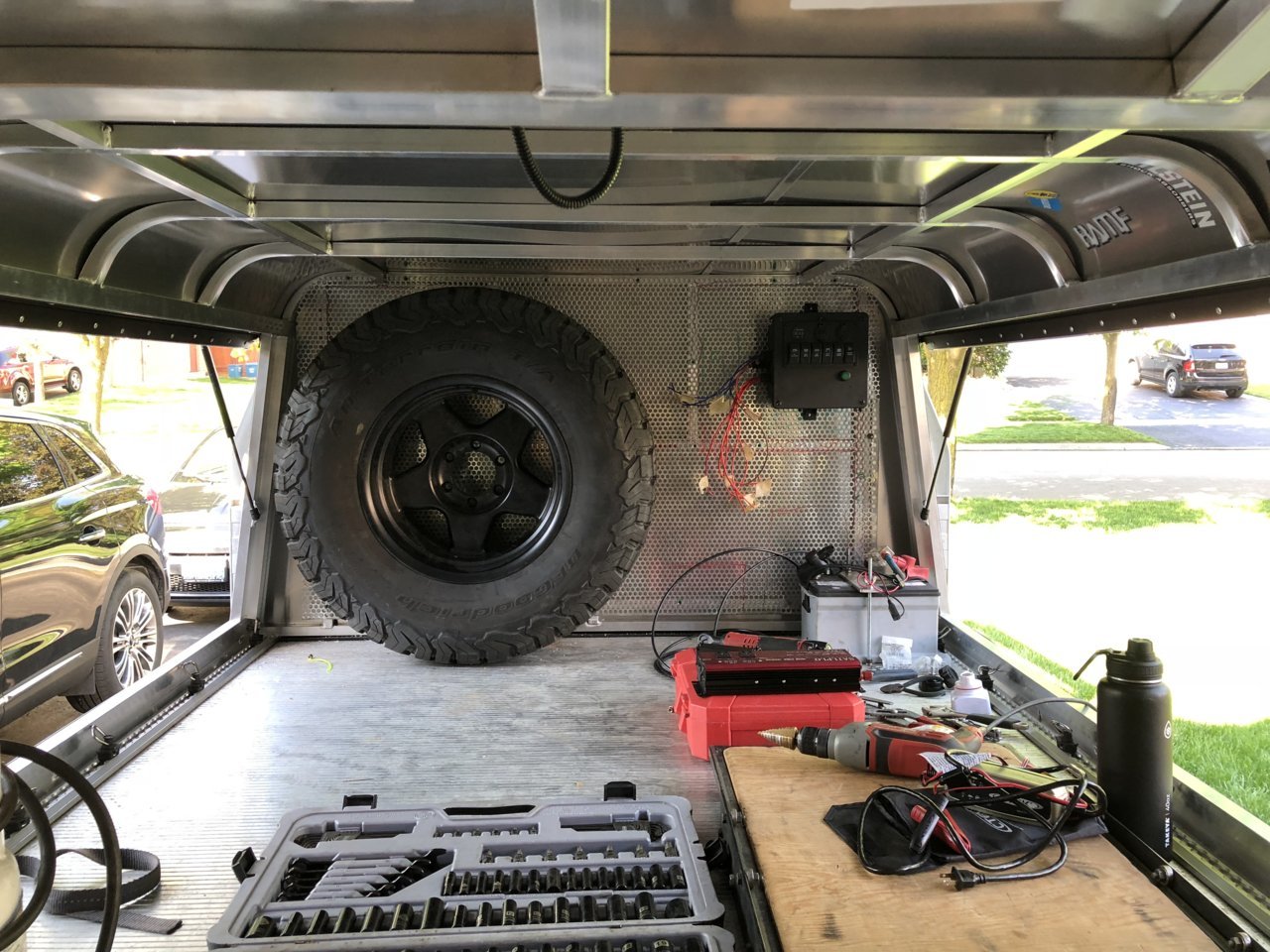

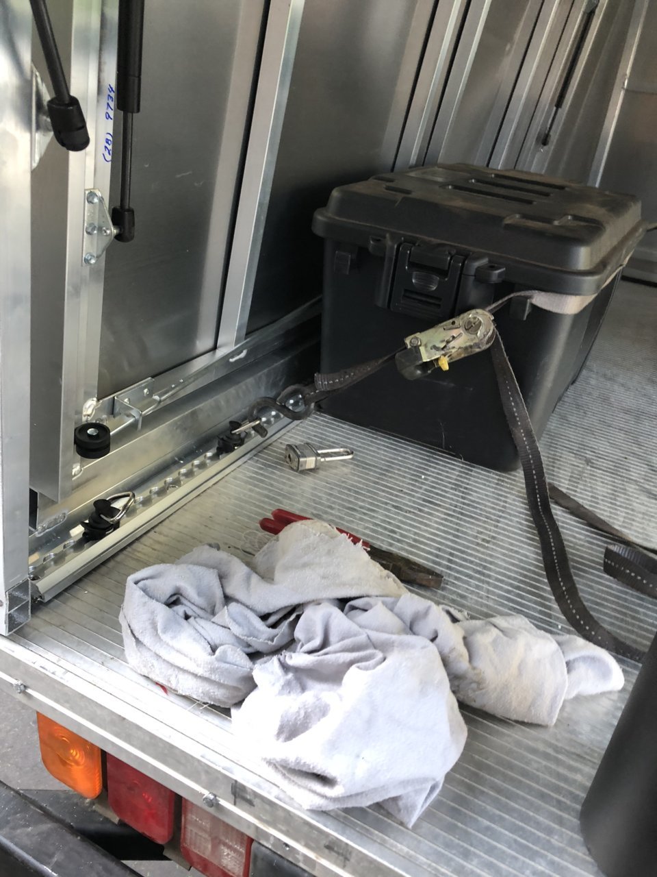

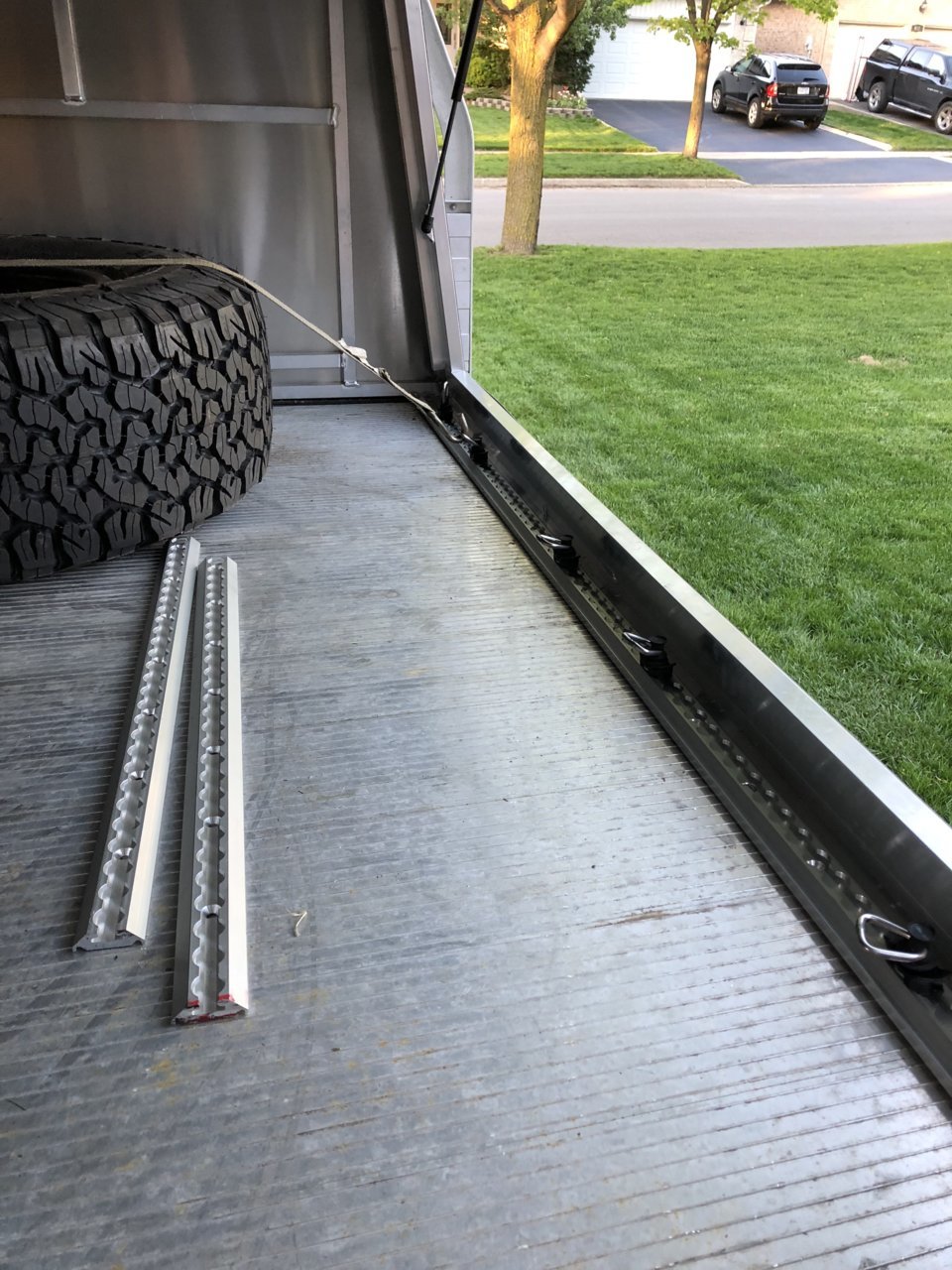

    So the truck is back together now and I am able to drive around.
    The way the cap was mounted wasn’t the greatest (4 1/2 bolts) which caused the bottom of the cap to not sit right and not be as secured.
    I used the l-track to sandwhich the cap between the bed. I used all stainless hardware and fender washers in the bottom of the bed to sandwhich everything for strength.
    The extra pieces will be going in the middle.
    Also started the sticker collection
    And a pic of the suspension
    I still have a ton to do to the cap to get it ready for the first camping trip in two weeks.

    Looking good. Make sure you have something between the stainless fender washers and the aluminum. Nylon washers or something, even stainless hardware will eventually rot out the aluminum.

    I wasn't aware of that. I may have to look into that. Thanks for the heads up.
