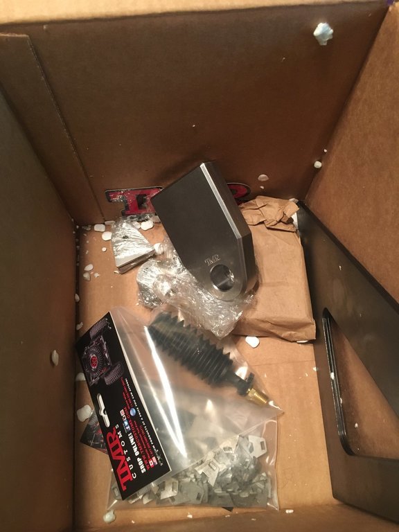

    Nice box from TMR customs. Couldn't believe how well they packed it. Never seen so many packing peanuts. This was after I took them all out.
    Everything wrapped not to ruin the finish even though its a recovery point. Lots of pride in their stuff

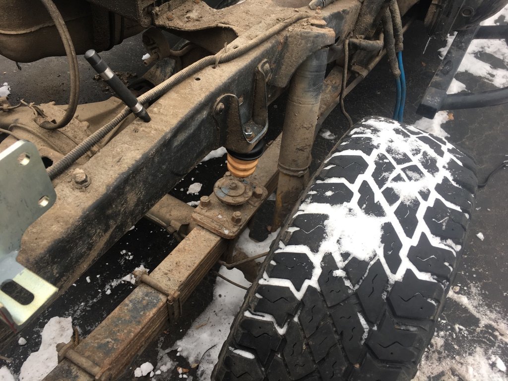

    Progress. The bed is sitting there. Not bolted yet. Need to get some tube to help relocate the filler neck. I think it’s a breather tube.
    Also got the gm bunpstops mounted.
    No more expensive aftermarket. $100 for two in town. Bolt right in without messing with u bolts.
