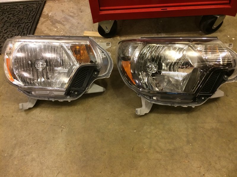

    Correct, the TSB updated lenses resolved the DRL melting issue. They are available in smoked chrome for an subtle more aggressive look.
    Here is a copy paste from the headlight thread:
    OEM 2005-2011 smoked headlights:
    These are like the Pro lights, but came on select Sport models. These are available loaded with bulbs, and unloaded w/o bulbs, saving $60 off the set . These part numbers are for the unloaded housings. These are the updated TSB version of the lights that do not have the melting DRL issue.
    Right #81130-04173
    Left #81170-04173
    Stock compared to Smoked (2012+ pictured)

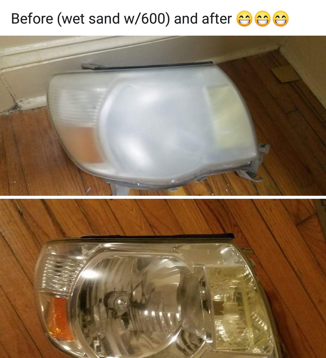

    If you have access to supplies and equipment to spray some automotive clear on those cheap aftermarket headlights I'd say get whatever lights you want.
    Im not sure if you have tried this before. I had clearcoat leftover. Results did not include any additional buffing which I did later on in the process
