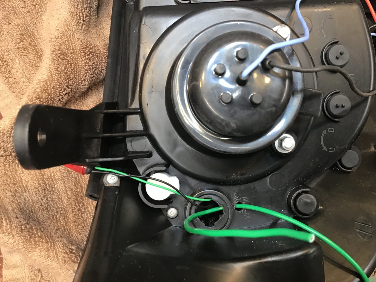

    Ok I have my new light on the work bench ready to install. 2010 OEM DRL’s are part of the Turn Signal, so my opinion is I will still have the Amber DRL’s and the now the Light Bar DRL. Since the Light Bar is being powered off of the Side Marker does that mean I have to have at least the parking lights on for it to work. To lazy to do a little research but does anybody know which wire on the turn signal harness is for the DRL’s, thinking of cutting that wire and connecting it to the Light Bar wire thus have the side marker land separate DRL and no amber DRL. Hell I will just get my Fluke Meter and test light and find out which wire it is. Don’t want tear apart the front more than once.

    I have been testing way of connecting the DTRL's Tube so I don't have to run them off the parking light circuit. I also would like to ditch the Amber OEM DTR and just have the turn signal/parking light. I can run the LED DTRl light bar as a DTRL/Turn signal by taping into the OEM DTRL/Turn signal wire but have to use the OEM Amber DTRL/ Turn Signal to prevent hyperflash if I remove the Amber Bulb I induce hyperflash in the Turn signal. Probably the simplest solution is to wire the LED Ligh Bar to a switch in the dash and live with the OEM. DTRL/Turn signal. I know I could use a resistor or do the Stealth DTRL mod. Resistor would be my choice

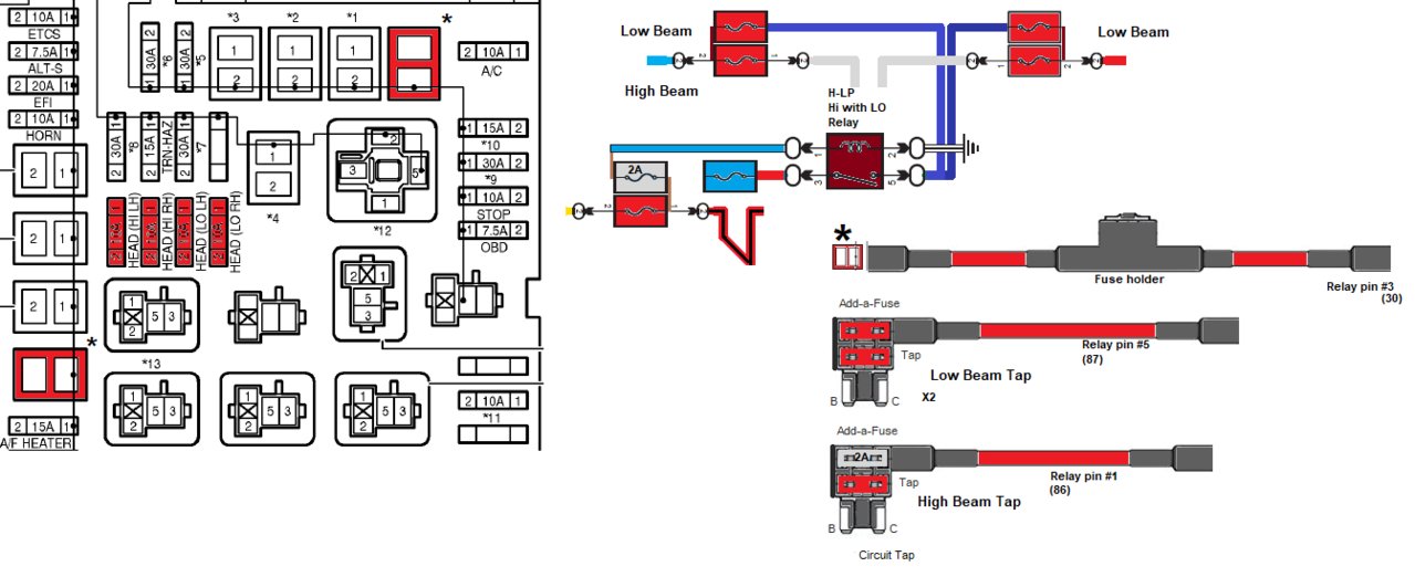

    05 PreRunner TRD Offroad AutoTrans
    Hood Struts, My version Fogs always ON, Map & Overhead Light Mod,
    OR
    This one is "easier"...place add-a fuse in opposite directions on the low beam tap so they fit. Use Left High Beam fuse for trigger on relay.

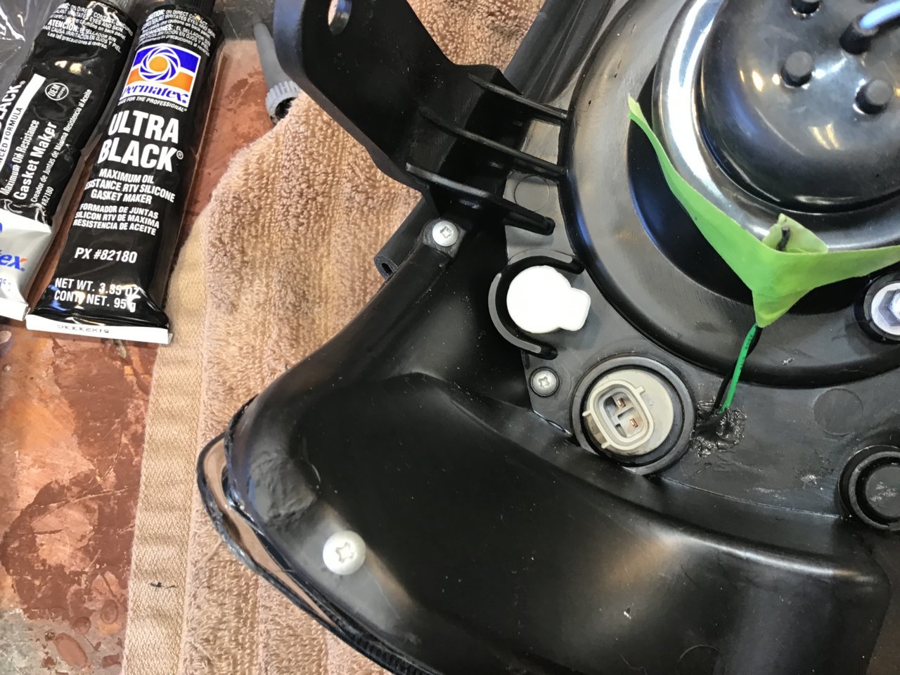

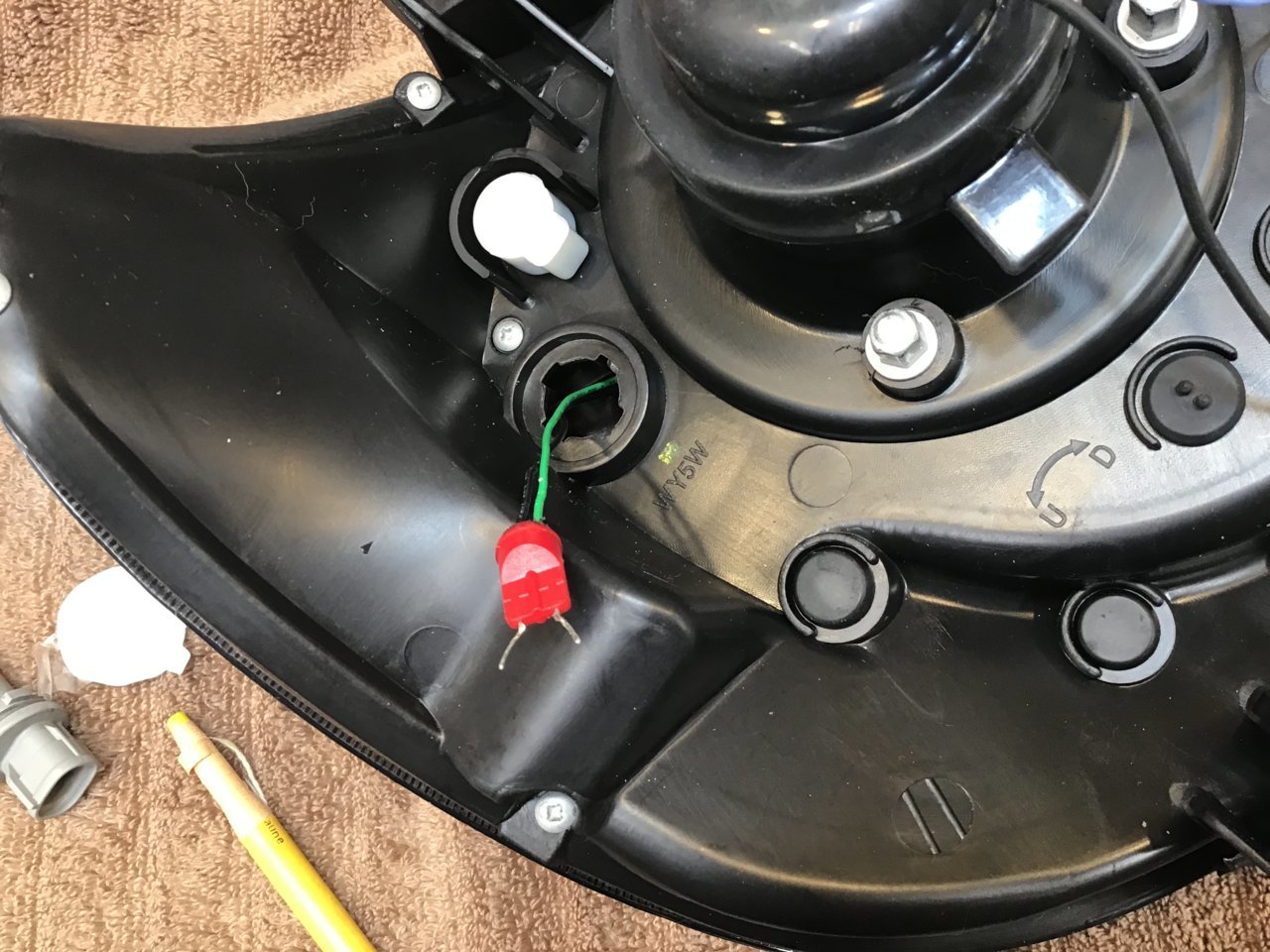

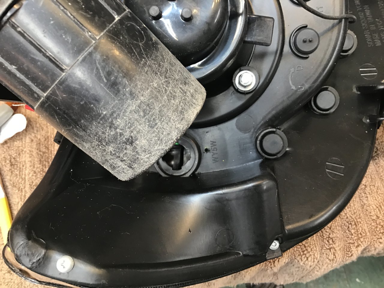

    Figured out what to do about Factory DRL’s. Will go under dash and cut the wire and add butt Connectors for adding switch or for reconnecting if OEM Light are reinstalled as was covered in a different thread. I did modify the LED light bar wiring so it will not be part the side markers. I will eith use a switch or a circuit that is on when engine is running. Drilled 1/4” hole in housing, cut off connector and fished Light Bar wires through hole, sealed hole with RTV. Will extend ground wire to a chassis ground and the power wire to a source to be determined, more that likely to a switch on dash.
