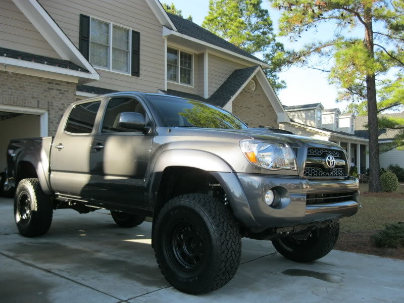

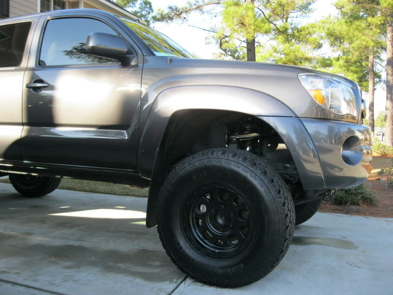

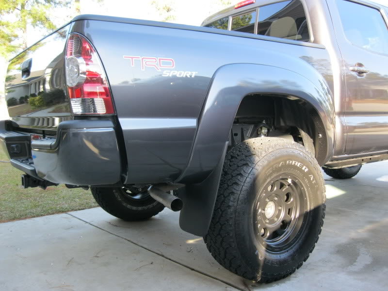

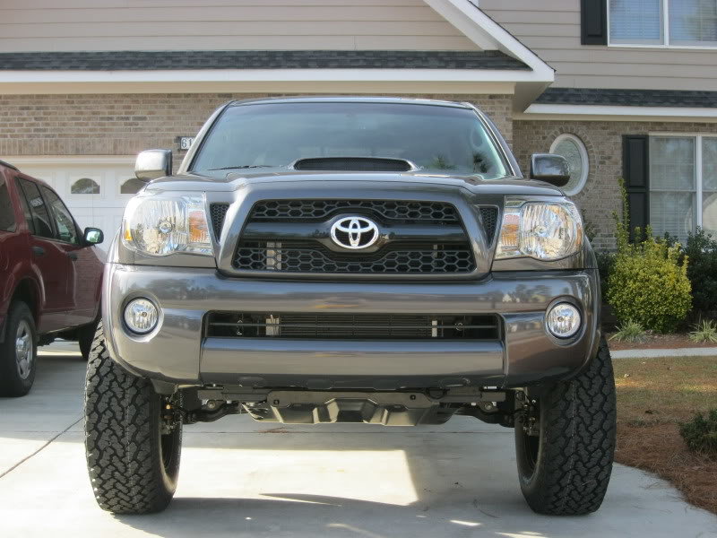

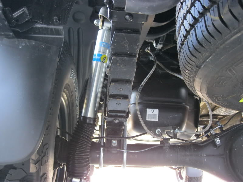

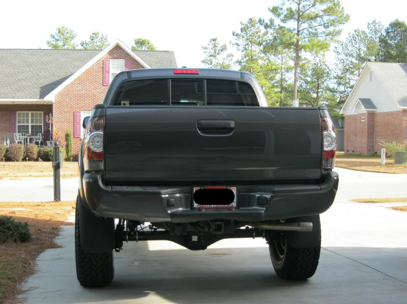

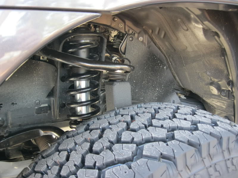

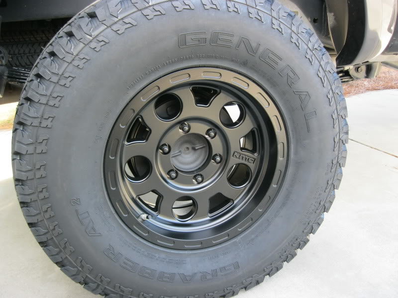

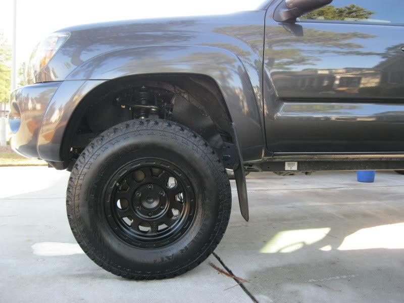

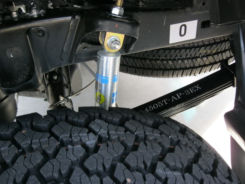

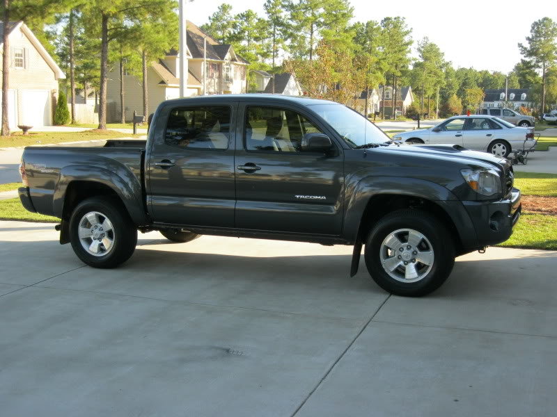

    Truck Looks great, what was the total cost of the total lift only??? ThanksIMG_0160_9b1f625e04f8df31f8050cb21ac5dfa97c54dcb7.jpg
    IMG_0159_183783112f51df50014fd5da83c61557b0ed80b8.jpgIMG_0158_780dfab1bd88b77c776fd92ebeaa49cdc633b49d.jpg
    The day I brought her home:
    I put the following on my truck (2 days of install time):
    - Camburg spindles w/swaybar provision
    - 5100's up front set at .85
    - All Pro expo leafs
    - 5125's in the rear w/loop to stem adapters
    - Extended brake lines both front and rear
    - Black 16x8 KMC Enduro wheels
    - General Grabber AT2 - 285/75/16
    I had never done this before so I took my time to make sure I didn't miss anything. I will say this - ideally you need 2 or more people for a project like this. Installing the expo springs by myself was a huge pain in the ass so I had to get creative and use storage boxes to hold one end of the spring up while installing the other end. Lot's of cussing and I think I pulled a groin muscle installing the rear end. Spindles took just a tad bit of grinding near the weld where the calipers fit on. Brake lines in the rear are a major pain unless you have Inspector Gadget arms and baby hands.
    Here she is after I brought her home from the wheel/tire install and the alignment:D
    Things I still need to do:
    - Re-install Tacoma badges (painted them black)
    - Paint the rusty front hubs black (or may cut my center caps and shove them in, they are waaay too long)
    - Trim my antenna because I almost broke it off pulling into my garage:eek:[/QUOTE]
