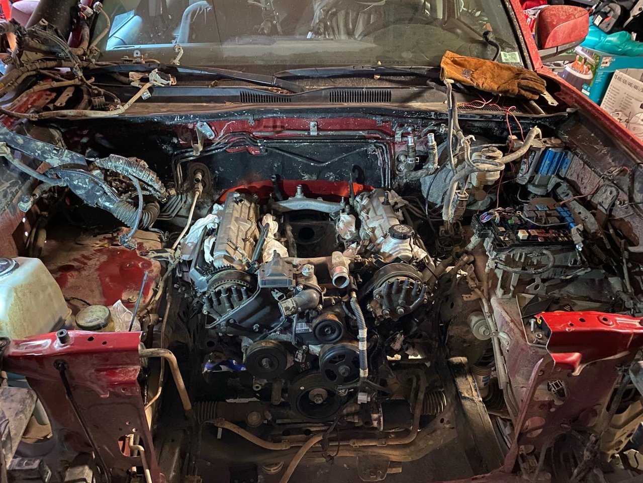

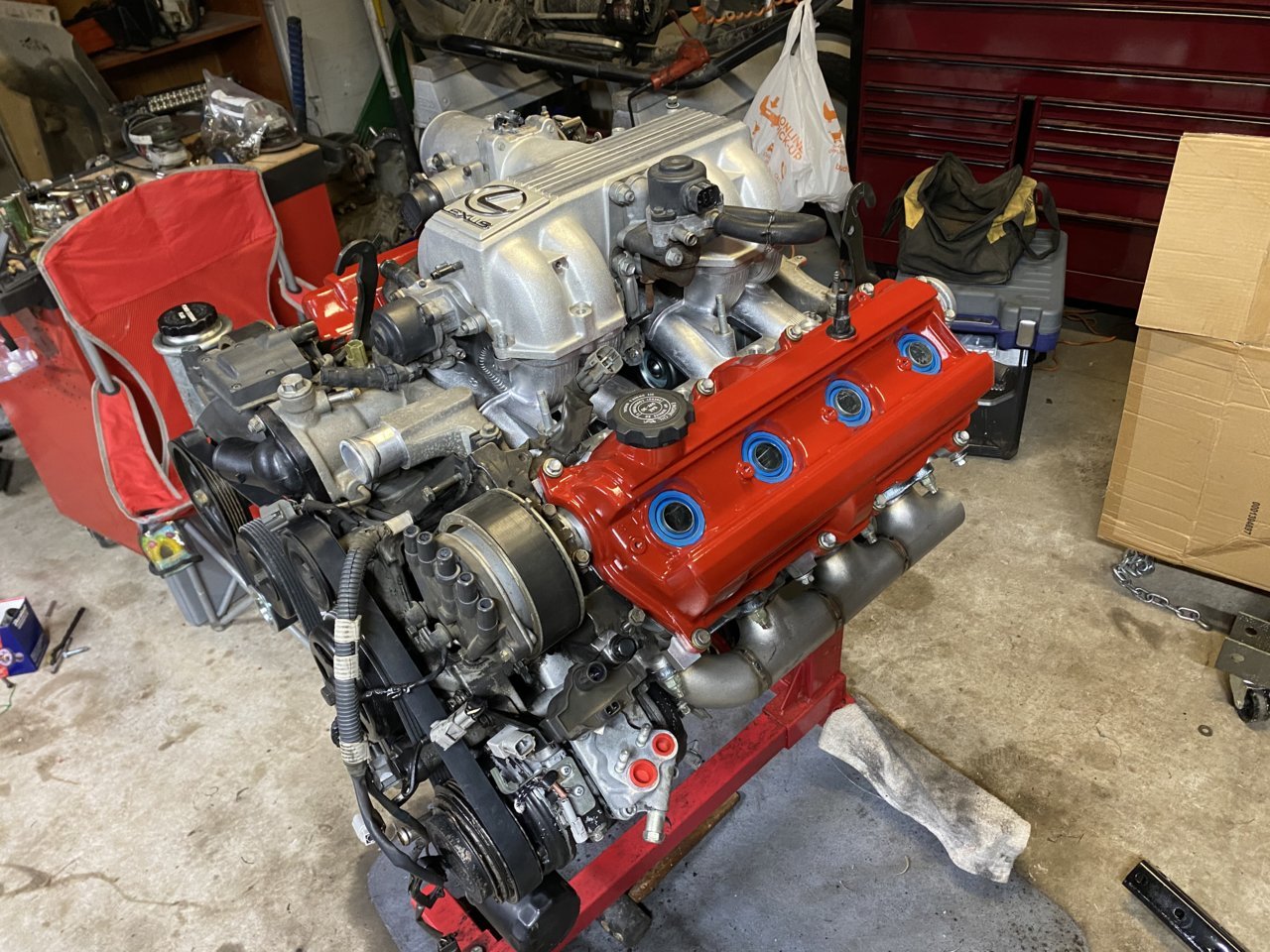

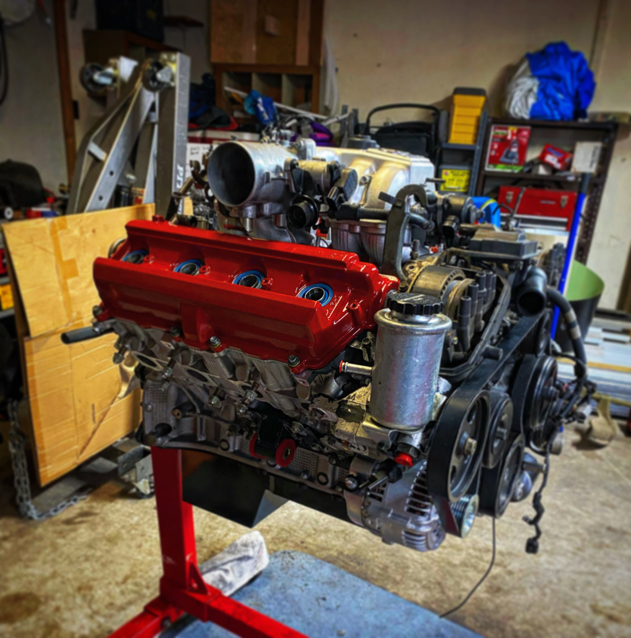

    06294994-FE67-4E89-8B5E-A834818247B7.jpg I have busted hump on this thing the last couple weeks. Stripped it down, cleaned up the parts and the motor.
    -Fabbed up a transcrossmember
    -Braced the motor mounts and finished welded them. Threw some paint on them too
    -Painted the valve covers in red, closet thing off the shelf I could find to match the truck yet. It’s not perfect but it’s red
    -New gaskets and seals for the valve covers installed
    -Installed the oil pan with gasket now
    -Installed all the accessories, new a few little bits to finish them up
    -New thermostat, housing and gasket
    -New plugs
    Headers will be here Tuesday and the wiring harness should be done in a week or two. Once I have the harness I can finish installing the plenum, intake and all those gaskets.
    Then I can drop the motor and trans back in the truck and really get to the hard part of this install.
    But, it’s progress and I’m stoked. Cheers to the new year’s shenanigans! :cheers:

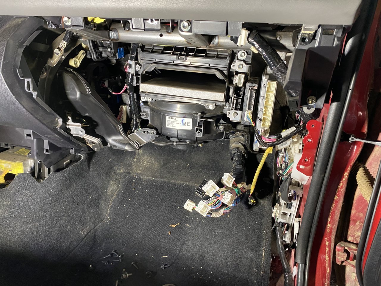

    272012D6-C34A-40D8-8CB3-0F2390EDDE5F.jpg Finally pulled the original harness out of the truck. Wasn’t terrible, found the glove box comes out pretty easily. Access to the ecu and 4wd control module is right behind the airbag mount.
    Boy howdy, I am in for it. This would officially start the hard part of the swap lol

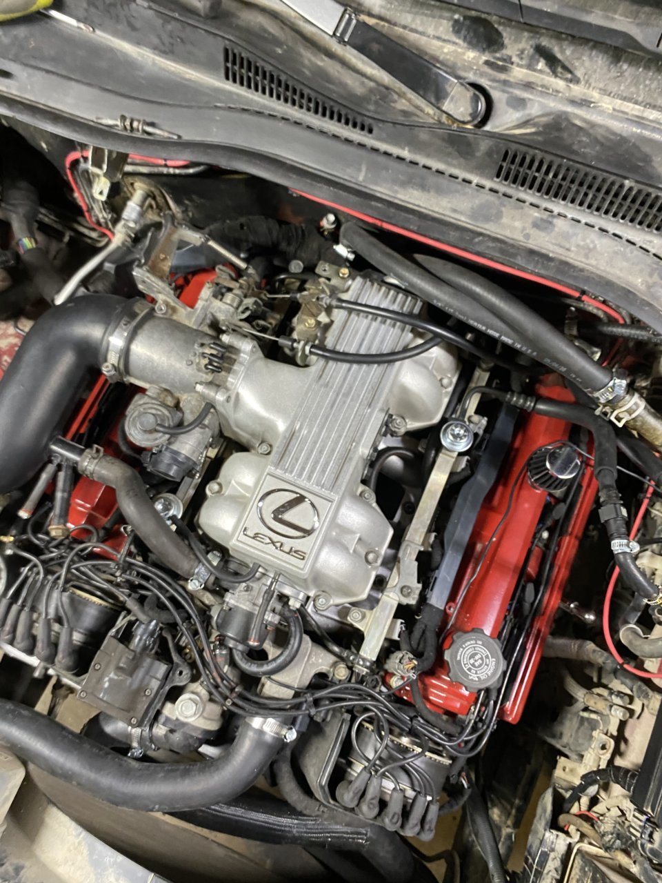

    Well it’s been almost two years since the truck drove by itself. It did that today. Finally got enough done to drive it around the neighborhood.
    Have some sensors to clean up and adjust, some more exhaust work to do and put the bumper, hood and other random crap back on.
    It’s looking like it will make it out for the weekend :burnrubber:

    Been chasing electrical gremlins for a couple days. Started with no idle, unless given throttle. Then, went to no acceleration and stalling when I would let off throttle.
    Now, we have a minty idle. Acceleration and no stalling.
    Throwing parts on it to have it ready for the weekend.
    Cause of all the problems- Chinese ignitors. Factory Toyota ones solved it
