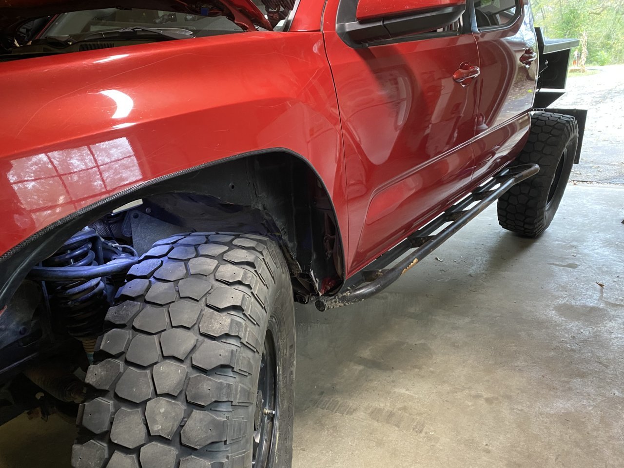

    My wife hates me, but she did say I need bigger tires....again. Dang woman, chill.
    mock up stage

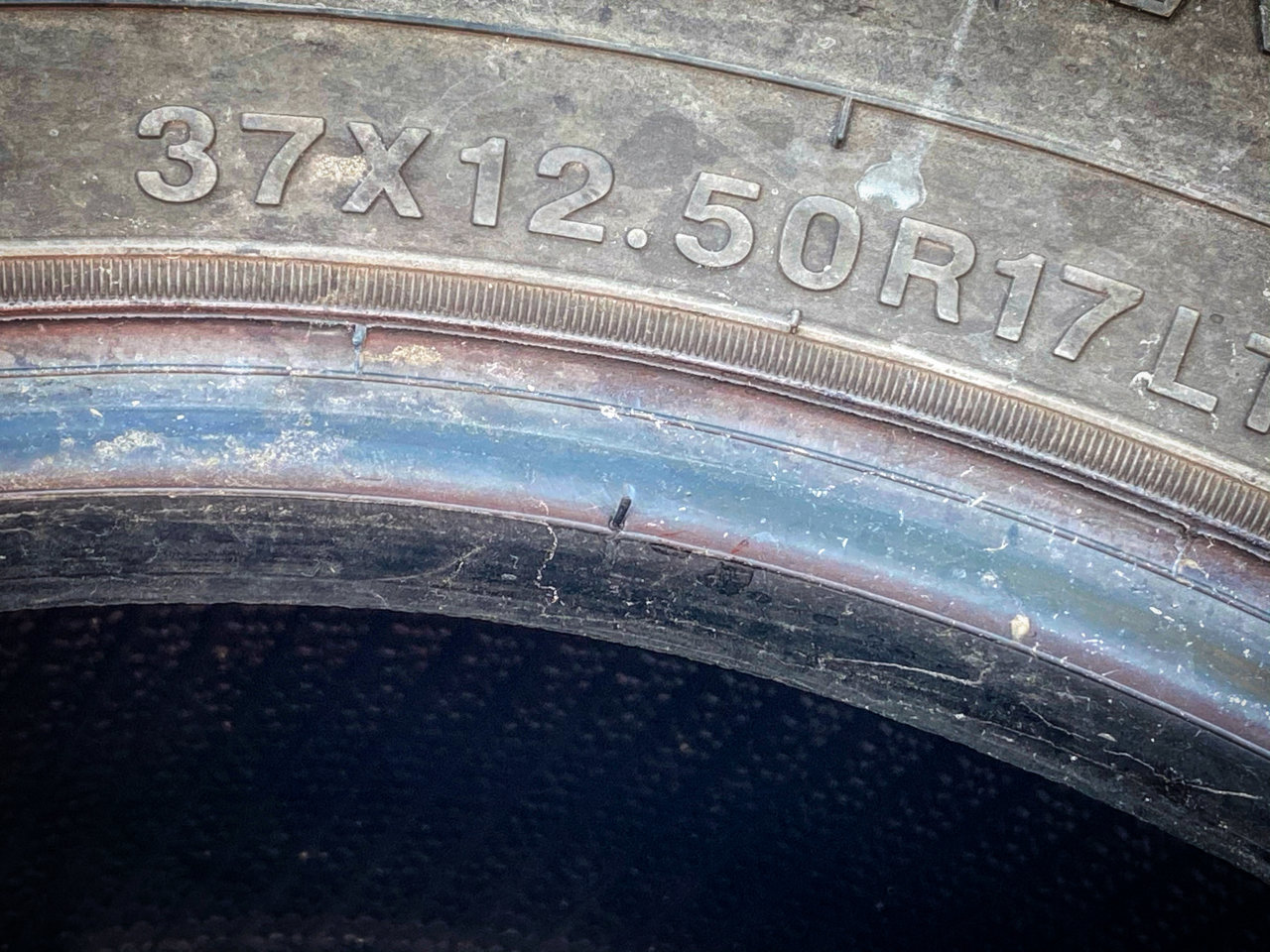

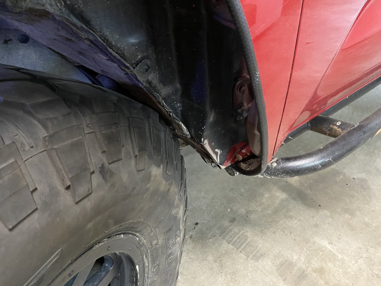

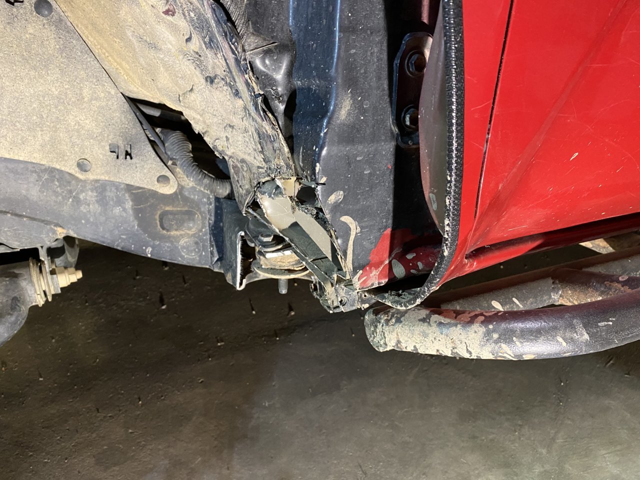

    Started fittin dem 37s this past week. I’m slow and unmotivated lately but I got the drivers side *kinda* ready. Have to plate it, seam seal it, and undercoat it. I test fitted it the best way I could (jack stand with wood blocks under rear axle until leafs hit bump stops) and it cleared. I will have to go up a little higher on the pinchweld. The real test will be when I go wheeling again.
    Getting a new set of 37 12.50 17s so they will be obviously taller than these (current ones are mock ups) and I may have to do some more massaging.
    Body mount- can’t say there’s much left of that. I’ll do a relocate but I’ll make my own.
    Here’s a shot of where I cut and how much
