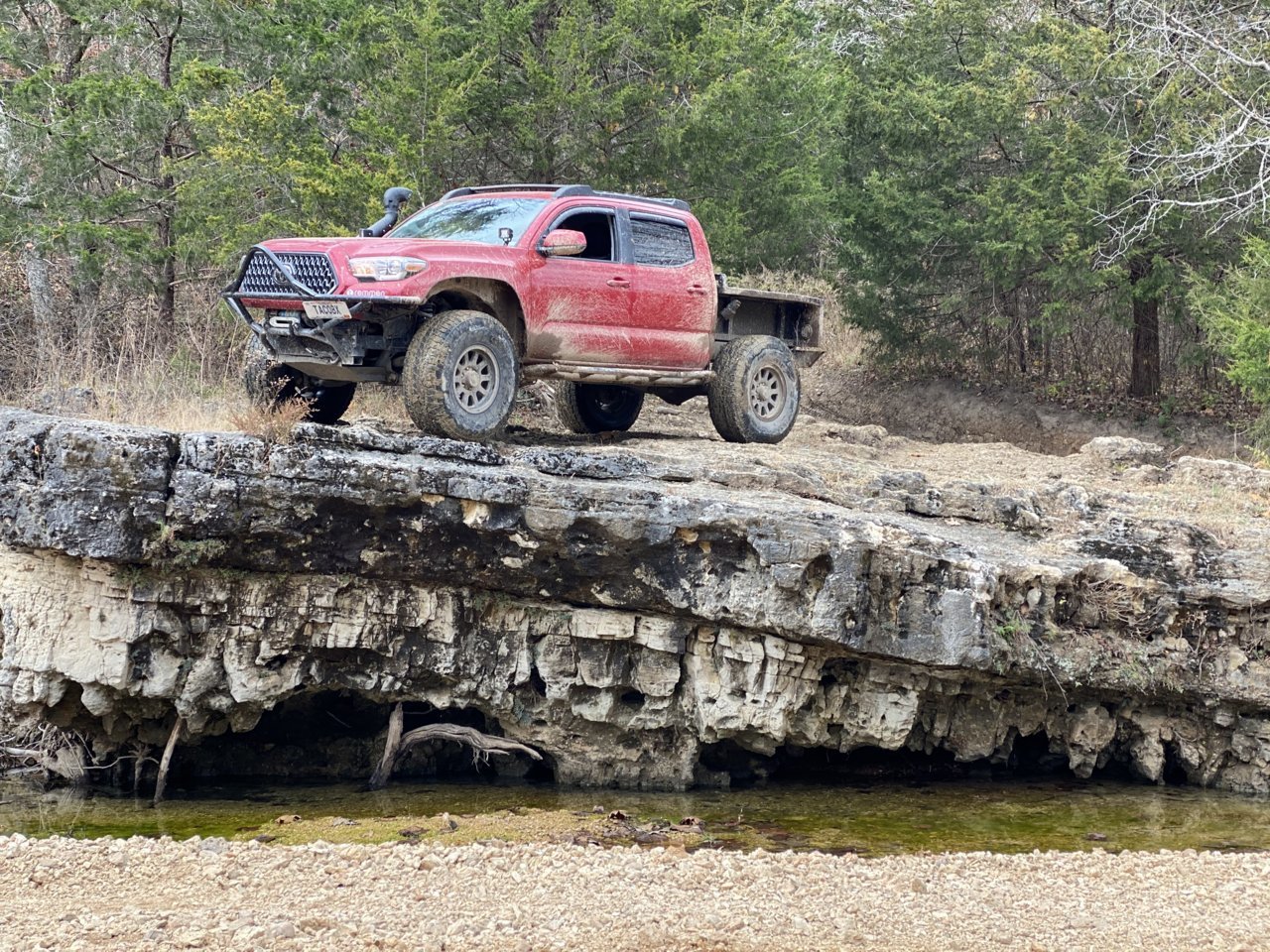

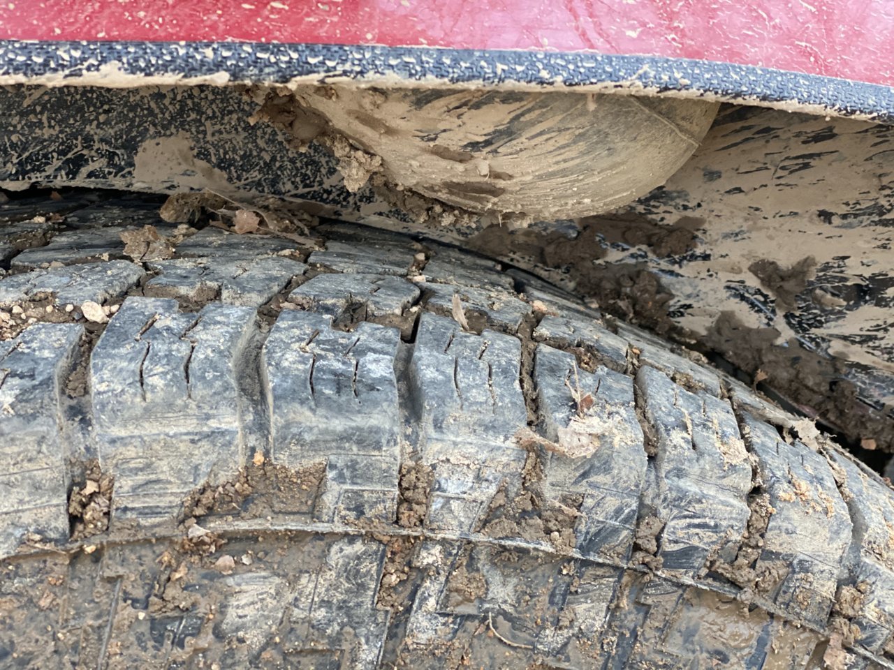

    Little update on my EXPERIENCE with 37s
    Love them .
    They rub slightly on the top of the inner fender, easy fix. Cut out and fill in with metal. Seal up and good to go. My firewall is already cut and sealed up. Cab mount- almost non existing. I’ll do a relocate, might make my own instead of spending $200 on some. Truck is far more capable, spent the weekend wheeling with jeeps on 37s-40s. Hit all the same lines they did and only had to pull line one time, not the trucks fault, laying on frame not much else I can do.
    Will I still do a sas? Yes. Will it be ungodly tall and top heavy asf? No. Lower the better, too much flex is baddd.
    Here is full stuff, on bumps, going downhill (a lot of weight is pushing the front end down)
    Will I rub more on m/ts? Yes. These tires were a last ditch effort to have some tread before this last outing. They worked fine though. 37 12.5 17 Nitto terra grapplers G2.
    The rear is a different story, without the factory bed, I rub nothing. So I have no issues but if you plan on doing 37s you may have to move/ cut/ trim some things.
    I’ll probably do a video on my YouTube channel- Tacomadad, in a week or so.
