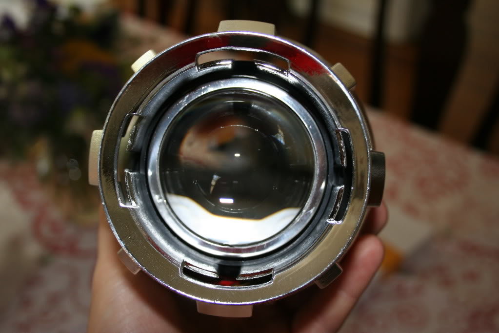

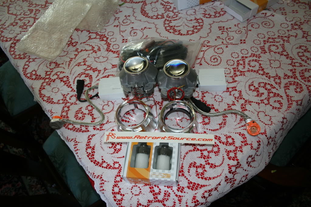

    Finish the stereo install today (I'll get pics soon). Also ordered a FX-R stage III retrofit kit from TRS in the group buy today! Super stoked to get those FX-R's on the truck!

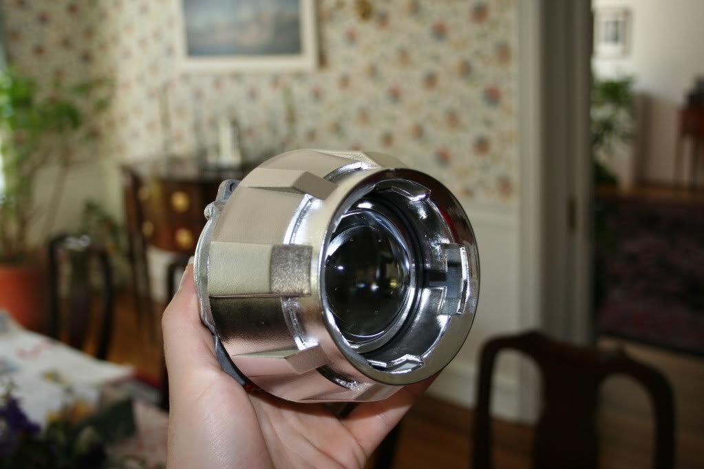

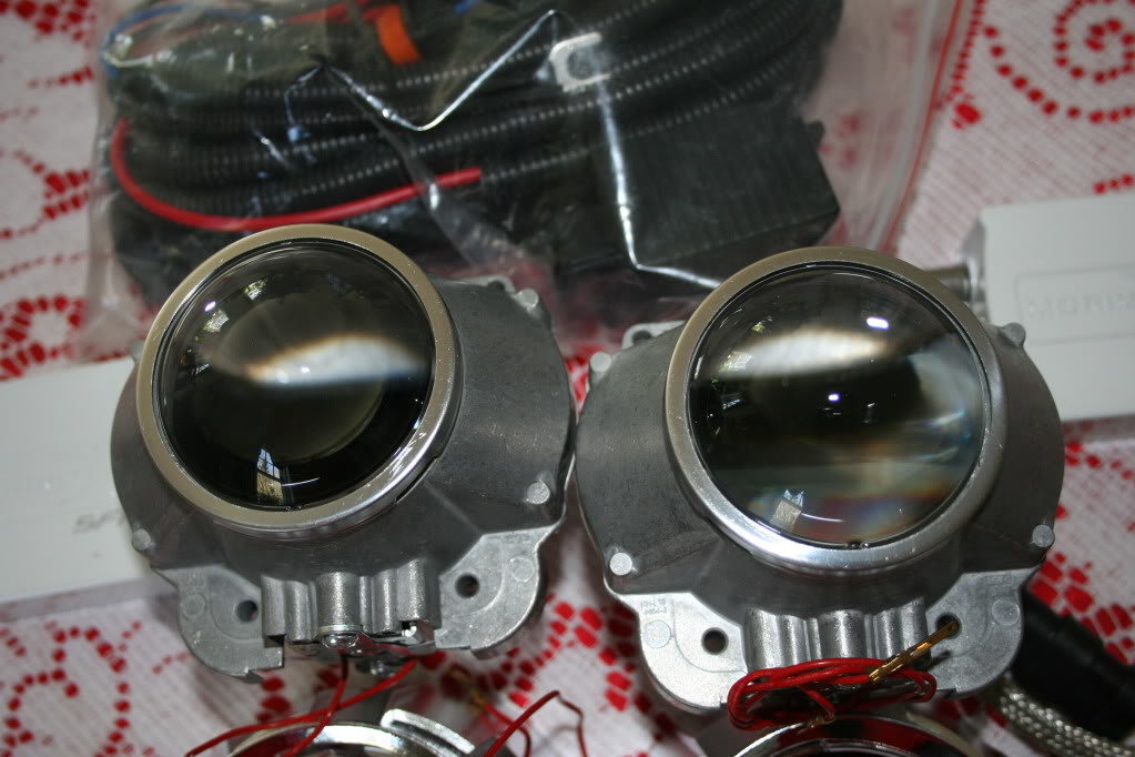

    Look what I got in the mail yesterday :D

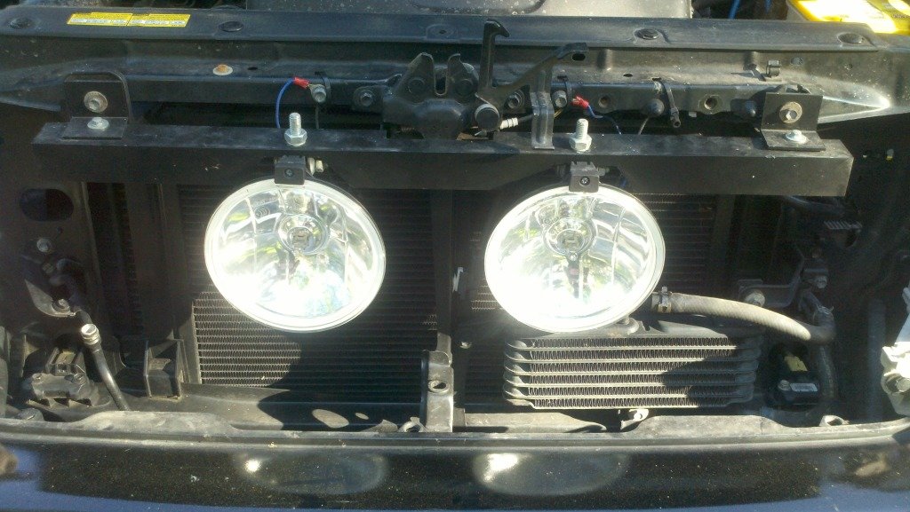

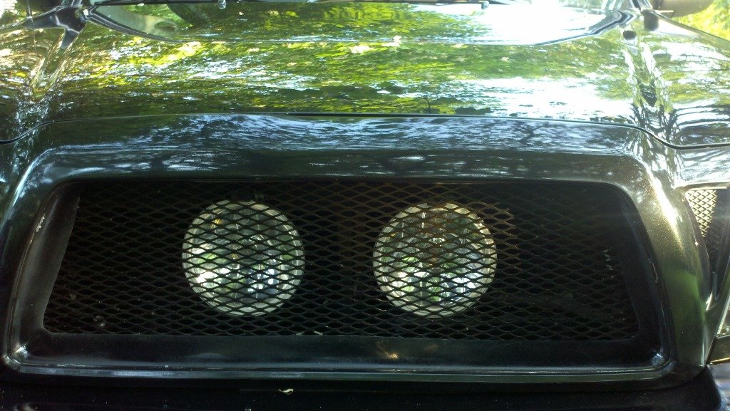

    What lights do you have behind the grille? Any pics on how you mounted them?

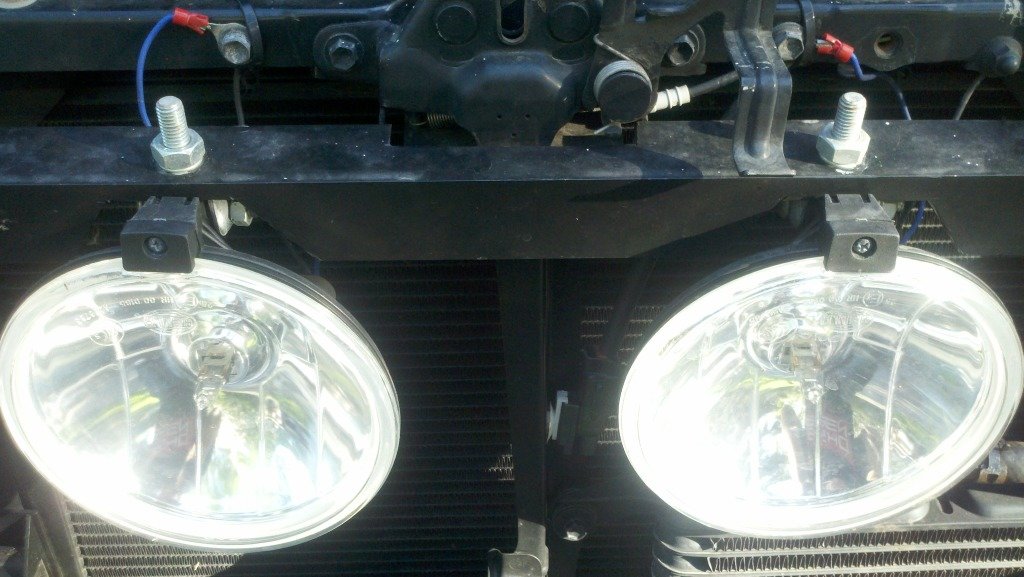

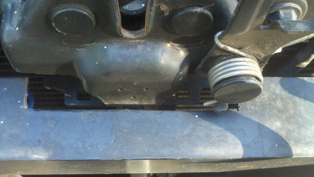

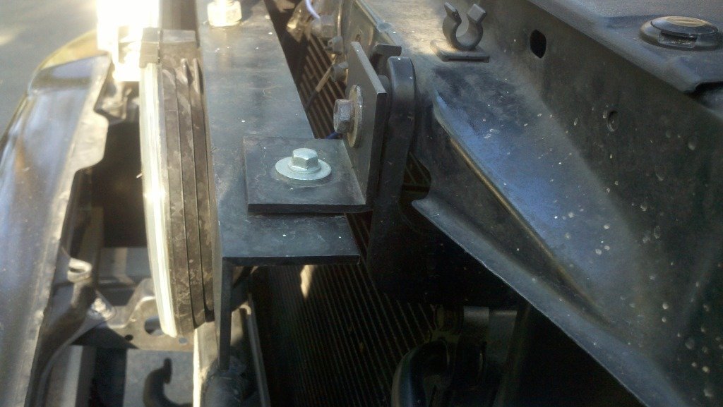

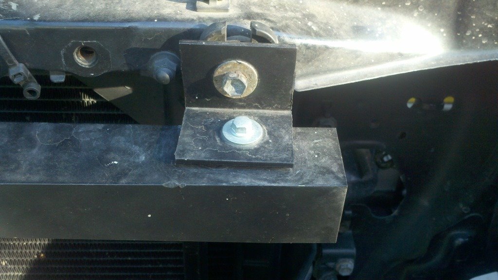

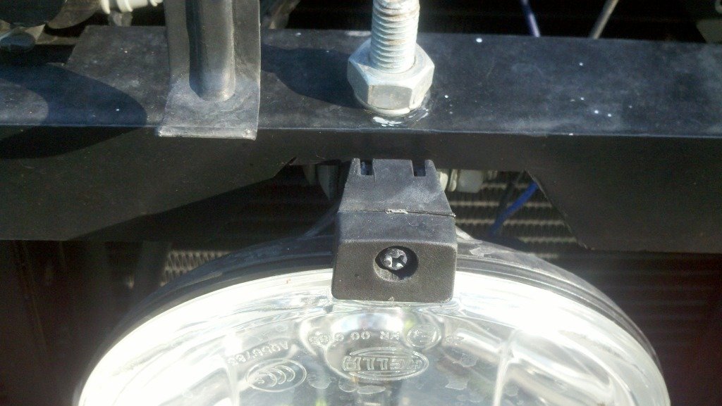

    They are Hella 500FF. What I did was took a piece of angle iron and drilled holes for attaching the angle iron on and then the lights. I'll post some pictures for you.

    Thanks man!!! That would be a huge help! I actually bought my lights today. Where did you get the angle iron? Lowes or Home Depot carry that stuff?

    Yeah, no problem. I got the angle iron at Home Depot. I forget which thickness but the thickness I got bounces around when I go over bumps. Here are some pictures of what I did:
    This link also helped me: http://www.tacomaworld.com/forum/lighting/203506-7-kragen-hid-lights-behind-grille-how.html

    3 inch lift, Debadged, 5% Tint, Custom Stereo, BHLM, Fog Light Mod, Sockmonkey Decals, OEM Bedmat, Plasti Dip Front Valence, Slims 6K HIDs (thanks goes to TheGloryFades), Hyper yellow fog lights, LED interior lights, Satoshi Grille with FJ Emblem, Pro Comp lights behind Satoshi, FatMat
    That looks great! Huge help! great pics! Thanks alot!!

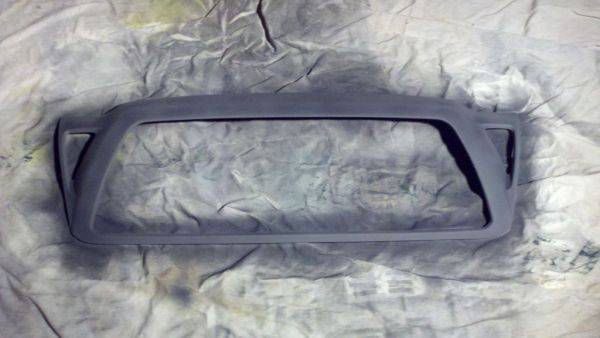

    Working on my new color matched grill this time with Dupli-color perfect match paint. Looks almost exactly the same as my OEM paint.

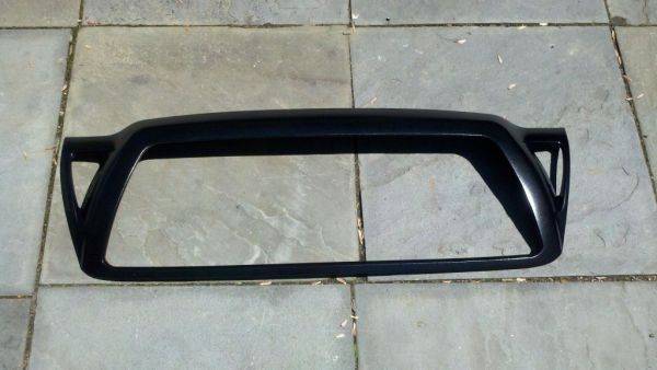

    Finally got my 2nd grill surround done!
