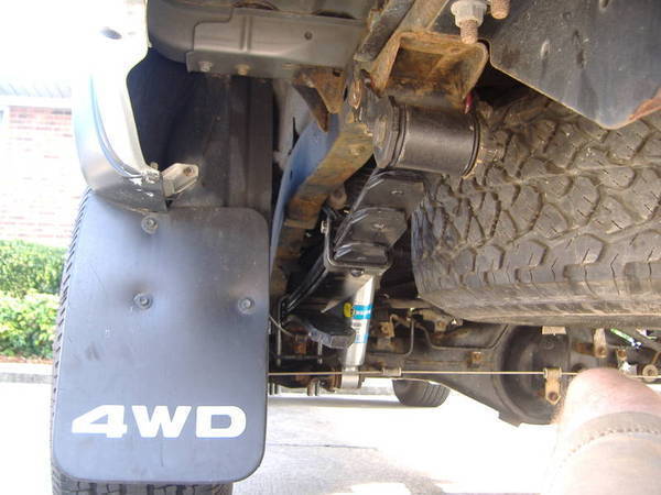

    well........got my new suspension/u-bolts, and brake lines installed today. let me tell ya now...............when parts are rusted all to hell.....things have a real tendency to be a beeotch!!!:D the driver side rear spring..........had to cut it off with a torch and grind everything to get the bolt outta there(yep....i didnt order new eye bolts like i shoulda:rolleyes:..lesson learned).........frame was on fire and all right by the gas tank too:eek:, but we had a water hose for that purpose. we did it at my buddies shop, then i had to leave for a while, so he did the brake lines and the front coils for me. all in all...took about 6 hours, because the rear rusted springs and all were a real pita!!! but anyway, got it all done. i love the way it rides now and stops(no axle wrap yet), and it gave me a bit of a lift, one that i can actually tell a difference with. dont have any pics of the carnage that was taking everything apart, but here are some pics of the finished deal.

    you really need to get rid of them flaps boy! :D

    i had thought about it, but i actually,believe it or not, like them:eek::D.

    getting there....
    with the new suspension the way it is now, it lifted the front right at 2 inches,and the rear about 1 and a quarter or so inches. ya'll shoulda seen how damn worn out and flat those rear springs were!!! damn they were flat!!!
