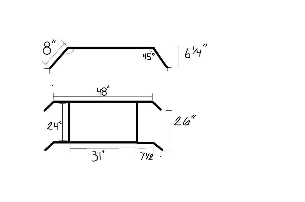

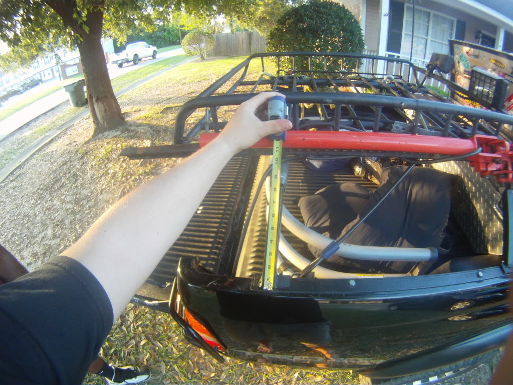

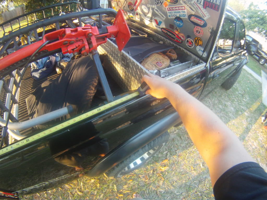

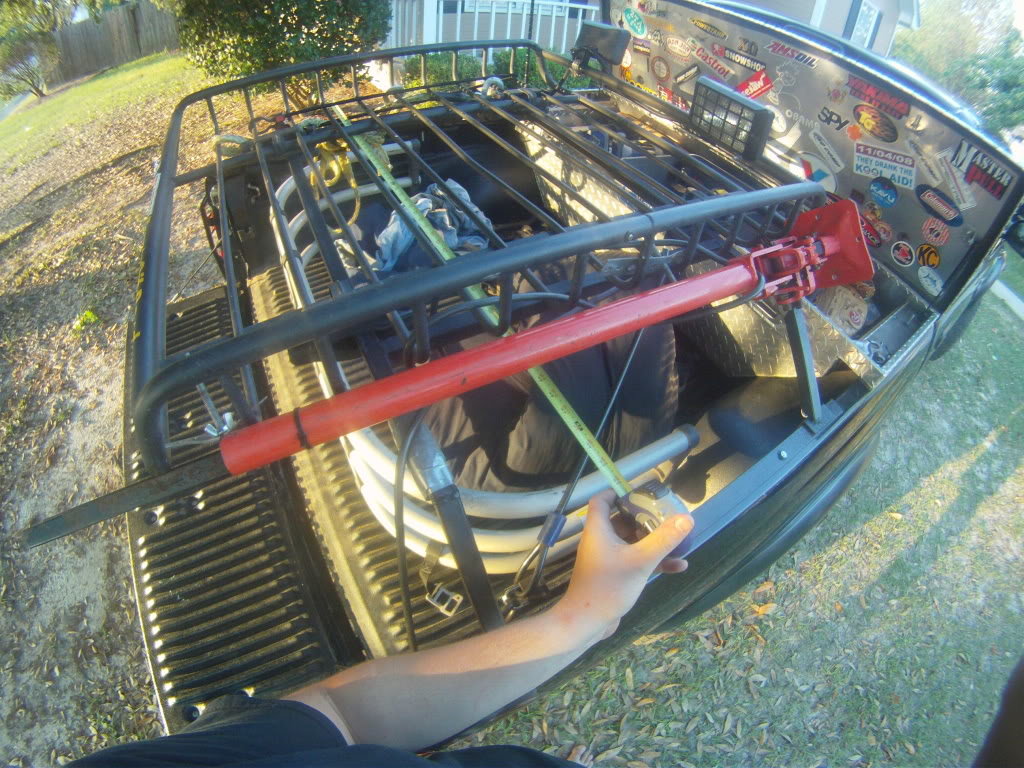

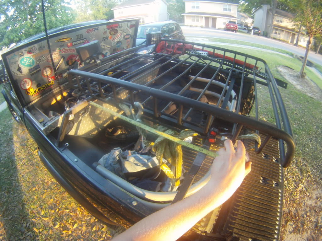

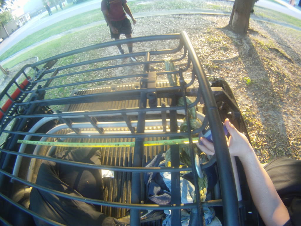

    i finally got the measurements!!!
    ill post em up in a second here...

    aaaaaand boom goes the dynamite.

    Lookin' Good, Jon.

    nice diagram, might have to go off the specs when i get around to making mine.
    just have to find a basket first

    yea i owed a good diagram to Reid. He asked me for measurements like a week or two ago and i have been forgetting ever since.
    :p
    by all means use this one. worked out great for me.

    i might make the dimensions bigger because you have a double cab and i have a extended cab so the bed is longer but its a starting point and one less thing i have to do haha

    whoa man you went above and beyond :D and i appreciate it! looks good man. i'm getting one fabbed up right now for about $90-100. it will look a little different than yours but i'm excited. hopefully will be done by the end of the week.
    quick question, do you have any security tips on anything you mount on the rack/basket? hi-lift, spare tire, etc. do you lock em down in anyway?

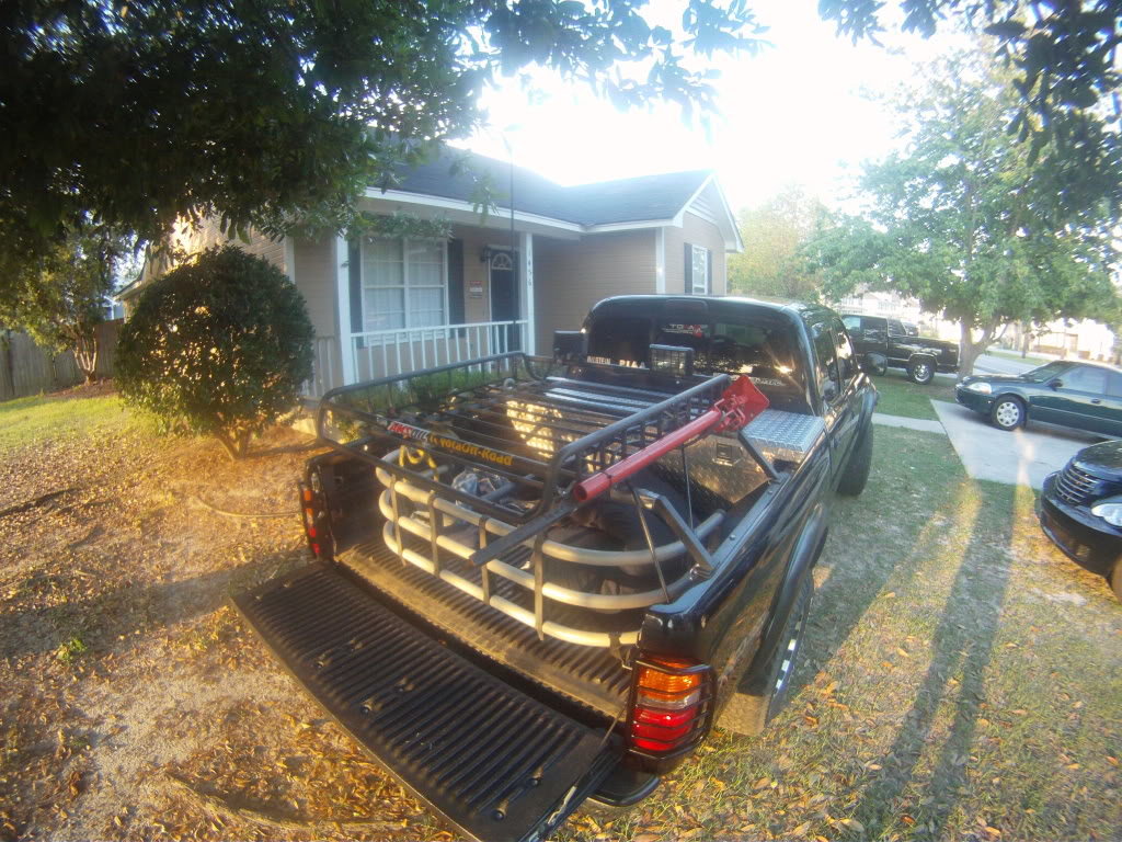

    i use a brinks cable. I threaded it through a tie down point in the truck bed. then I wrapped it through the rack and basket and then through the lower part of the handle on the hi-lift then back to meet with the other end of the cable. I used a Brinks Lock.
    its not state of the art security by any means...but you cant run off with any of the stuff without any tools.
    this picture shows it for the most part.
    and when i have my tire mounted on the basket i run the cable through the wheel as well...
