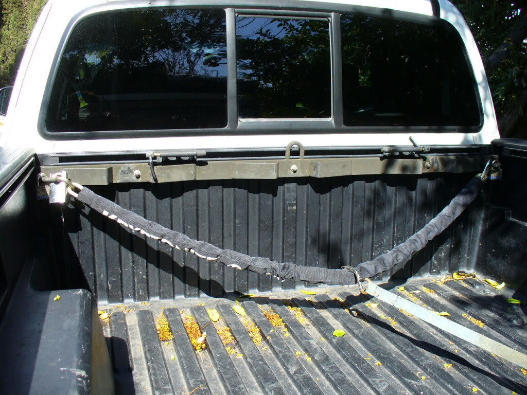

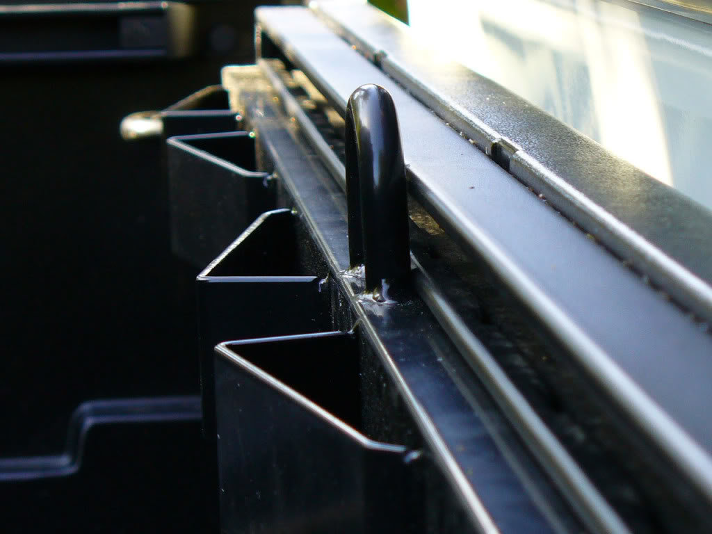

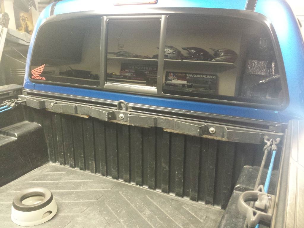

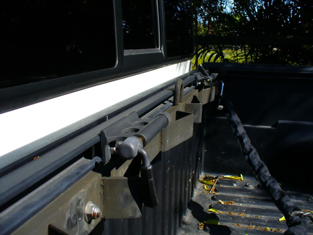

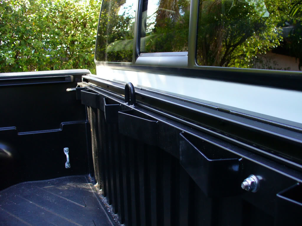

    CCR Sports BED BUDDY motorcycle tie-down bar.
    I put one in my 2005 access cab prerunner to transport two WR 450 dirt bikes. I have been using it since 2005 with no problems. I just bought a new one for my 2012 DC LB 4X4 and installed it today. The new ones dont seem as beefy as the old one, and I had to use washers to space it away from the bed so that the center tie down point would clear the factory tie-down rail. The old one had this center tie-down loop welded at the very edge (towards tail gate) and fit just fine up against the factory rail; the new one was welded closer to center, so I had to space it back.
    In the pics below, the old one is faded.
    This works great for hauling 1-3 motorcycles; I have had two full size 450 dirt bikes and a mini 110 once, but usually just the two 450's.
    Jesse
    Click for full-size image (1024 x 768)
