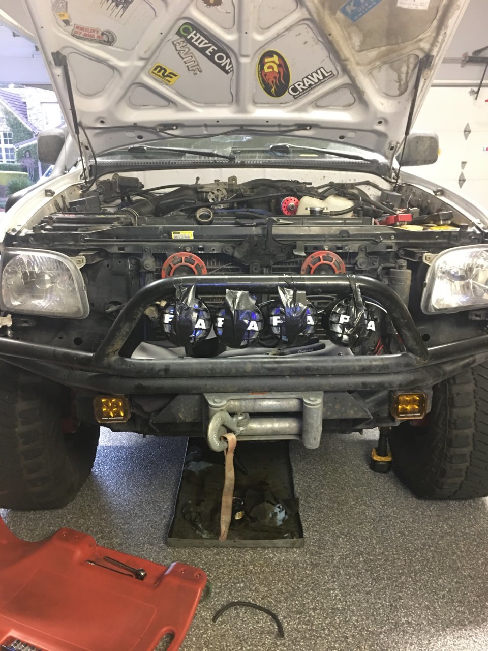

    Mounted some new lights for the lakebed :D

    Dude, be careful with those. I had 4 of those on my truck and if they aren't aimed properly you could blind someone.

    Oh I know! Once I finish getting the tabs glued on I’ll align the beams where they should be

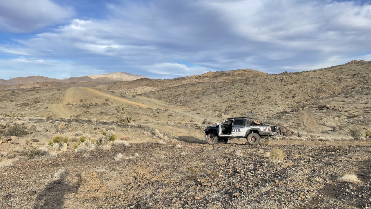

    Had a ball joint failure at race mile 38 on day 1 of prerunning. Actually destroyed both upper ball joints waited for parts to arrive from Escondido and then went out to repair it that night since it was sitting on course and the following day was a hot race of trophy trucks.
    you can see the hi lift holding the truck up. It was a cold hammers this year had to build a fire at 2 in the afternoon to keep warm and wait on support trucks.

    You blew up two EMF joints? Were they not tight or something?

    They were tight. They were installed in august, re checked after a couple hundred miles and added torque check to them. Never had an issue until we ran 38 miles at KOH at race pace. Shit happens and we will improve the design for race purposes.
    After installing 2 new EMF joints never had another issue. Could have been my installation or timing or faulty joints. Regardless the new set saw another 100 miles on the lakebed without issue.
    I add cross check torque seal to every bolt and connection the bolt still had the cross check on it and the ball joint sheared where the threads meet the shank

    Yikes, glad that didn't result in a worse situation!

    No doubt. Ran for 8 days after the failure without a single other issue. She mobs across 3’ whoops at 55-60 like a champ. If you guys are on the fence of fox versus king I highly recommend the fox setup Shane put together for these kits
