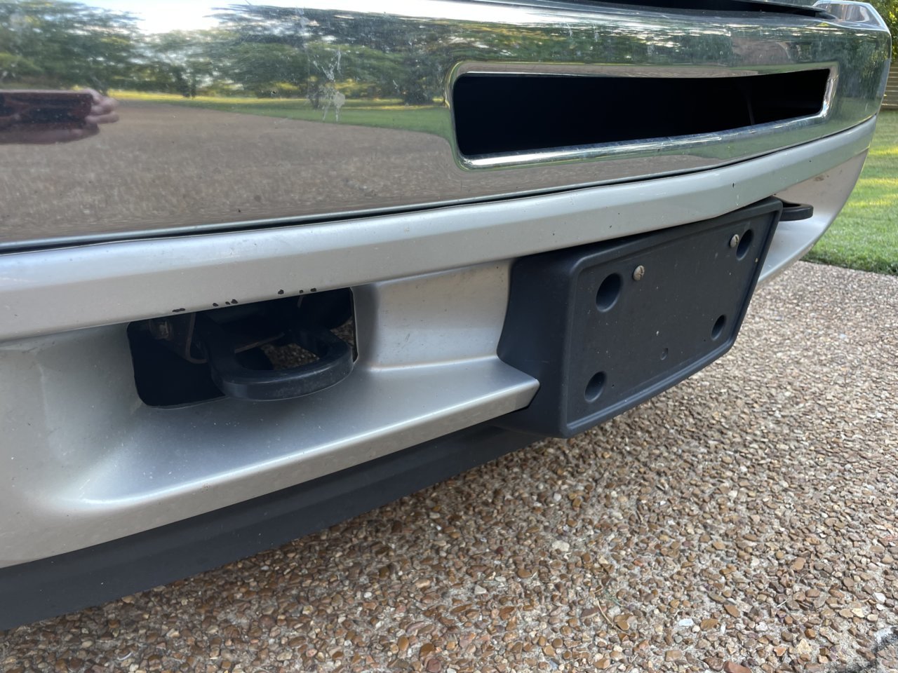

    Buying a new Tacoma and wondering about securing ropes below front bumper. I had hooks installed below the bumper of my Chevy Silverado. Ropes from canoes extend over the hood to these hooks.
    Looking at images of Tacomas on line and not seeing many using front tie-down ropes.
    Anyone have hooks added or do you just tie down where you can???
    Any paddlers out there? Thanks.

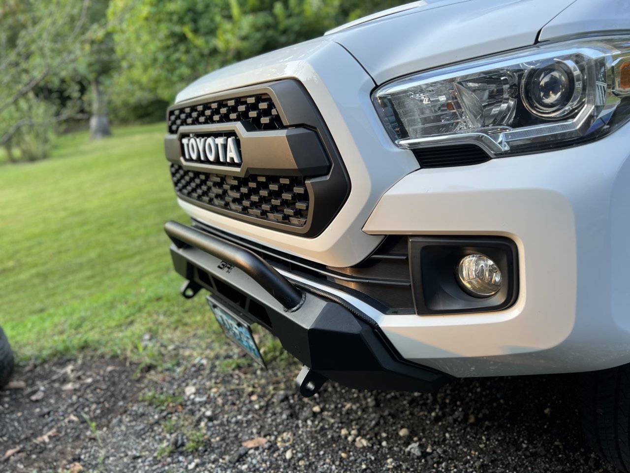

    Nothing $550 can’t fix…body armour highline bumper.

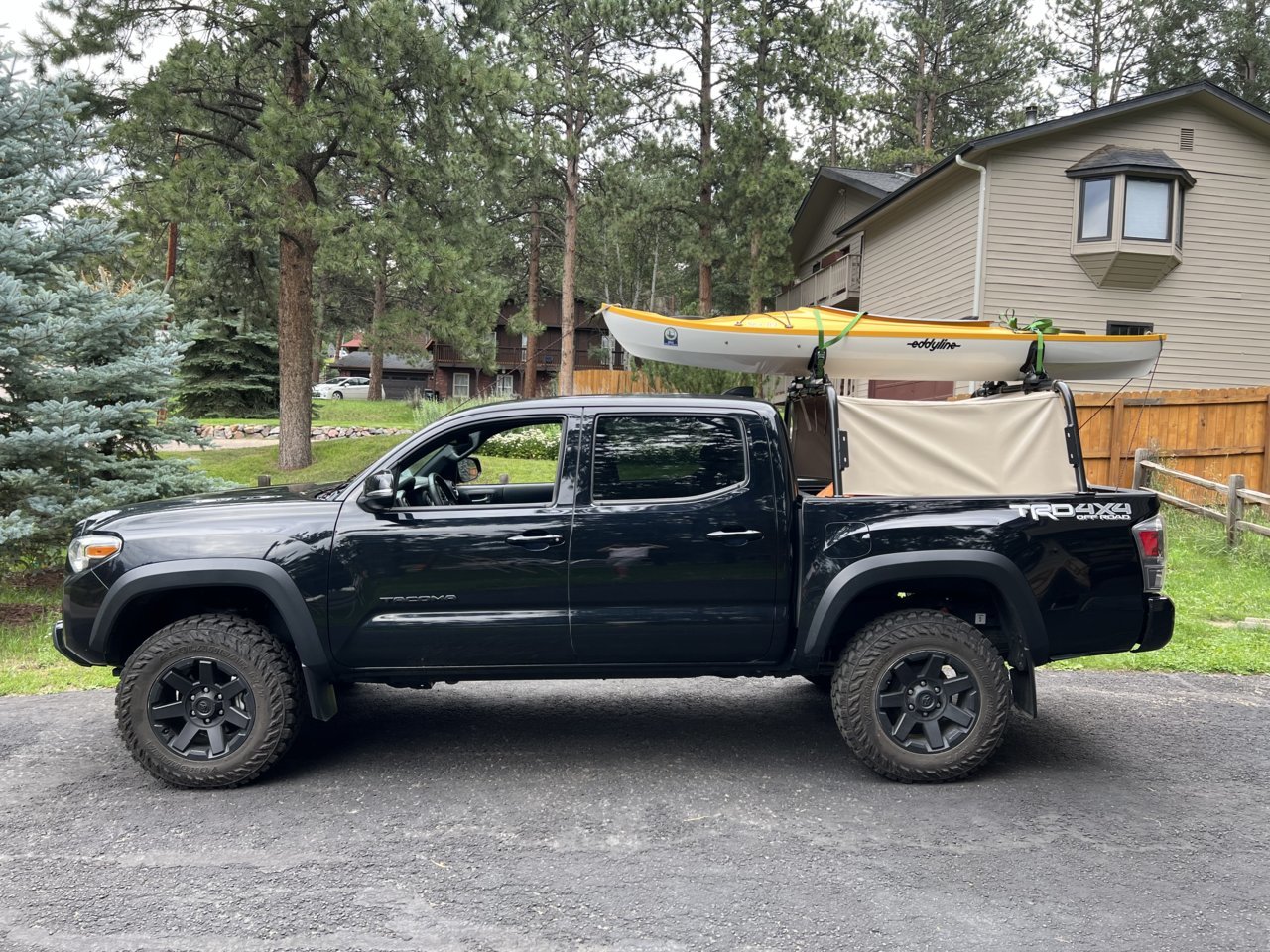

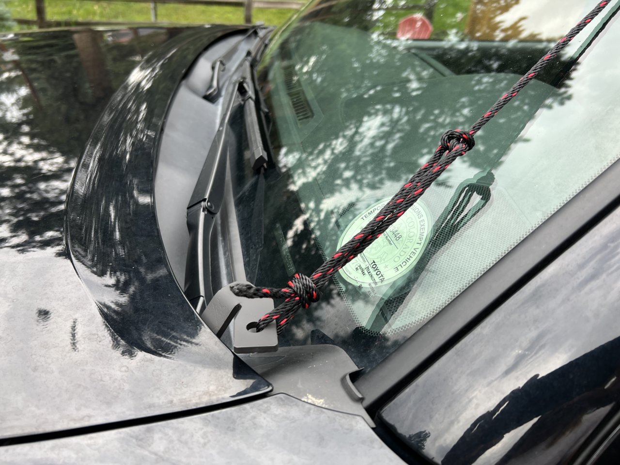

    Ditch light brackets are an option for tie downs. Using bow and stern lines makes me feel better when driving on the highway, especially when it’s windy.

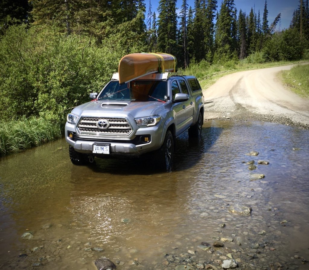

    Diy Hood loops here: keeps everything secure and gives me a visual on how the boat is doing. Made from some straps I had laying around and ten cents worth of electrical tape. Loop it, tape it, drill it, then put the fender screw through it.

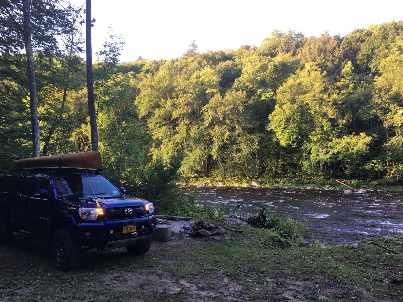

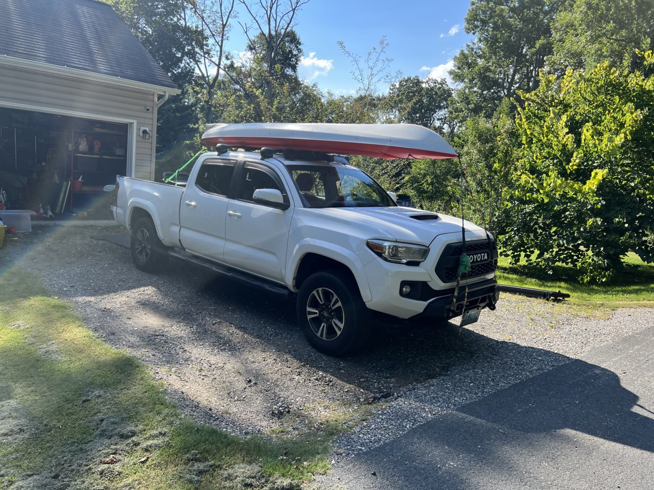

    simple webbing strap from the top of the radiator support, can even leave it under the hood when not using it.
    Can be seen just above the passenger side driving light.
