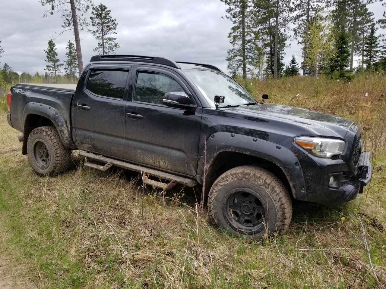

    Black. Here's a shameless attempt at attention:

    Nice looking truck. I'll keep and eye out. Also... Noticed that you had posted pics of a Joying unit. Did you swap in a different head unit?
