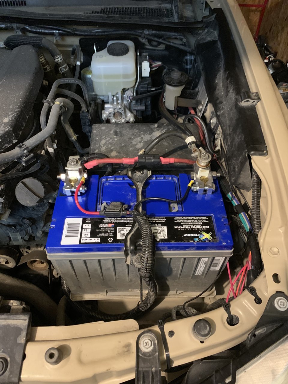

    I got the battery today, installed it. was having trouble with getting the brackets right hook to go low enough, ended up having to remove the stock tray. Is it gonna F up the paint of the wheel well without the tray? I need a bigger tray. found this https://www.amazon.com/Toyota-Genuine-74431-0C020-Battery-Tray/dp/B00FZSDHGG but seems like a lot of money for just a piece of plastic. When I google it i find a bunch of other unrelated car battery stuff. Whats funny is the top result is a guy on tacomaworld asking for one.
    I also seem to have more stuff connected to it than I realized and I really gotta get an AUX fuse box hah.
    So for my fridge I run a wire straight from the battery to a fuse box under my drivers seat, which has a 12v socket wired to it, thats how I wire the fridge. I have been wondering if part of my issue before was maybe I didn't use thick enough gauge wire to wire the fuse box. don't remember what I used, I think I just bought the thickest I could find at walmart.
    Ill probably do a test run and run the fridge over night and see how it lasts. Just a little worried about that wire, if its thick enough gauge.

    I’ve got the tray in mine, it’s just a big piece of plastic. I’ve seen some people have just cut off the ridge on the side and used the stock one. The tie down is a little snug but shouldn’t be too much of an issue.
    I’ve got the arb fridge wire kit, it’s 10 gauge. 10 or 12 is typically best for a fridge.

    Pretty sure I used 10 gauge looking at it this weekend. Goes from the battery to a fuse box under my driver's seat.
