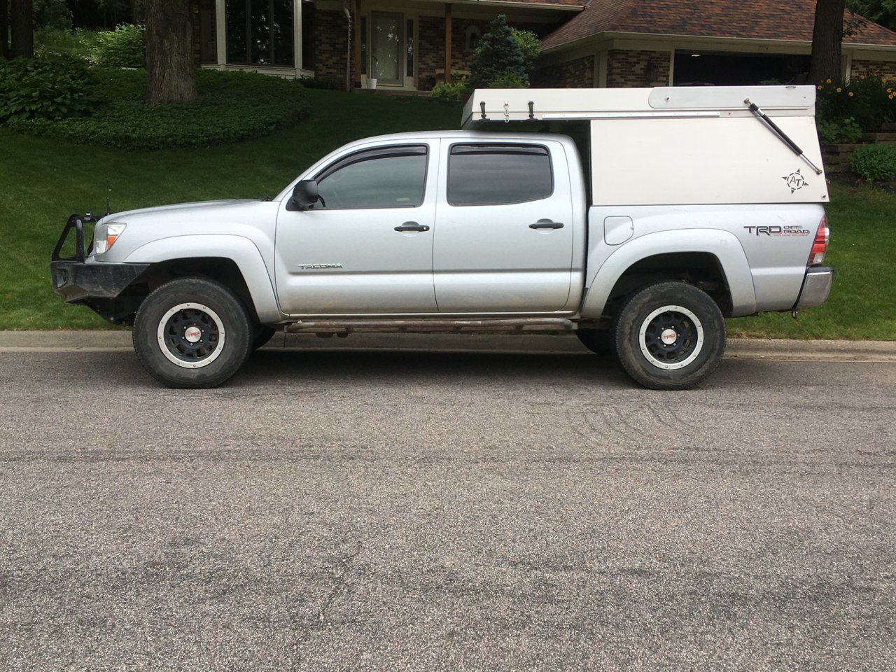

    I have the 6112/5160 set in my truck, specifically the TX Baja (650lb/in springs). I was running them with the wheelers progressive add-a-leaf pack on brand new TSB leafs and timbrens for backup. All in about a 1.75” lift. Things were fine without a full load-out for camping. I would be on the Timbrens with gear.
    Added the ARB and 10k winch with synthetic rope, front sagged about .5”, so 1.25” over stock.
    I then upgraded to the OME rear packs with first overload flipped, with Timbren in reserve when I headed out west to get the Hab. Was about to limits of those springs with the Hab and loadout. Added the extra leaf to the pack and all was well.
    Next I pulled the extra leaf and added bags.. oh so nice, but have a slight rake with noting but the Hab and fridge, so maybe 350lbs. Rear bumper will be here in a couple weeks, so the extra leaf is going back in.
    Also got a set of the 6112 spring spacers to give the nose about 1” more lift. To level out the front and keep me from banging my stock skids on the trails.
    With all the changes I have zero complaints with the shocks, just that the nose dipped a bit more than I wanted with the ARB and winch.
    The 650lb front springs were nice to have and gave the truck a less plush ride than the 600s or even OME. With tires aired down the set eats washboards like a champ with minimal overheating... what they were developed for.

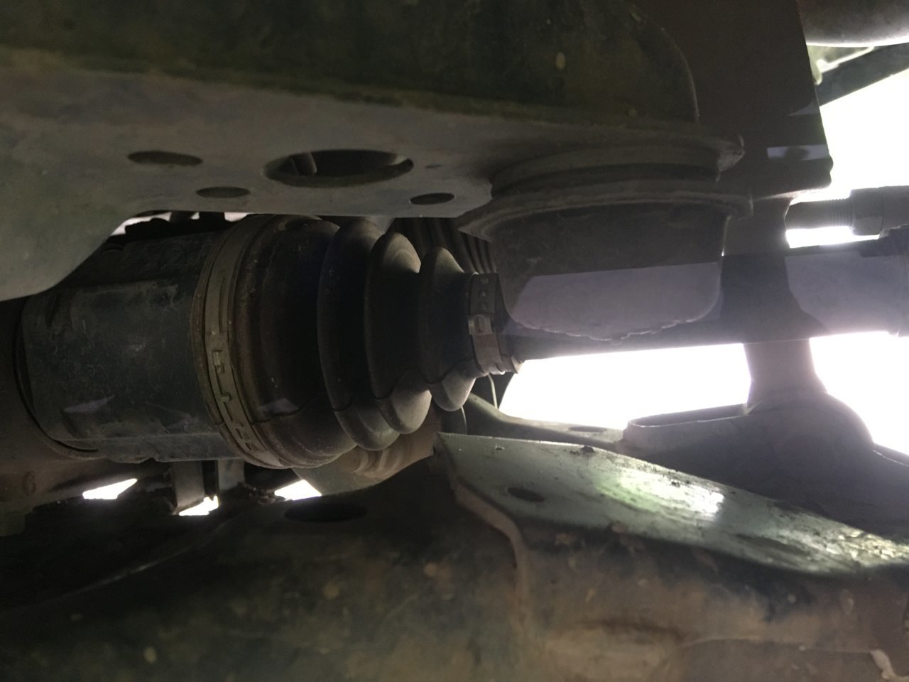

    If you get the set, grab the TX pro bumpstops. They allow for more front range of motion. (Toyota PN 48304-04090)

    I've had my OME kit for a few months and I have been loving it. Do those bump stops work for any strut or just the 6112?

    They do.
    Here is how it’s sitting now.

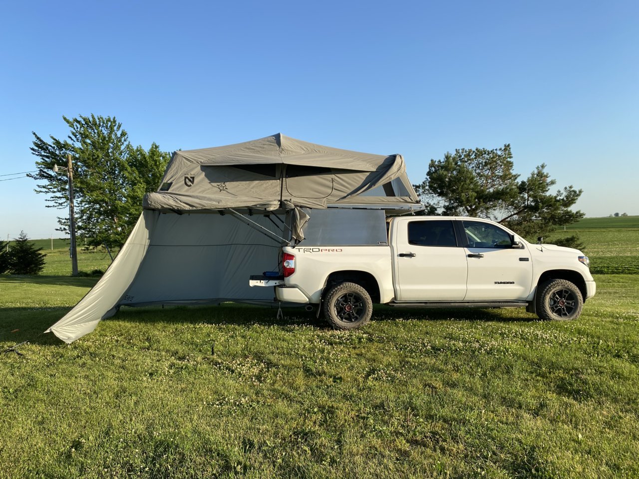

  20. Jun 20, 2020 at 10:23 AM
    #2520
    Shellshock
    Nov 21, 2015
    #170338
    23,428
    Iowa
    I got mine may 2019 after a nightmare with a trailer experiment. The habitat has been awesome and what I should have got from the start. I just got their habitat room a week or so ago
    Edit:I can’t pm you because of your privacy settings
