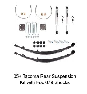

    Thanks for the info all good things to know for sure! I am going with a 3" lift, I got on wheelers memorial day sale (05+ Tacoma Rear Suspension Kit with Fox 679 Shocks). Still need to get the front coilovers.

    Following up on OG post on the lift kit. I bought the 05+ Tacoma rear suspension kit w/ Fox 679 shocks I upgraded to the expedition leaf packs from wheelers. I am looking for some input front shocks and coils that wont break the ole bank. Thanks!

    I've never heard a good reason to not buy 4 matching shocks.
    FYI: I'm not at all clear what you mean by "05+ Tacoma rear suspension kit w/ Fox 679 shocks". There are many different 05+ Tacoma rear suspension kits for sale out there.
    Also if by "Fox 679 shocks" you mean these, I don't think they fit your truck.
    https://www.4wheelparts.com/p/fox-2...body-ifp-shock-980-24-679/_/R-BKTK-980-24-679
  20. Jun 7, 2023 at 1:42 PM

    im guessing its a typo from the website or a legacy part number the picture here looks correct and like a 2.0 shock for a tacoma. Same one I had on my truck.
