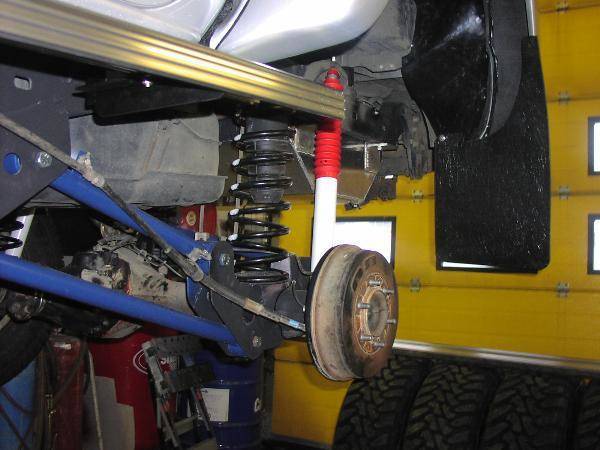

    It has a 4-link system in the back, extra fuel tank it´s 35 gallons and a fulepump so you can fill the orgina tank while driving, it has a 4:88 and a front air lock, it has ranco 9000 shocs in the back and 3" light racing struts in the front, Artick trucks tires 38"x15,5" we had to change the brake system and use brake pumps from landcruser 80 and the brakedisk is built by artick trucks in Iceland ,we did this so we could use 15"x14" wheels for better flote on the snow when you let the air out, It has a lift kit about 2" only on the boddy and then the flairs and running bords,2x air pumps one for the tires and one fore the locker, KN filter, fluricent lights under the car and some lights in the front. inside is the GPS, VHF, CB, and NMT phone and I can´t remember anything else
    here is the 4-link system and in the back you cab see the extra fuel tank it´s 35 gallons and a fulepump so you can fill the tank while driving, it has a 4:88 and a front air lock, it has ranco 9000 shocs in the back and 3" light racing struts in the front, Artick trucks tires 38"x15,5" we had to change the brake system and use brake pumps from landcruser 80 and the brakedisk is built by artick trucks in Iceland ,we did this so we could use 15"x15" wheels for better flote on the snow when you let the air out :) It has a lift kit about 2" only on the boddy and then the flairs and running bords,2x air pump one for the tires and one fore the locker, KN filter, fluricent lights under the car and some lights in the front. inside is the GPS, VHF, CB, and NMT phone and I can´t remember anything else :D

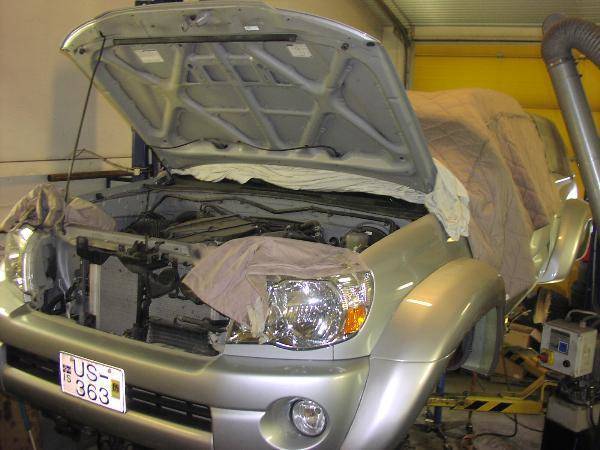

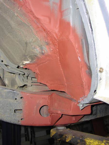

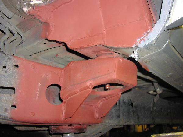

    We had to move the boddy-bracket back and up
    and cut out part of the floor and weld some plate instead
    just a pic

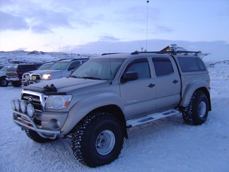

    which camper shell is that?

    Now that is how you make room for big tires....
    To everyone that says it can't be done........
