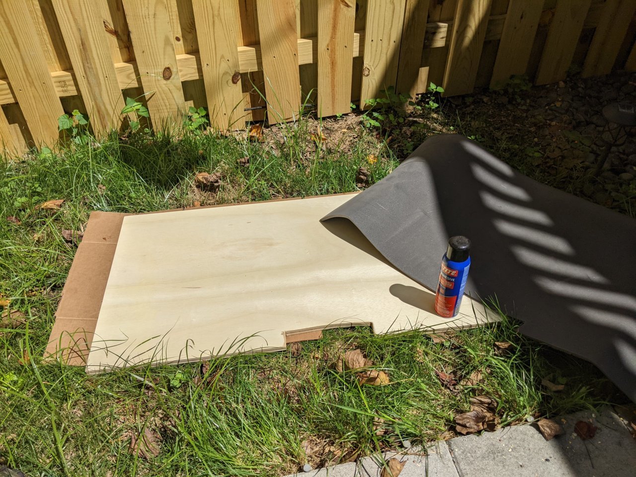

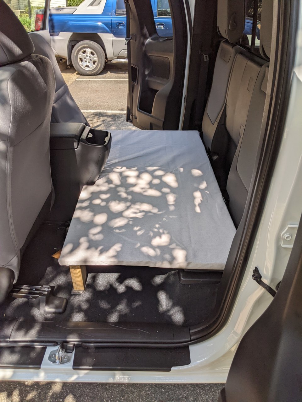

    That's my baby Ella, she weighs 100 pounds and is very leggy. The back of the Access cab is big enough for her to sack out and move around, but not more than that. She just sleeps on long drives though so it's fine.
    I adhered 3/8" high density poly foam top and bottom (where it rests on the storage compartments) and stapled plastic-backed canvas on it. Plus legs with foam on the feet to protect the rug. Not as fancy as some, but very sturdy for the drive home. I drove 300 miles to pick up the truck so I was working out of my daughter's condo instead of my workshop. Like her mom she's still fully equipped for projects, though.

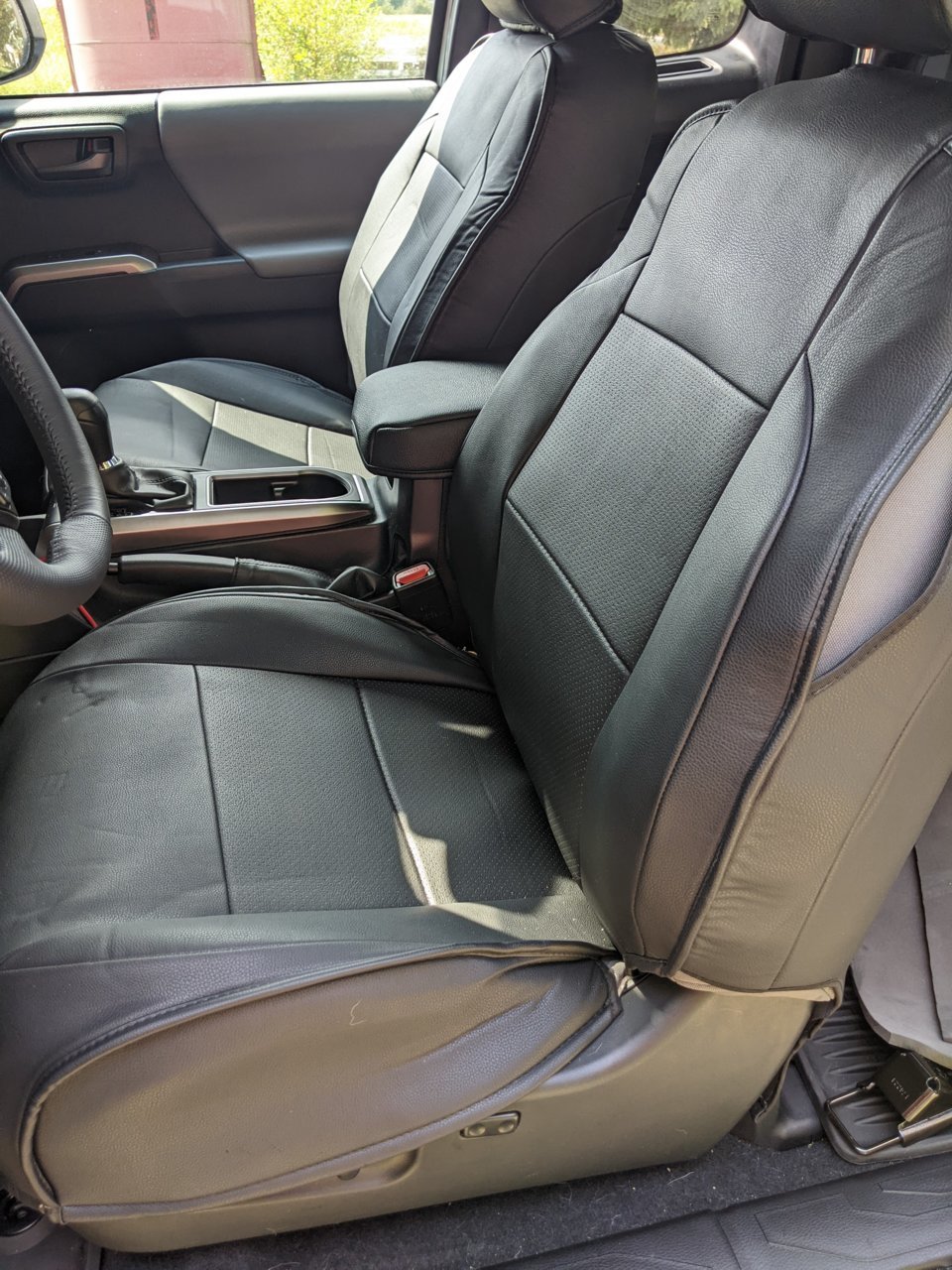

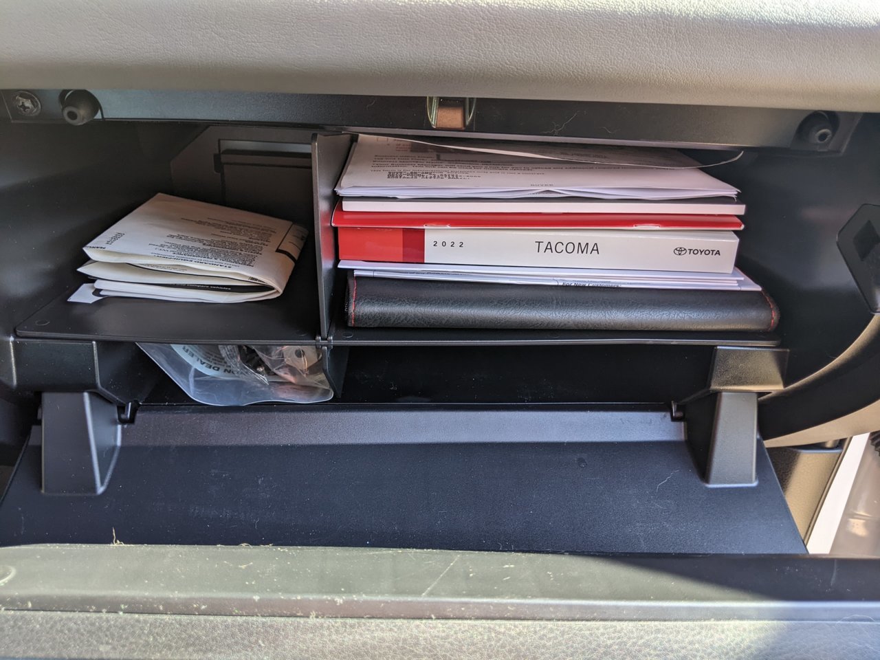

    A couple of minor upgrades: the glove box organizer and some fake leather seat covers that I freaking *love*. Also a cover for the center console because dog claws. Running boards arrived yesterday with the wrong brackets, so that waits for next week.

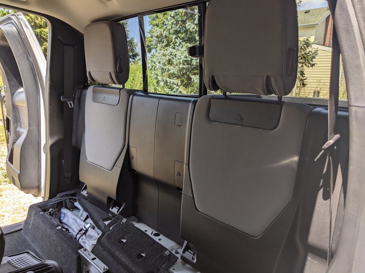

    Catherine
    2022 4WD 6 cyl SR5

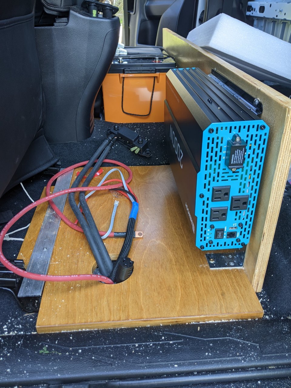

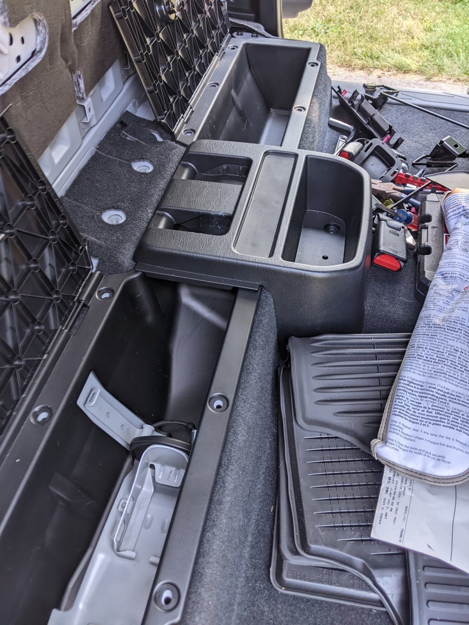

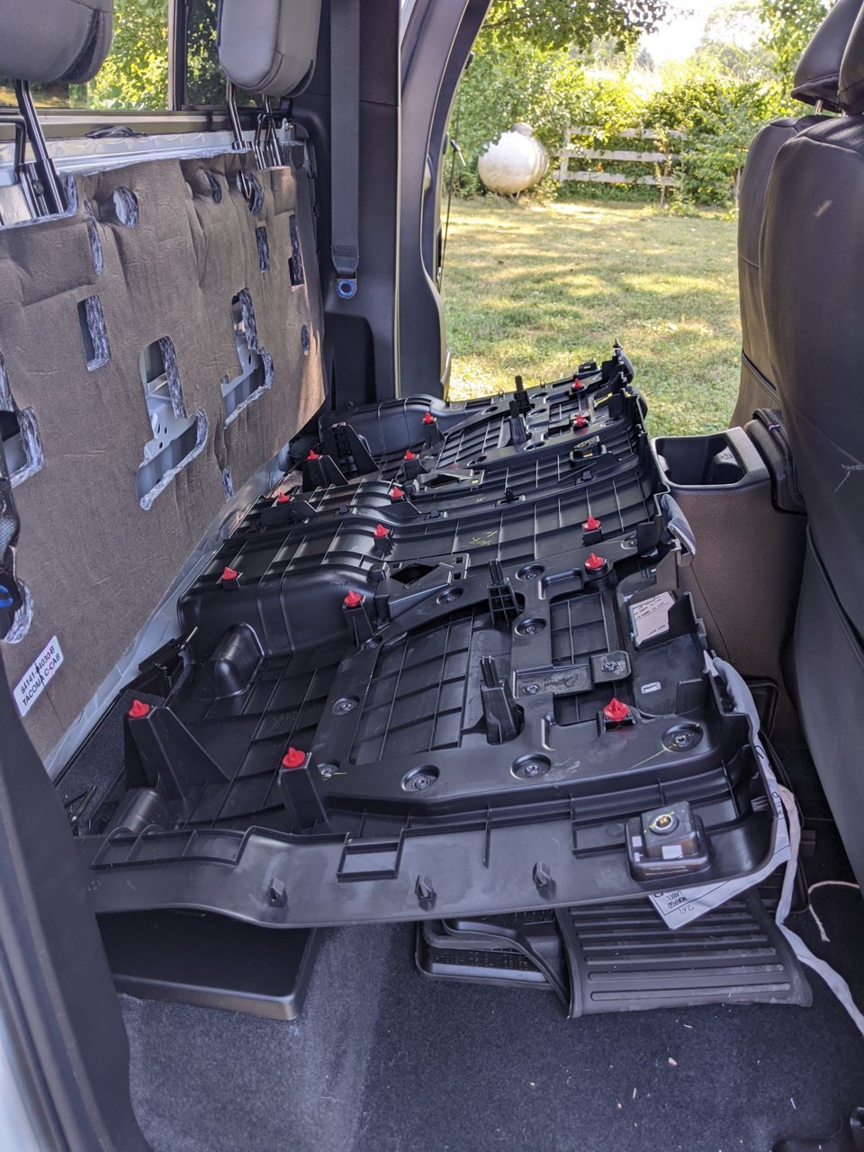

    The house electrical system I'm putting together is significant, build around a 250 amp hour lithium battery with a 200 amp BMS. The components will go in the back of the access cab, and I will run a 110 volt 12 ga line as well as 12 volt power back to the bed, to keep living and storage space to the max. There will be a remote shut off switch for the inverter back there, and the 12 volt switch panel.
    Charging for now is via the alternator and a shore power charger, but my dc-dc charge controller can also handle solar if I add panels later.

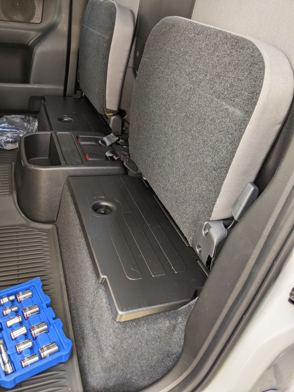

    So today I made room for the system by taking out the storage units and center console. I took out the back panel first but now I think I could have skipped that step. Reassembled, minus the bins and console.

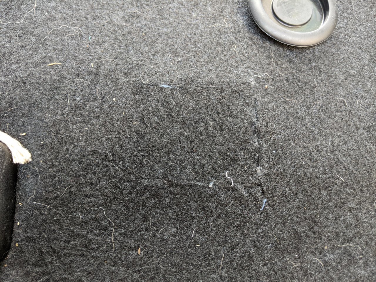

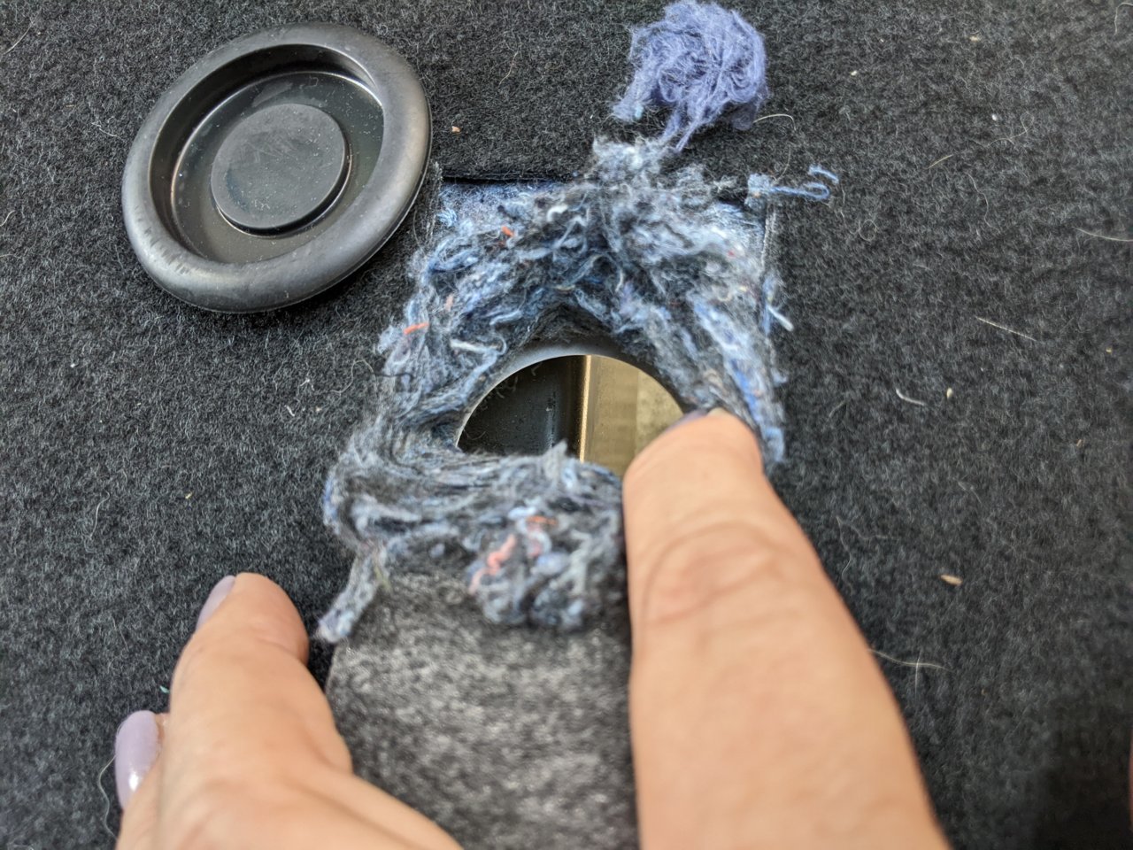

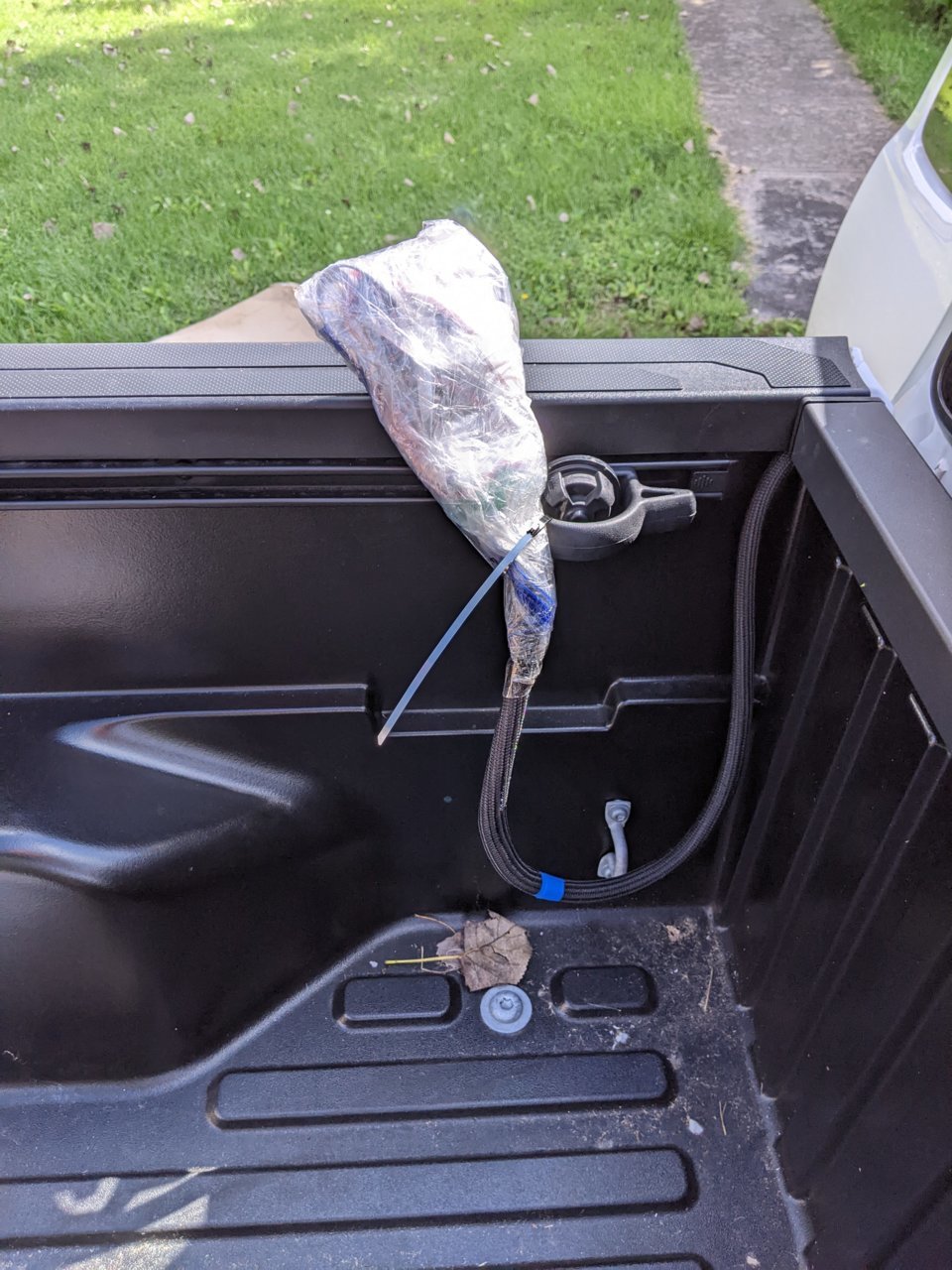

    I need to run some wires into and out of the cab, and fortunately there are plenty of access holes. This one is perfectly positioned, and I was able to open it up with a flap that closes undetectably.

    It is LiFePO4, and its monstrous. Over 70 pounds, and 20" long x10x10", exactly the width of one of the rear access cab footwells - thank goodnes since I didn't think to check before I bought it. It's 250 ah actually. So much overkill but the price was under $900. I figure I can run a small AC unit enough to cool the rig down on terrible days. Don't know if I will but I'll certainly have power to spare. For grins today I hooked it to the inverter and ran a high power blowdrier for a while.
    I'm in the process of securing plywood bases to the floors using existing threaded holes, then I'll lay out and secure the components and then run wires last. I'll post some pics along the way. The whole system will raise up my dog platform by about 10", and I will still be able to store the jack, a bag of tools, jump starter and other miscellaneous stuff down there too. Thanks for following my progress!

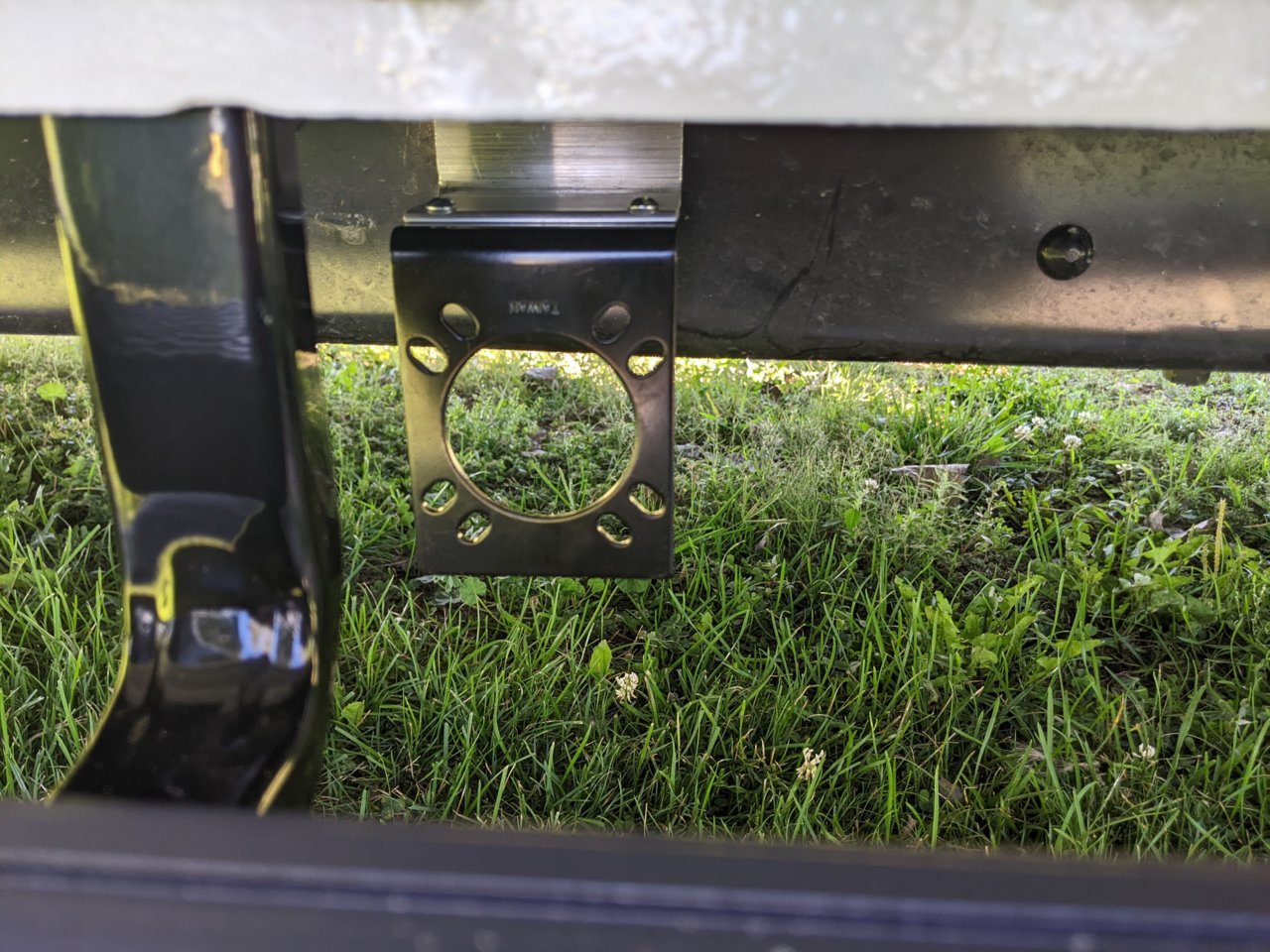

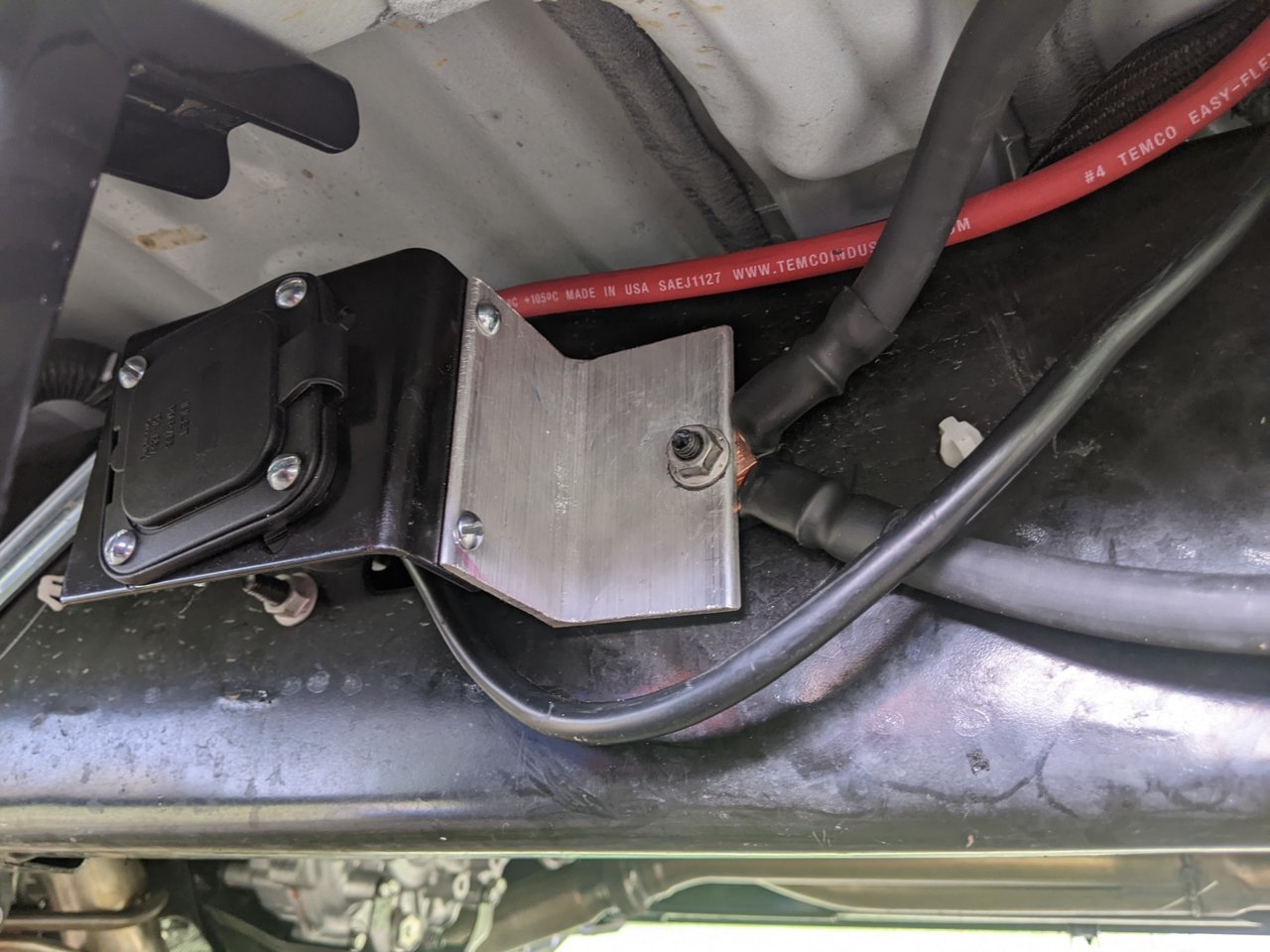

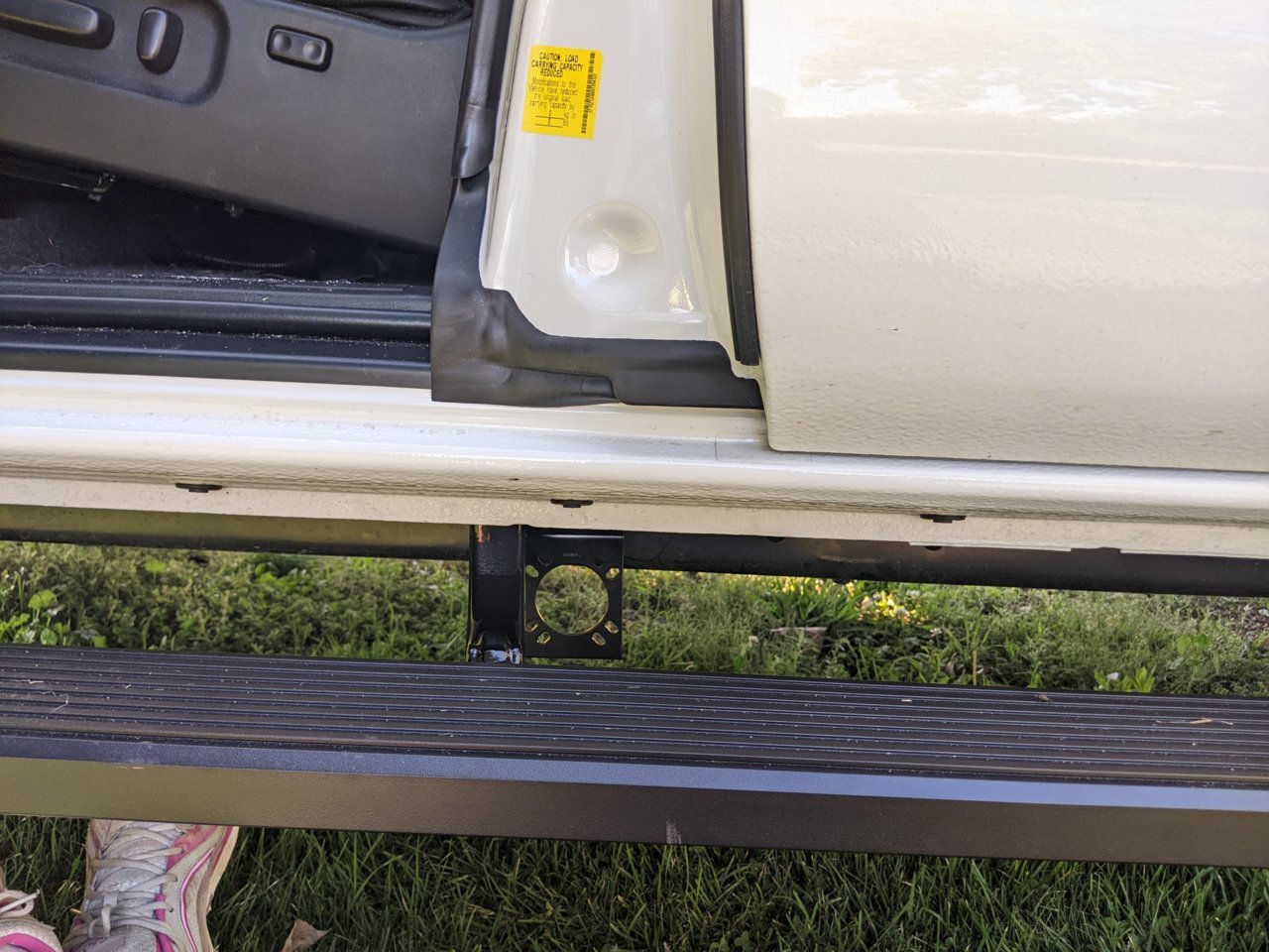

    Catherine
    2022 4WD 6 cyl SR5

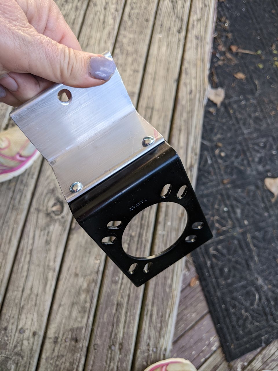

    Had to build a bracket to mount the shore power plug. I used an existing bolt in the frame. Looks pretty legit there I think.

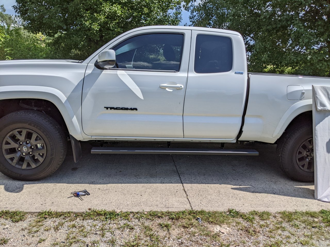

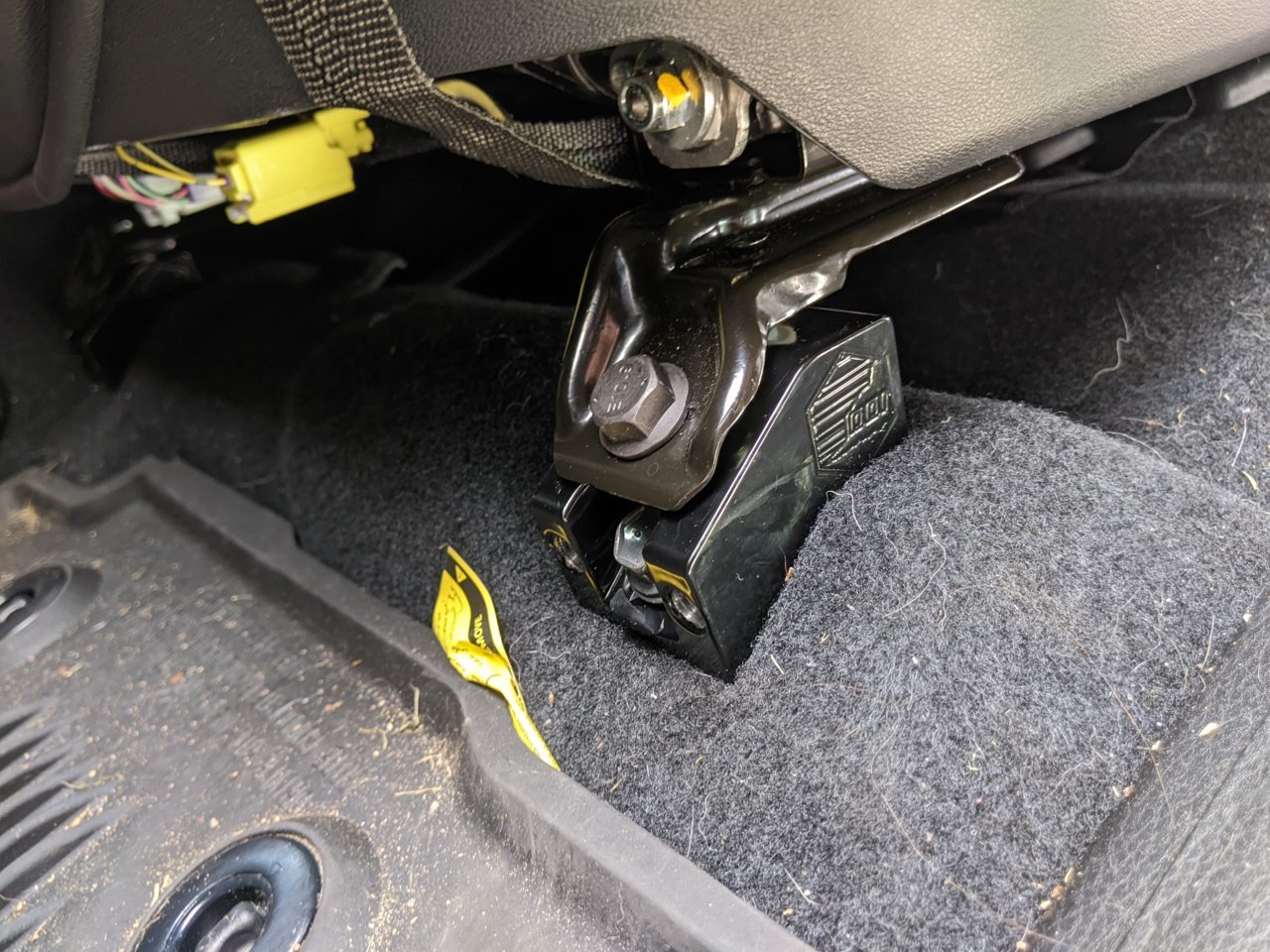

    Gratuitous picture of Ella who likes to sit in the truck in the driveway, just like I do. I added ABS 5" aluminum running boards, Deset Does it seat risers, and pretty black overlays for my badges.

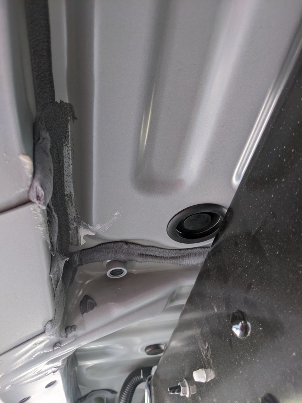

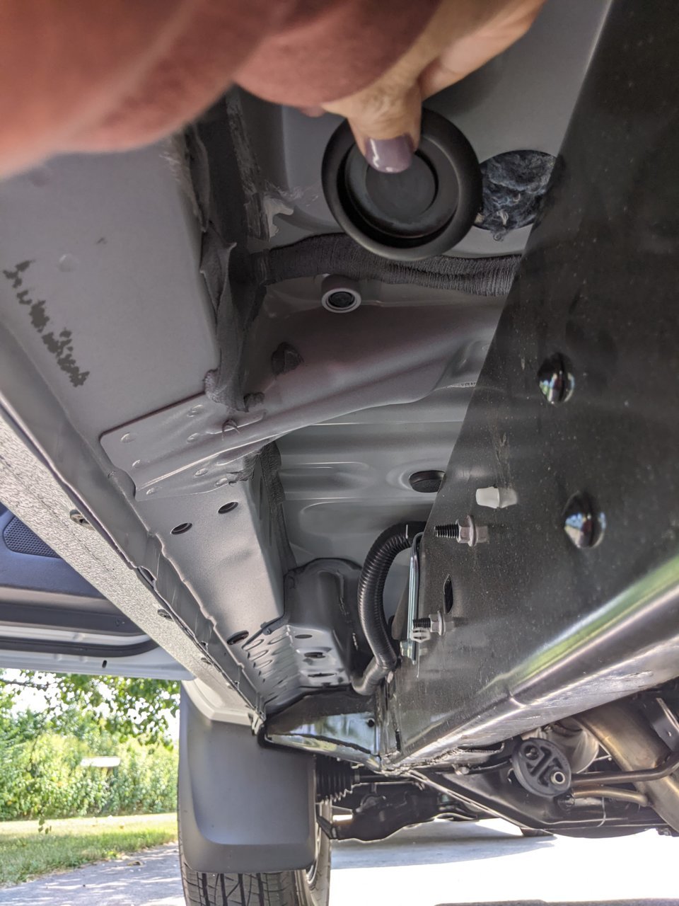

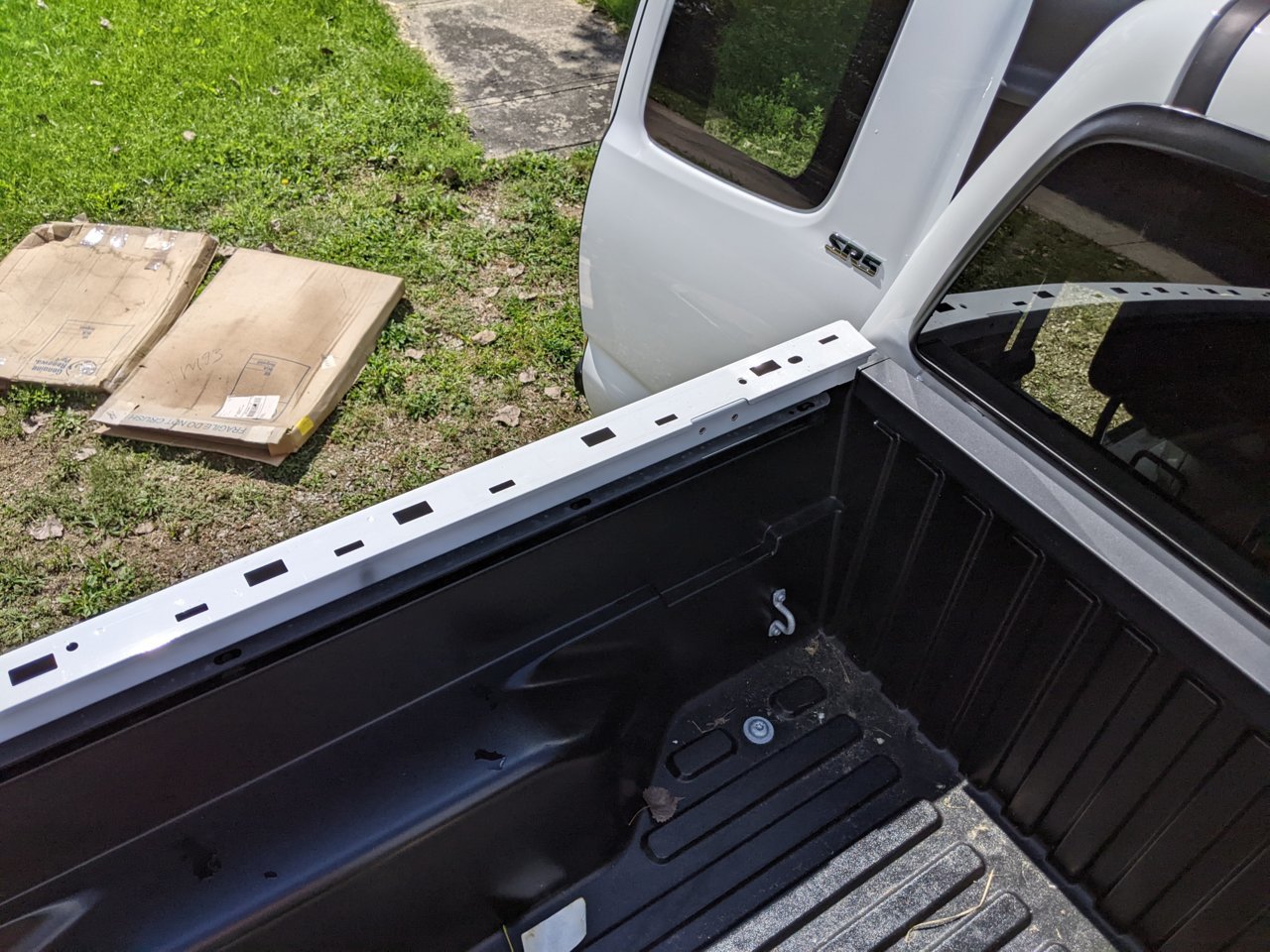

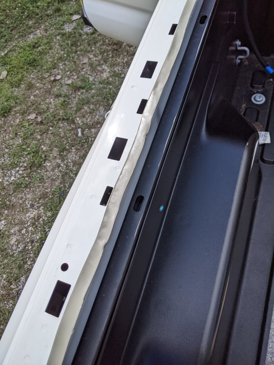

    Ran the power and control lines from the cab to the bed, sealed bedrails with butyl tape, taped up cables to wait for the cab to be installed.
    Wires are:
    110 volt from inverter in cab: pos, neg, grnd (10 awg silicone cable)
    12 volt pos from pos bus bar in cab: (10 awg silicone cable)
    Inverter remote control cable from inverter in cab
    12 volt ground from bed to ground point by rear wheel (10 awg silicone cable)

    Inverter and bus bars positioned. Main ground bolted to the frame and wired up. I'm making cables and doing the layout as I go, to make sure everything is the right length and routes efficiently. Double 1/0 cables are not very bendy.
    Once the electrical system is finished, I have brackets for the back wall and a piano hinge. Ella's bed platform will hinge down from the brackets and rest on top of the wooden vertical mounting wall. I can lift it to access the electrical s as well as the jack and the tool bin.
