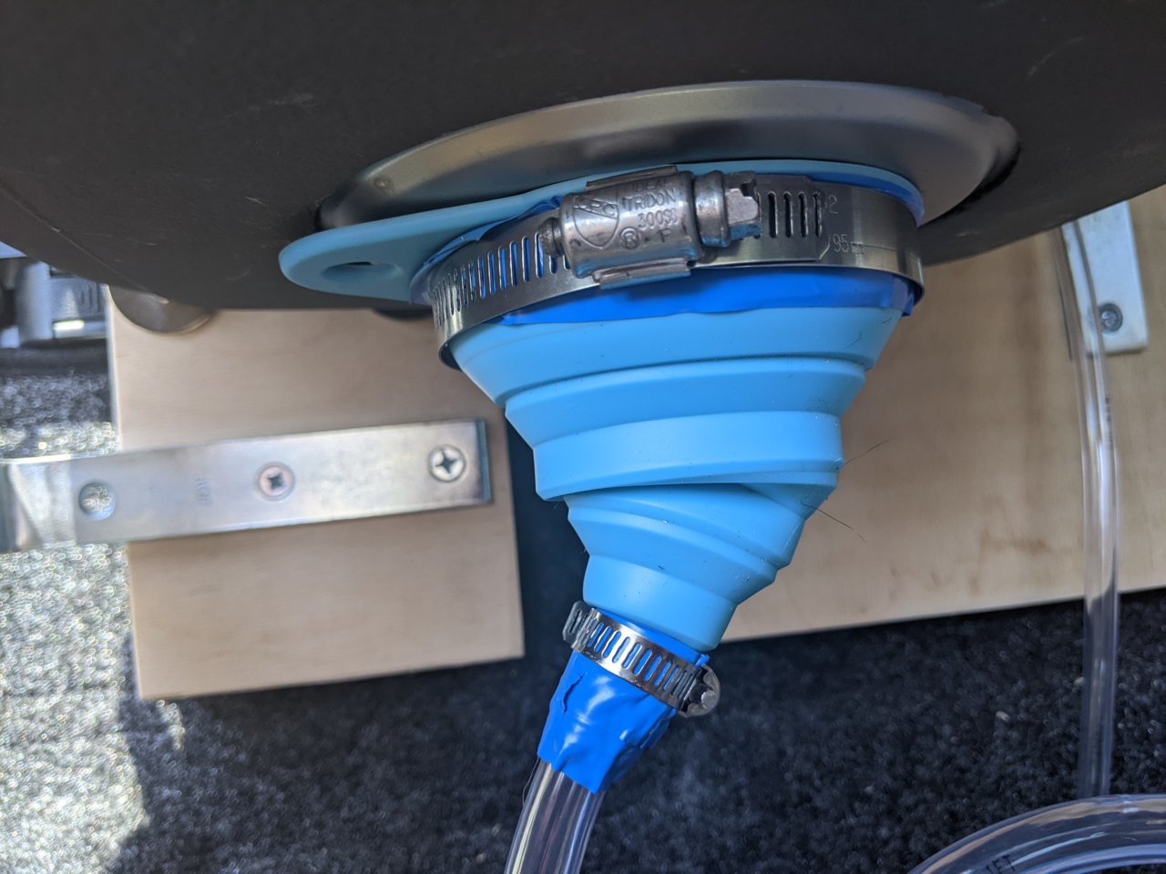

    Here's the sink drain solution. Used electrical tape to hopefully keep the clamps from cutting the funnel. I'm dubious that it won't slide off the sink at the top. I dont want to glue it there. We will see.

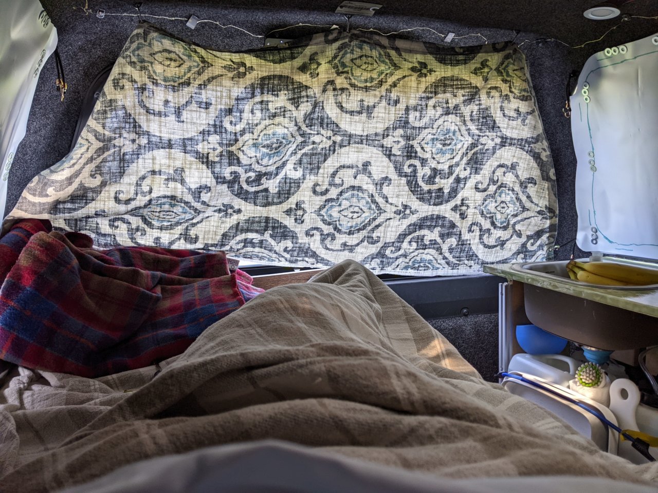

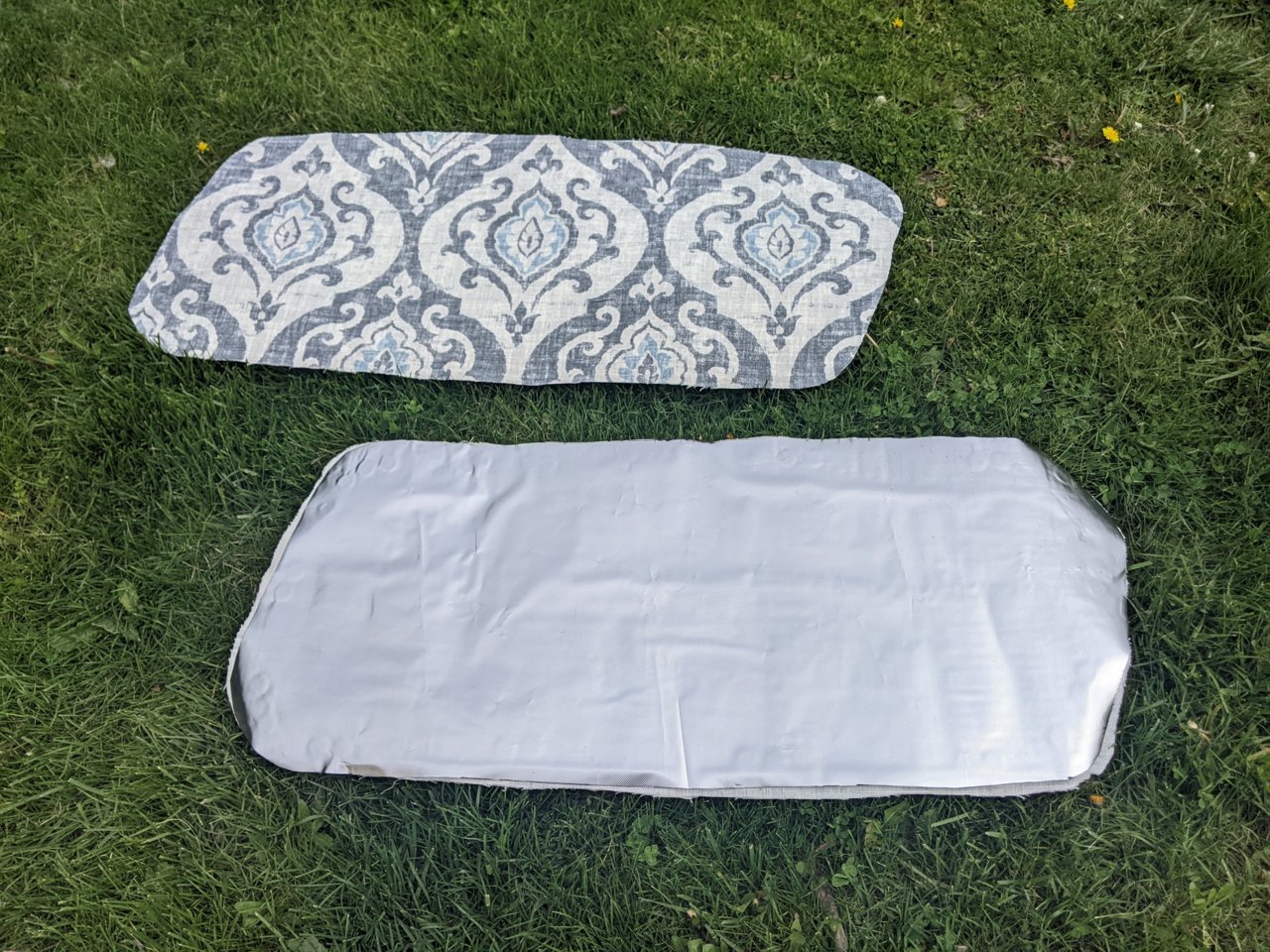

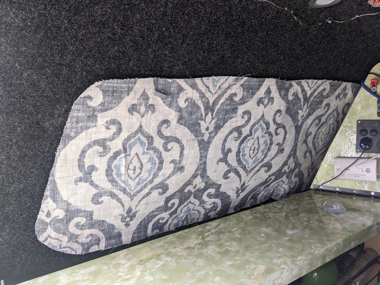

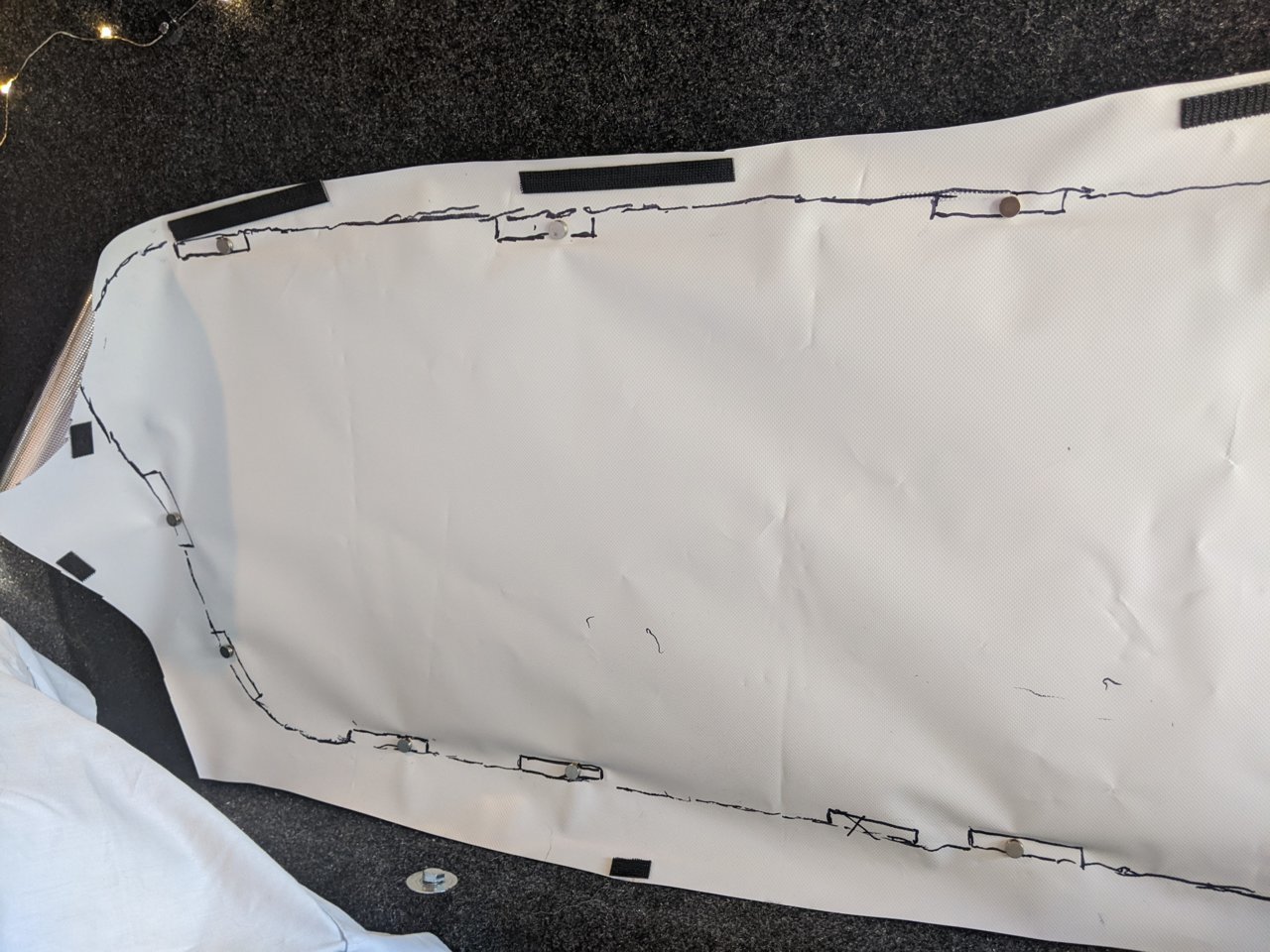

    Made slider window covers. I want them to not be bulky and to fit close to the windows so they don't impinge on the interior space.
    First, glued magnets around the window frames. Then held up some reflective vinyl and traced the outline. Then made a paper pattern and cut in vinyl and in fabric. Put washers around the border and bonded with spray glue. They look and fit pretty well. Might add edging later. If it gets super cold I can swap them so the reflective side faces the interior.7
    The tall bay windows have no metal to glue to. Instead I will glue magnets to velcro around the windows. The back hatch window is a conundrum.

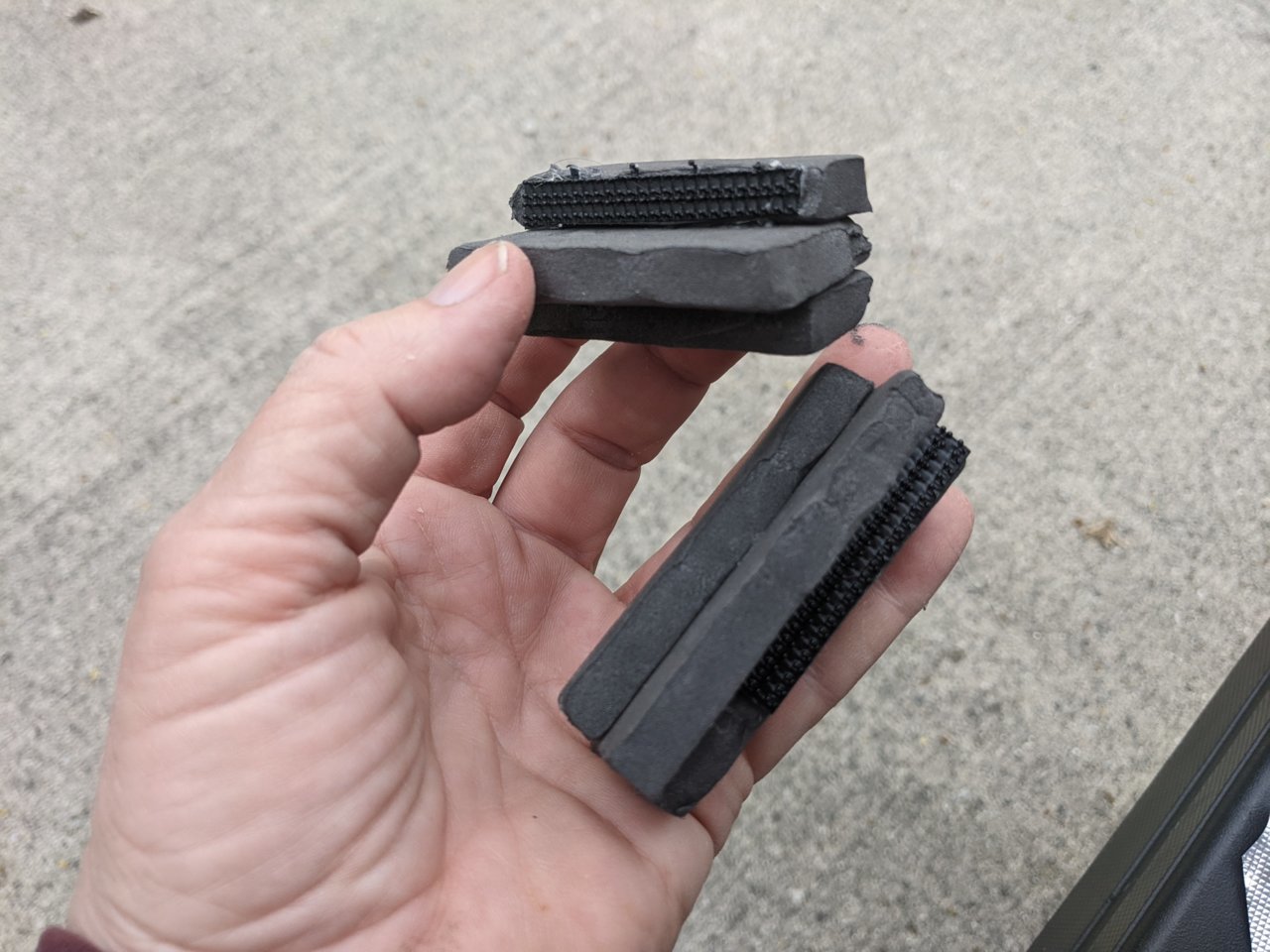

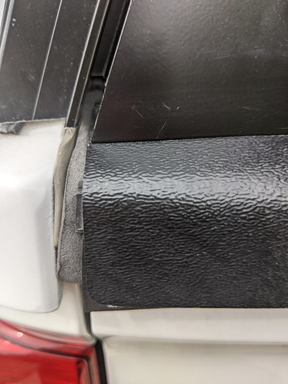

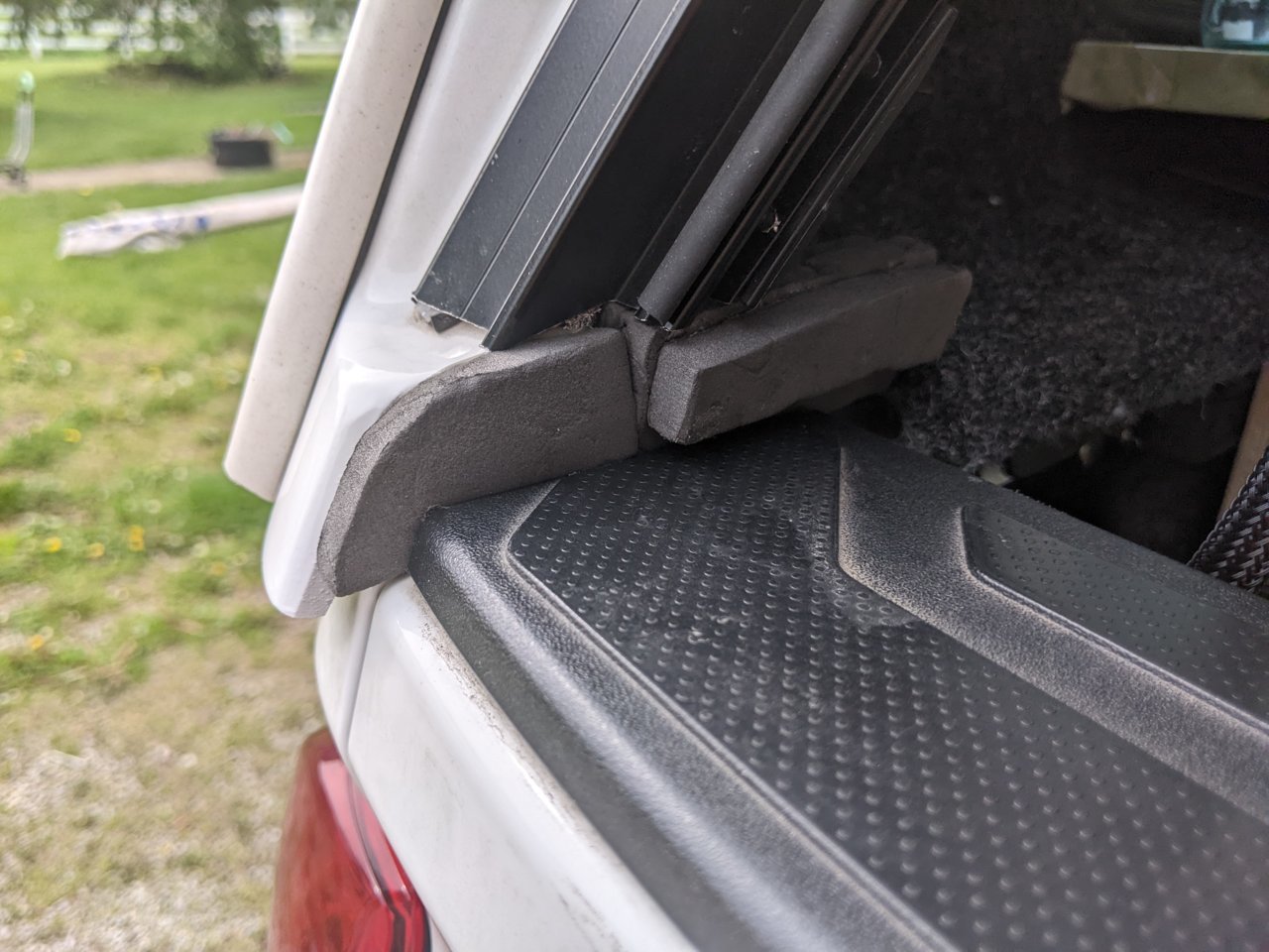

    Ok I think I have a satisfactory solution to the gaps around the back hatch. First I glued up some t-profile pieces of foam to fit behind the hatch, with velcro to hold them to the carpet. Then I cut a second piece to fill / widen the profile of the shell where the hatch closes. You see none of this interferes with closing the tailgate, and the hatch closes over the outside piece forming something closer to a seal.
    I can see now a single, more refined shape is possible. I will stick with this for a while before doing the final iteration.

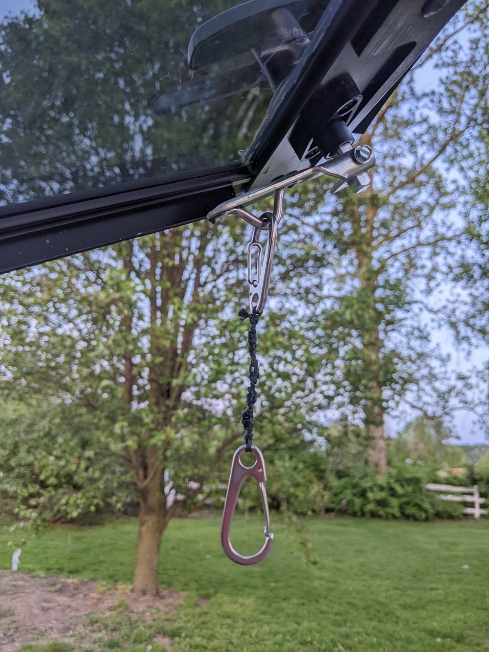

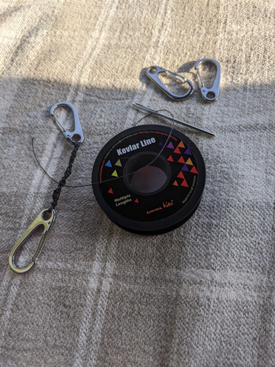

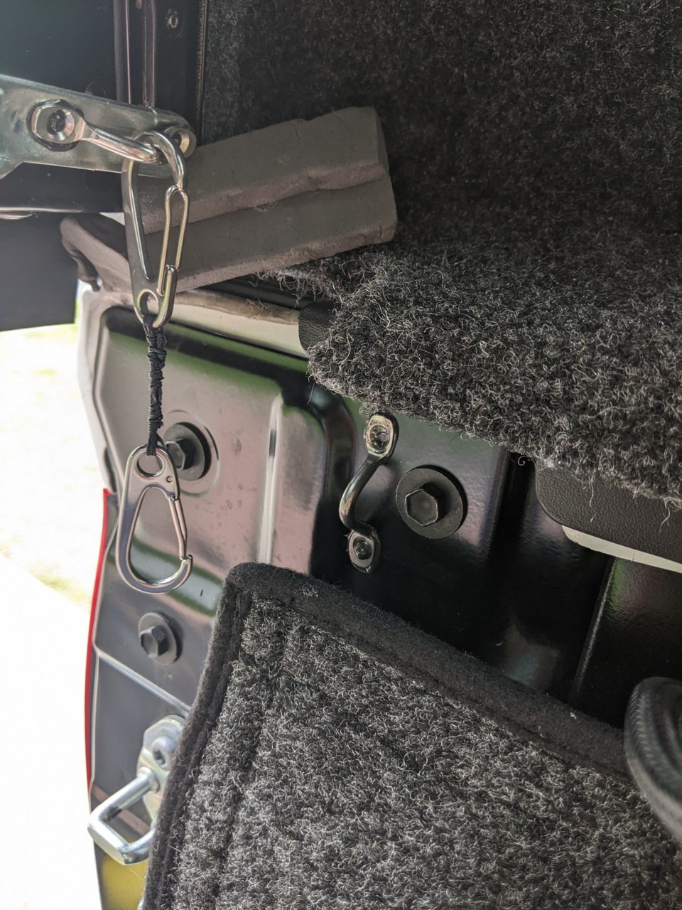

    My solution for keeping the hatch locked when I'm inside relies on 50 pound kevlar thread, stainless biners and pad eyes. Oh, and JB Weld epoxy.
    First I epoxied pad eyes to the latches. Then I figured out an appropriate length for the tether on each side of the hatch (it is not symmetrical). I used the kevlar thread to knot up a customer tether for each side, on two stainless biners. The thread is 50 pound test per strand and is of course non-stretch. Finally I tested the position before epoxying the pad eyes on the side of the bed, to ensure I can clip and unclip the biner but it remains tight enough that the latch can't be opened when they are hooked.
    I like this approach. It looks much prettier than other solutions I've seen, which all have looked pretty janky.

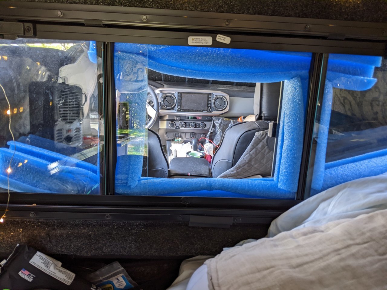

    Relaxing at the Bay of Fundy. Both of the attempts to use an inner tube to seal between the cab and camper failed after a few days. Now I'm trying cheap dollar store pool noodles, and if it works I will figure out how to make it permanent and prettier.

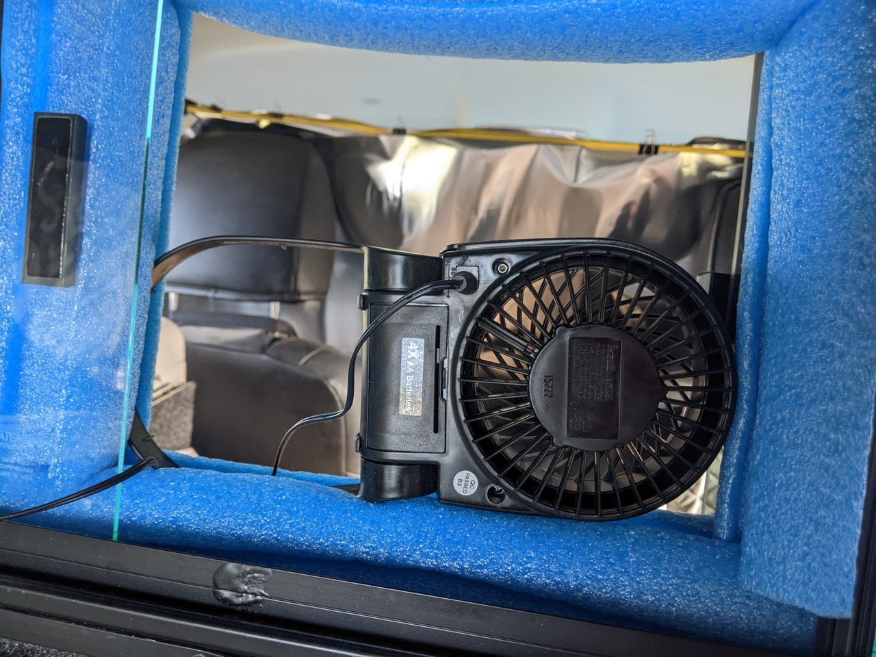

    The pool noodles worked perfectly! 100% blockage of air, essentially perfect insulation from drafts, and they have stayed put without tape for days now and hundreds of miles of driving. Just shoved them in there! I added a USB fan to get heat from the diesel heater on my side to Ella's bed in the cab. I also hang a divider of reflective vinyl over the seats so she has a little sleeper car. The fridge also puts out a small amount of heat.

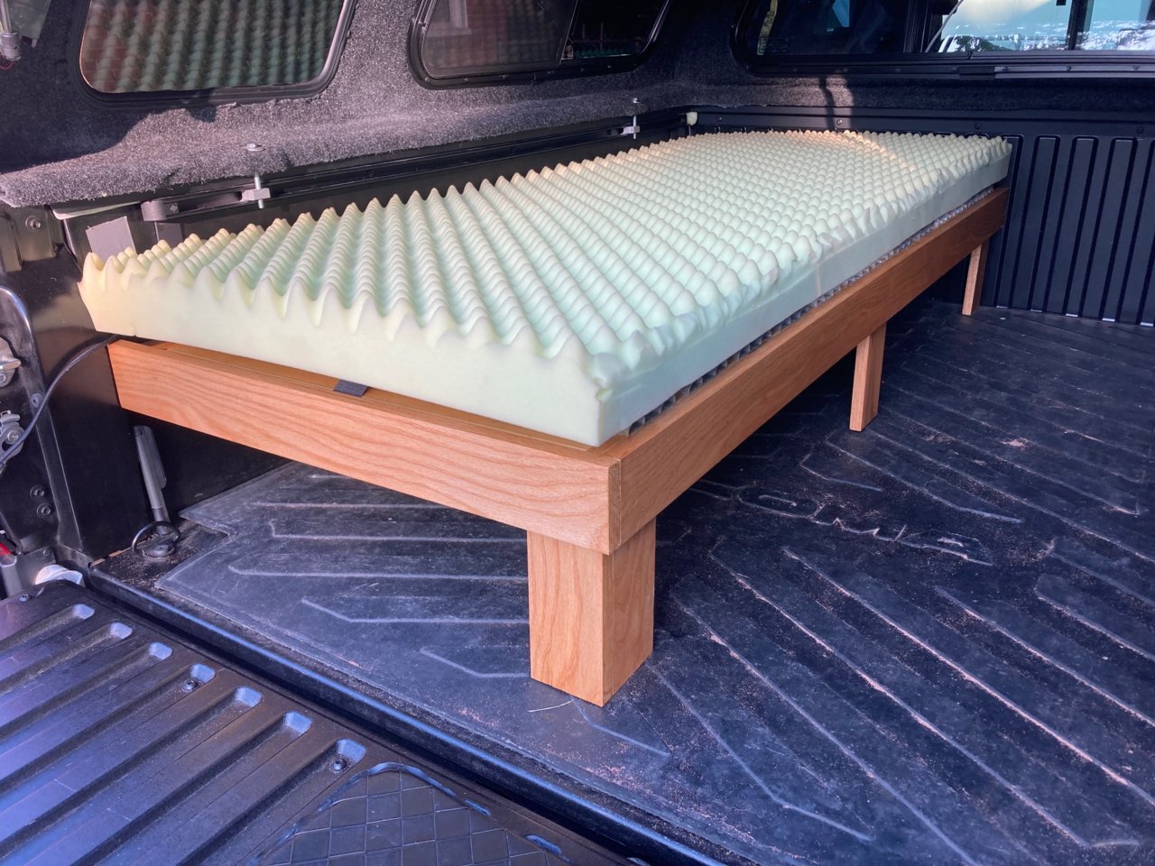

    Good Day Willow,
    Your build is looking awesome and has been a great source of ideas for mine.
    I haven't been on TW in a few months now and wish to share some pictures
    of my build that was inspires by yours.
    upload_2023-8-15_17-24-21.jpgupload_2023-8-15_17-24-21.jpgupload_2023-8-15_17-24-21.jpgupload_2023-8-15_17-24-21.jpg

    @Redfox88 @TacomaWillow Your setups are great! would either of you mind sharing your dimensions for your bed setup? Trying to figure out how much space to designate to sleeping, thank you!
