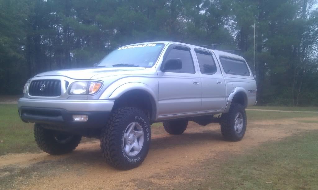

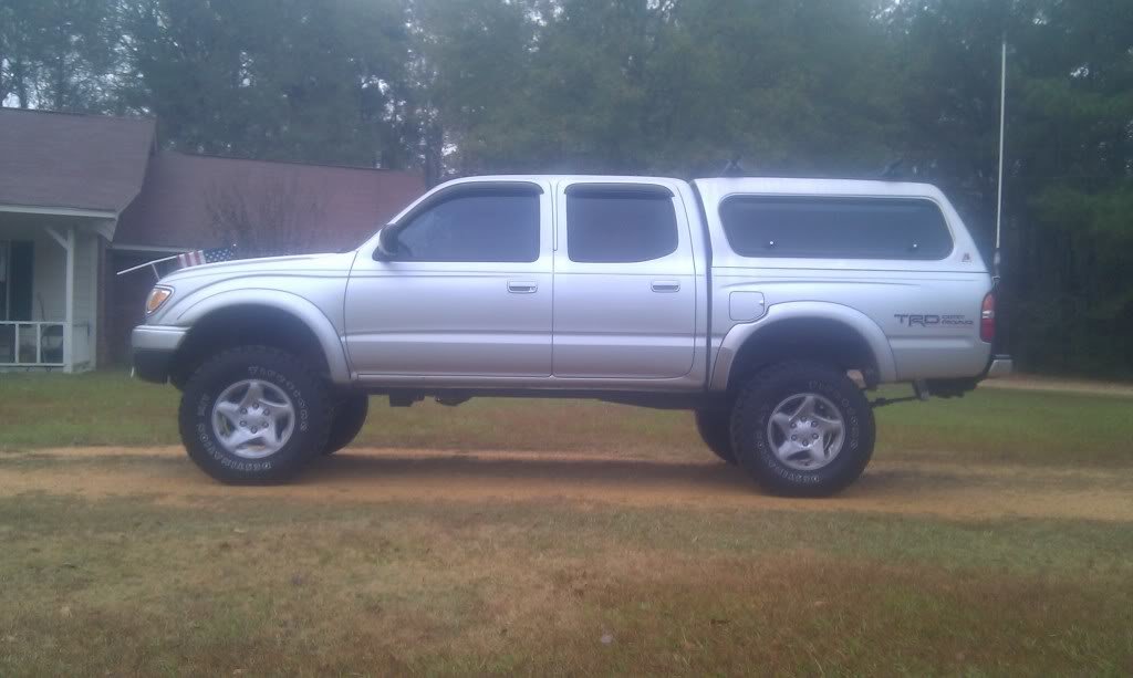

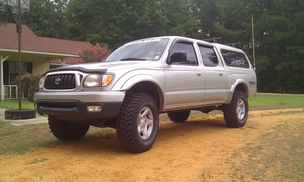

    before and afters

    :woot: Looks good! You got a lot of lift out of those 882s and trimpackers! How's it ride?

    Same as before... rough lol
    The cv angles are mighty steap. even for after I do the boot slide mod. I may take it down later and remove the trimpacker. Haven't decided.

    Yeah you may want to take those off until you get something like a steel bumper... I hope it settles in nicely though. Even my 881s were rough at first.

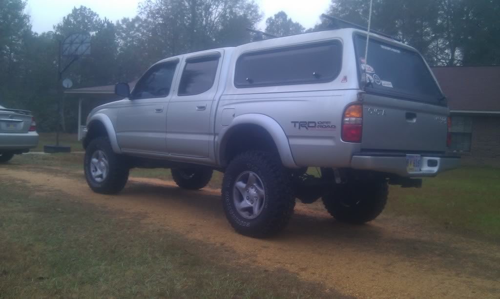

    Oh, what's the rear setup? Homemade leafs and shackles?

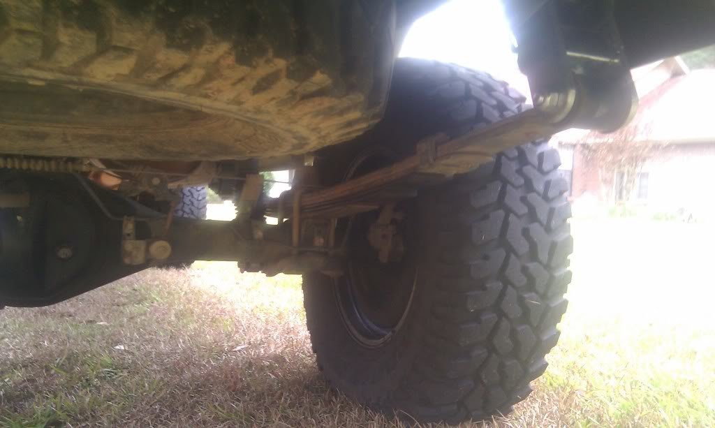

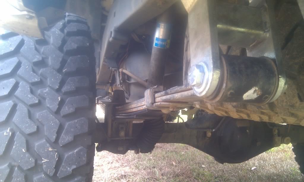

    Home made leafs and 3" longer shackles. I'm pretty proud of how well the leaf packs turned out. I'll try to take some pics of the rear set up tomorrow.

    Here's a couple pictures of the leaf packs

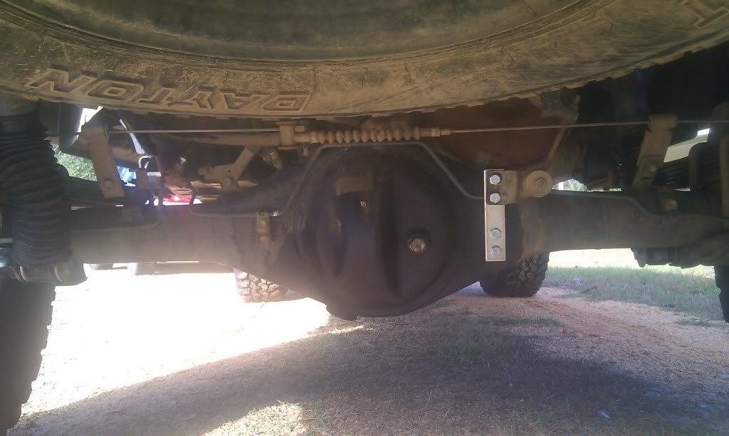

    I know. I ran out of time when I was putting everything on. Had to get to work. I have a bracket ready to put on. Just haven't gotten the time. It will be done in the morning though. I also had to cut my tail pipe. So I need to shape up that tip a little better.
    Three, kinda... I had an aal on it before, I added two leafs between the aal and the original pack, and took out the overload spring. I figure I don't need it if I have bump stops. Which is another thing I ran out of time for. Will also be doing the boot slide mod in the morning.

    put bracket on
    And wanted to check to make sure all my lines had enough slack but couldn't get a tire off the ground to know for sure.
