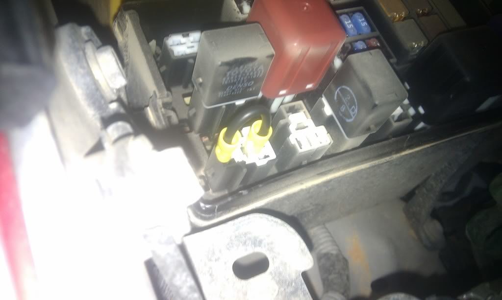

    oh and I also found a freebie from the previous owner

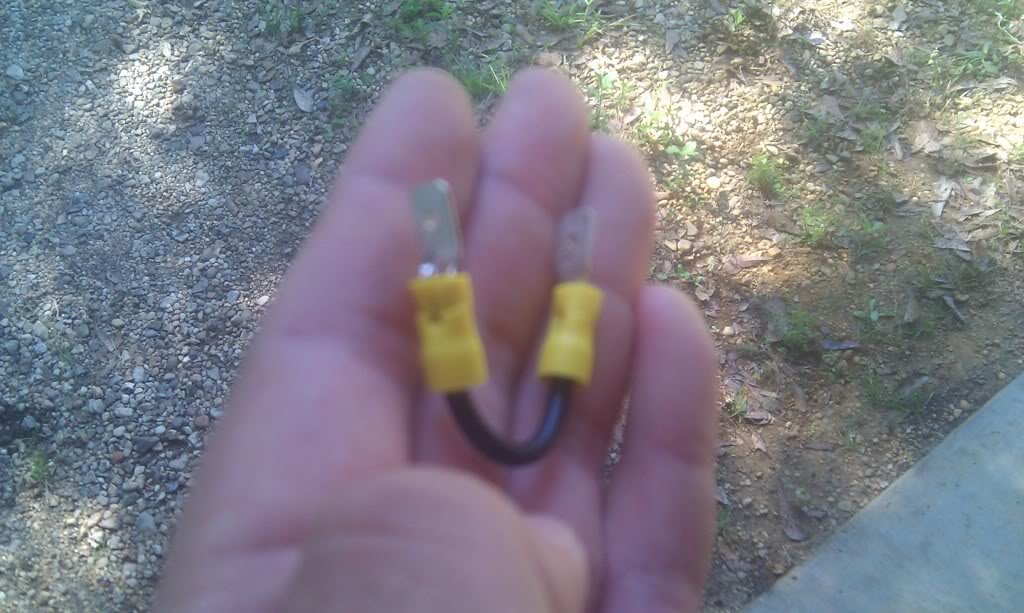

    Nice^ might have to steal the jumper wire mod..& not trying to tell you what to do but why dont you run your GPS to the driver side corner of the truck so you can completely hide the wire up under the dash and through the whether stripping up the door frame?

    I thought about that, and I may move it. It's just that is where I've always had my gps located. I also have a bad habit of driving with only my left arm and leanin on the console with my right. So when I do that I can't see the gps over there because my arm is in the way.

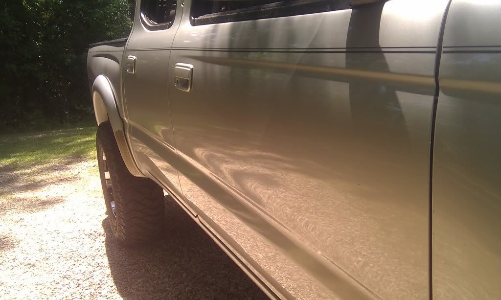

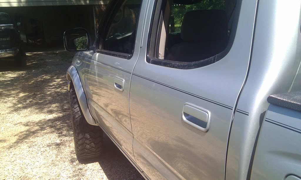

    debadged today

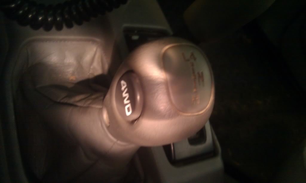

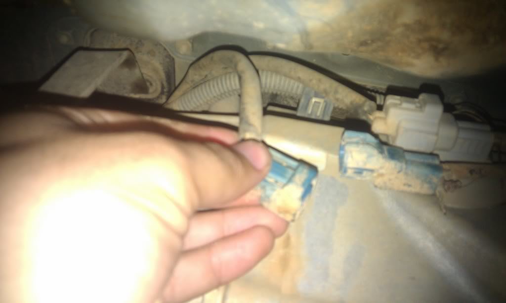

    added the two-low mod

    Everyday new shit, better slow down before you run out of mods :p whats the 2 low mod do?

    The 2 low mod is for the push button 4wds. normally for running two high the 4wd gear shift is in the high position and for 4 high you simply press the button on the side. for 4 low, normally you simply move the gear shift into the 4 low position (not having to press the button). by pulling the blue plug on the side of the t-case, you make it to where you have to push the button while in 4-low. So now you have 2-low when in the 4low position with out the button pressed.
    clear as mud? :p
