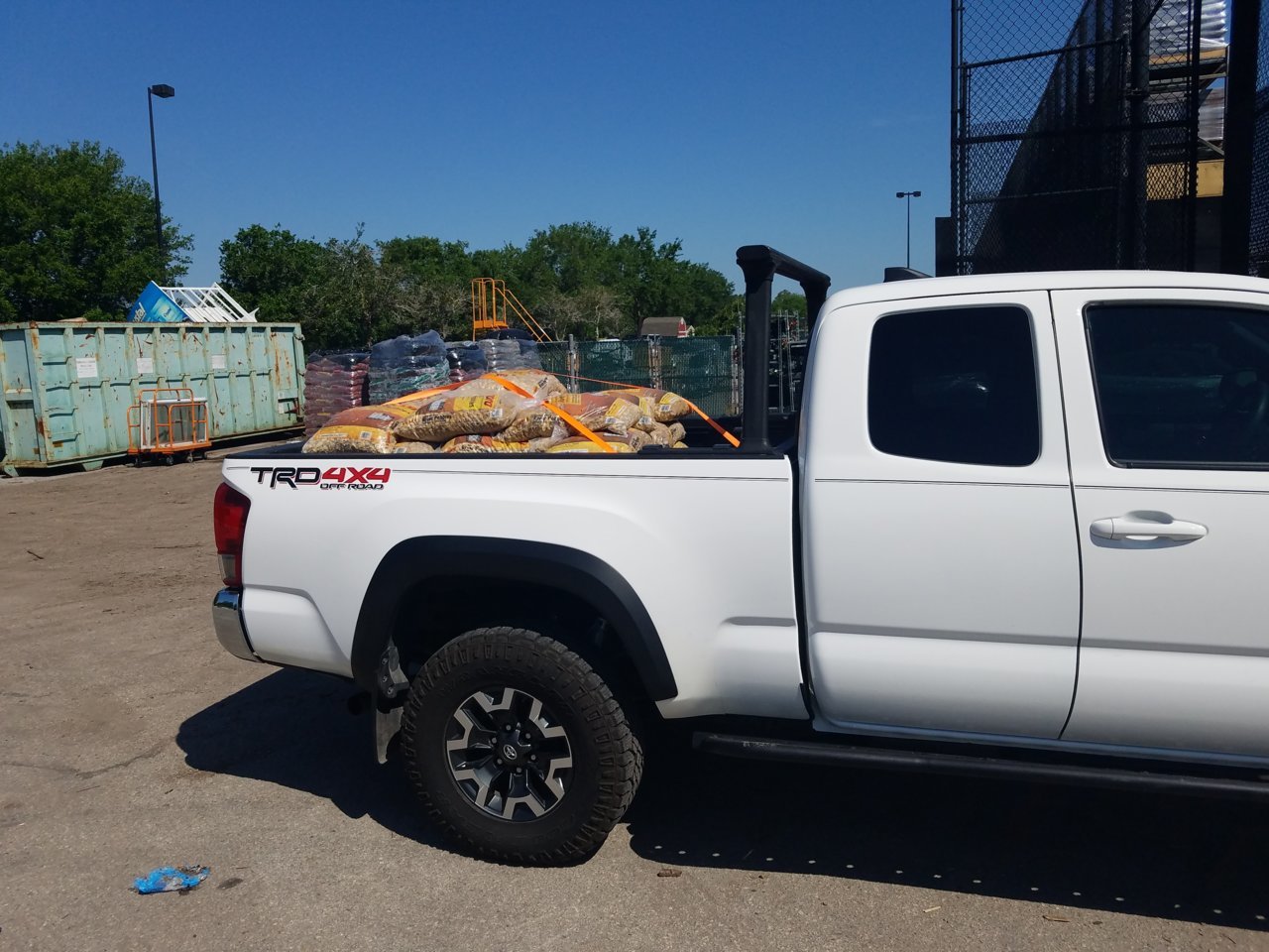

    Not a SA200 specificity. I have put a lot a weight in the bed. Spread it out. If there are pressure points (e.g., 4 legs/wheels) lay down a sheet of 3/4 plywood.

    Payload weight for your truck is stated on the driver door pillar. Mine is 1000 which includes the driver, so my bed weight is 810 unless I have a passenger. Then it’ll be less. :)

    Although I would never advocate loading a vehicle in excess of its approved ratings, if you were to calculate it this would probably be about ~2k lbs.
    (As others have said, I keep a piece of thick plywood on top of a rubber bed mat all the time. Helps redistribute the load. For really heavy loads, a pallet turned correctly helps to spread the load to the frame rails)
