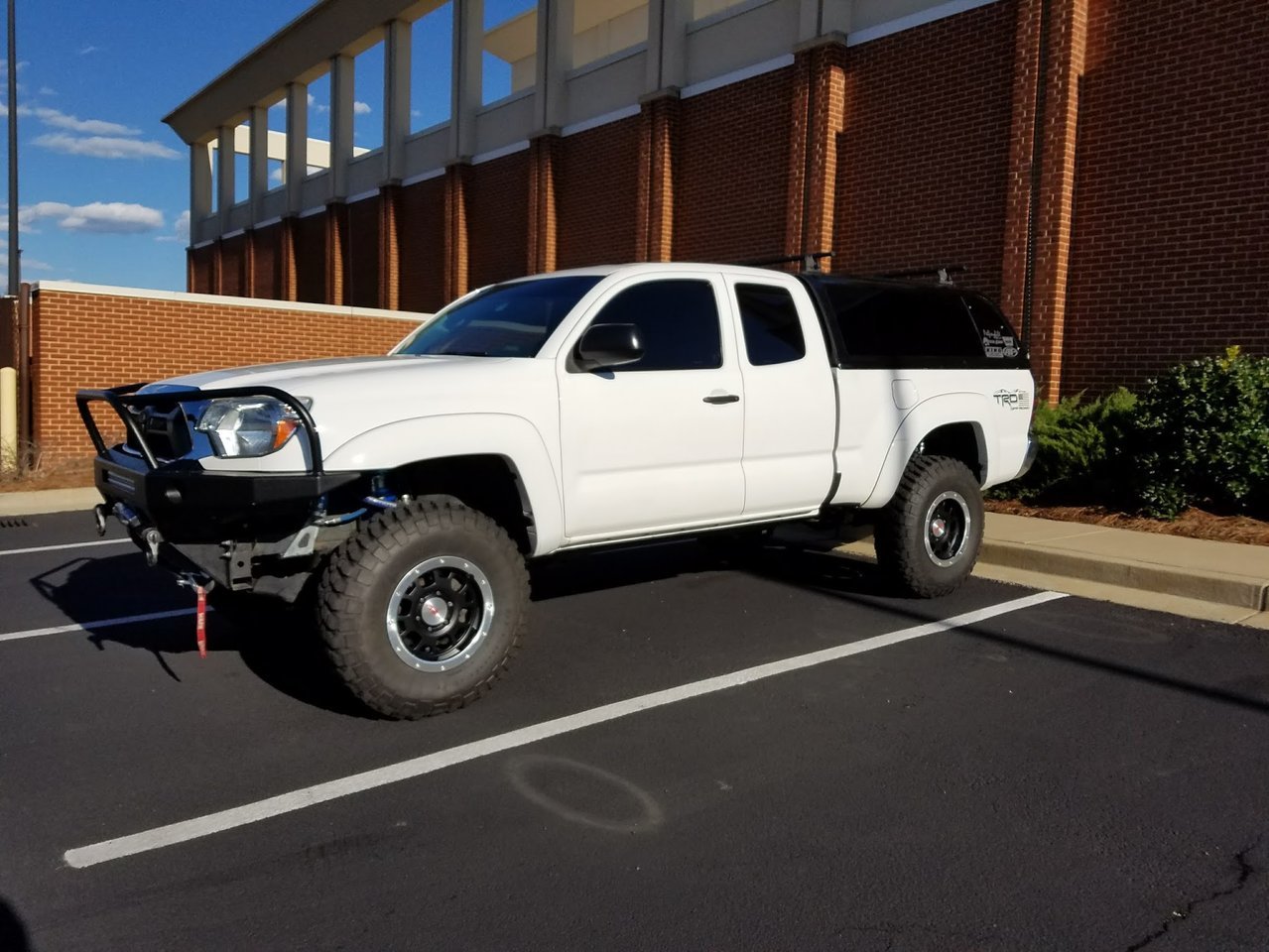

    How she sits today...3/2020
    wpicCepbHSfJWmagshzNnoCqaWXGdwWTeVJk2P8I_82cf800dd5db41a937666b1fe523634517e0c80f.jpg

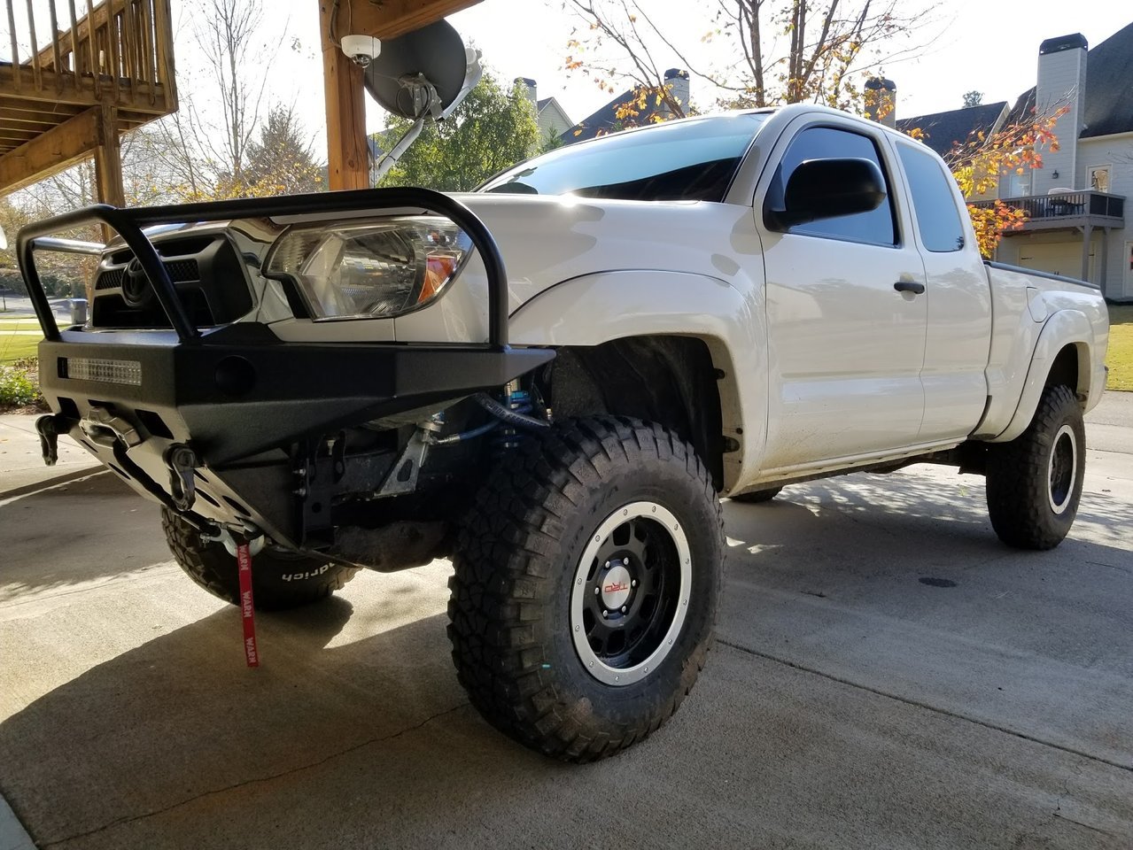

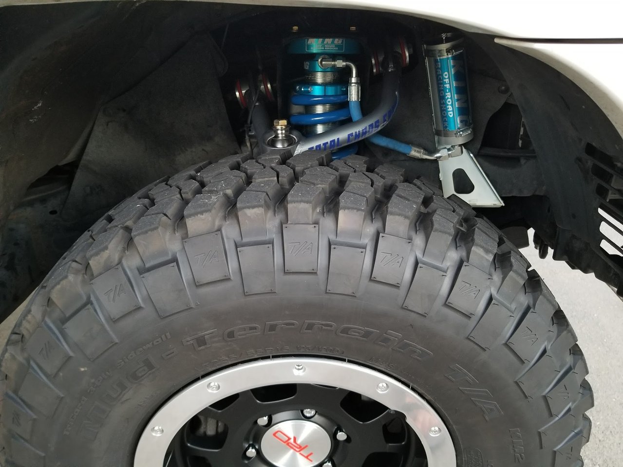

    First thing to do.....Suspension and Shoes.... Went with KING's again and Total Chaos UCA's.
    VsBih4TEq3P9NhtNd0-Tkgfv-FCeKND4jnhTAsGU_ec215c7a25187919a55f0b0f747d558765f02fcc.jpg
    du3yuVlUoDwu4ptKDzoaA-s4lOinScCRQR2nIhl8_4a5ef6fd77562776f3516401c5c6d9588582f40f.jpg

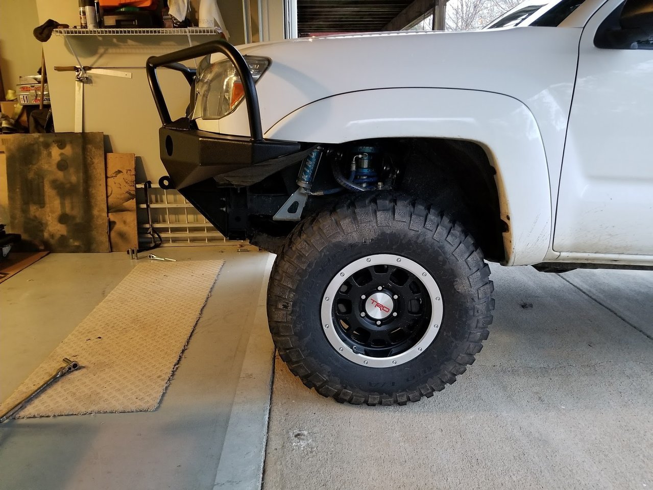

    Stuck with OEM TRD Wheels to keep it clean.
    fRsfg9ljvLn3O-41eOujgi8pZdyG27oWSkGiONX4_97b667324408682945ce0b03e2d6c8a2f5362bea.jpg
    t4UGiVhgVPz3DL_B9hZPQHjbQvUstFC0XYF3615__c2e5c7d210d32bb5657c922803013027186a5722.jpg
    Came in right around 3" of lift when it was all said and done. More to come....:cheers:

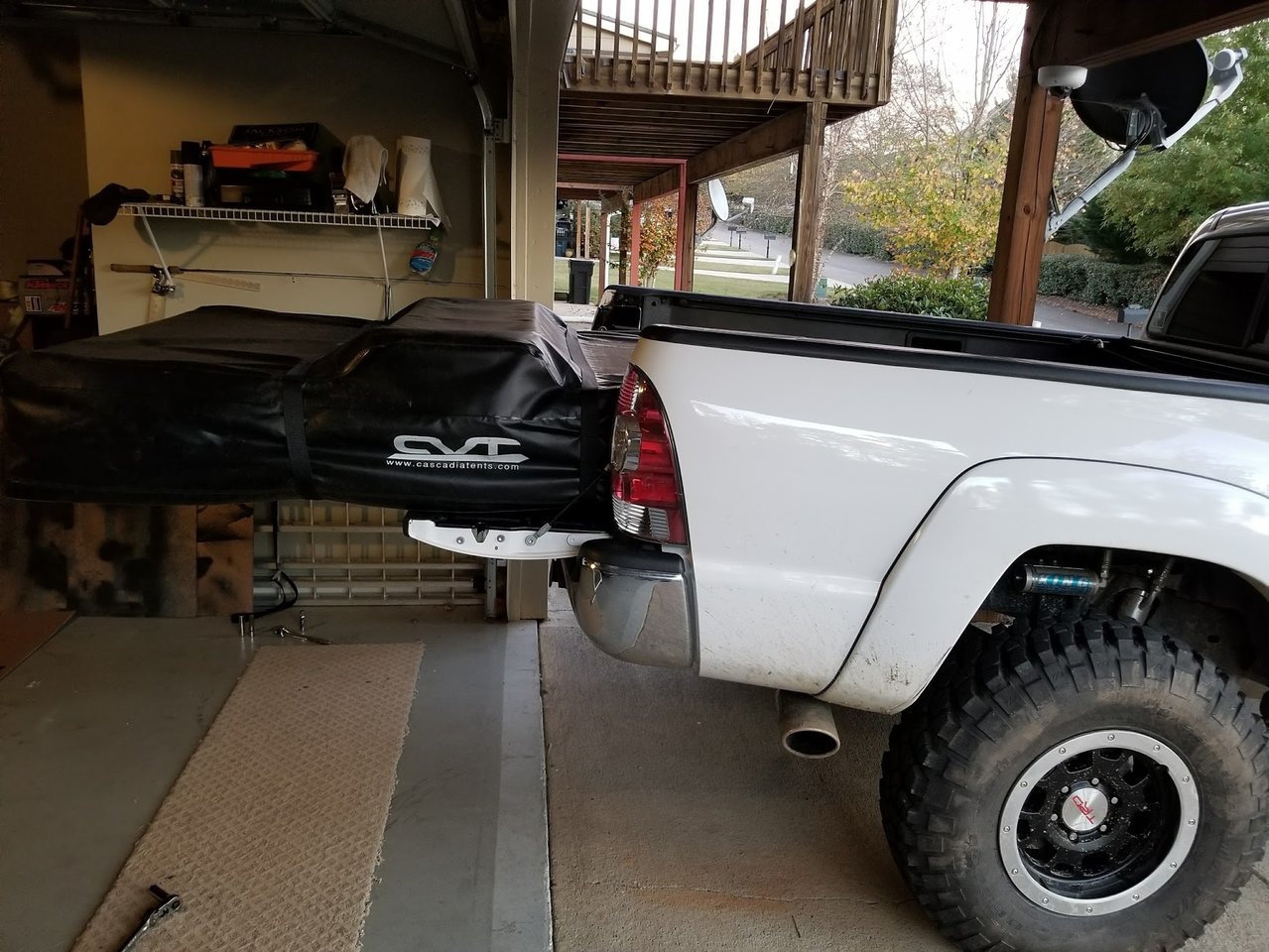

    Picked up a nice addition to the Trout Expeditions in the North Ga Mtns...... :D Now I'm on the fence about a Camper Shell or a Rack to mount it with. o_O

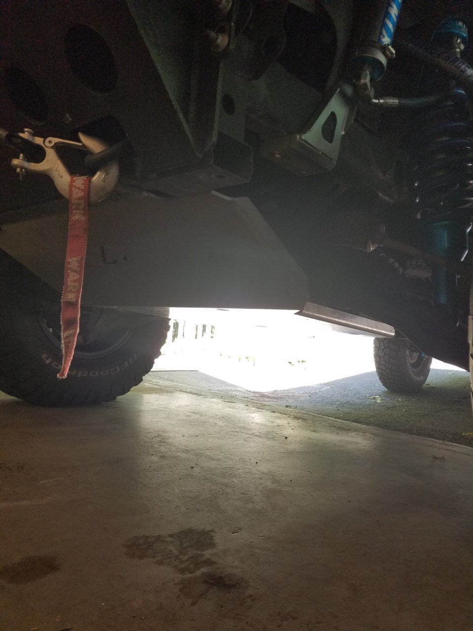

    Sliders Landed. Now just need to get these burned on the Truck. Thank you @Pelfreybilt for another awesome product! :thumbsup:

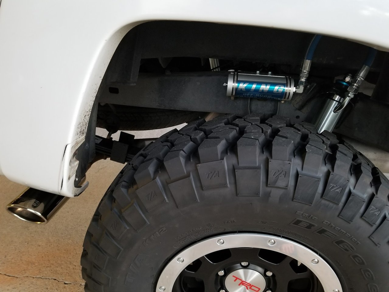

    How does your truck ride with that much preload on the Kings? CV angle? I got the same setup only with 650# springs
  11. Jan 4, 2018 at 7:31 AM
    TacoMeSir
    TacoMeSir [OP] WiFi Guru
    Mar 17, 2014
    #125531
    399
    Tim
    North GA
    2024 TRD Off-Road Hybrid Premium
    Stock
    Rides like a cloud with the bumper and winch installed. If you run without any weight on the front, it's violent! In addition to removing the sway bay. Highly recommended to put some weight up front. If you go bumper and winch, I would suggest the 700# option to reduce any sag. :cool:

    That CV angle looks extreme lol. Worried about the boots at all? I got the Kings with #650 springs with aluminum bumper but all steel skids so they settled under the last time I adjusted them up a bit.
    Edit: Whats your caster at with that ride height?

    Just saw your post. LOL! Sorry about that. I'm not sure what my caster is set at currently but will get that info for you next time on the rack. I'm not too worried about the boots at all really, I ran this same setup on my old T|X and wheeled the hell out of it. Never an issue. How have yours been treating you on your build?

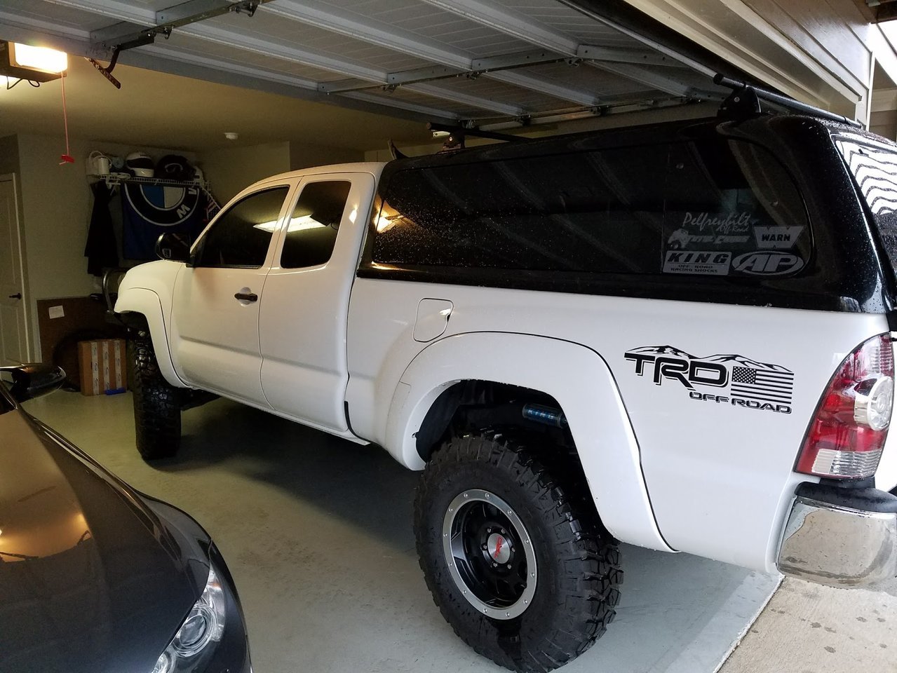

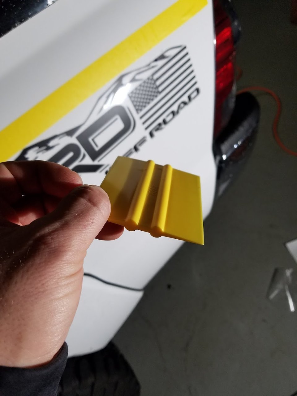

    Upgraded the bed side TRD Off Road Decals on ole Marvin finally. Thanks to @CBoy808 for doing these up for me! They turned out great! Thankfully I've got years of experience applying this type stuff from racing dirtbikes for so long. Very straight forward. Very well crafted product and I highly recommend his stuff! God Bless America!
    I would invest in one of these fine pieces of plastic for sure!

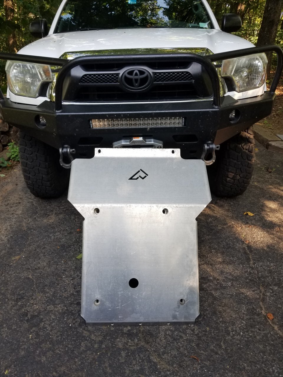

    Finally found another PB IFS skid for the Taco. Went from Steel to Aluminum! Been awhile since my last update fella's!
