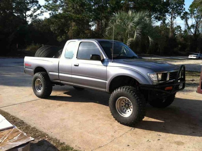

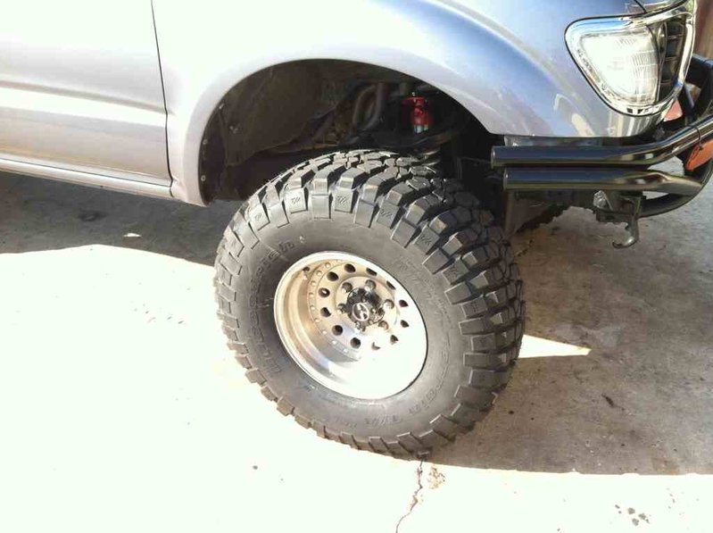

    New shoes. 32x1150x15 BFG KM2s

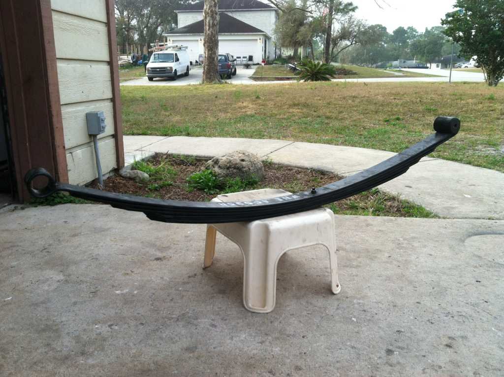

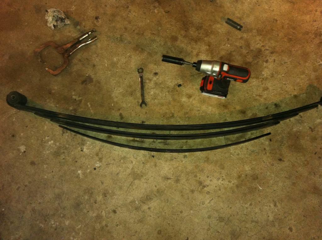

    Adding a wheelers AAL to my wheelers 5 pack. This is what they look like pre assembly...the bottom leaf is the AAL.
    Will be leaving the overload leaf out so I only get about 2-2.5" of lift.

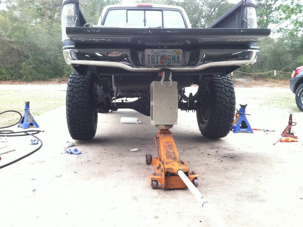

    Got my AAL added to my wheelers 5 pack today, sittin' sick...haha...
    and got a new battery today...will get pics of the rear suspensions soon

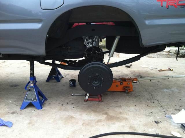

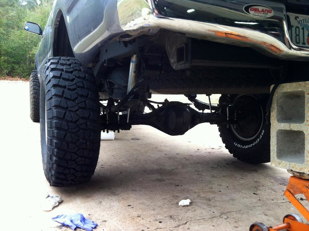

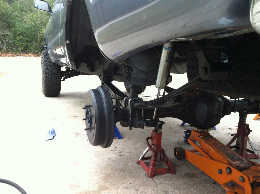

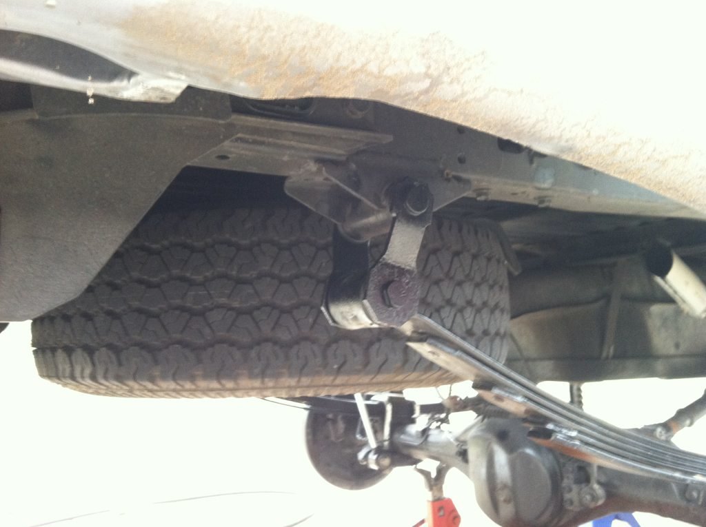

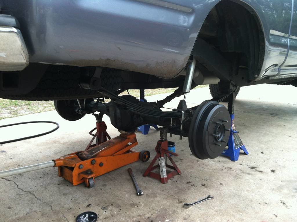

    Done adding Wheelers 1.5 AAL to my wheelers 5 pack, sans the overload.
    OEM shackles, removed the daystar 1.25 shackle.
    DROOP!!!

    just need to add alignment clamps to the packs...

    Why'd u ditch the shackles?

    I wanted to stiffen up the rear end without adding any lift over what I already had. If I kept the shackles I would be getting close to 4" of lift, which would be way too much for my 5100s to handle. So with the 5 pack, the AAL, and minus the overload leaf, right now I have close to 3", which I hope will settle to about 2.5"

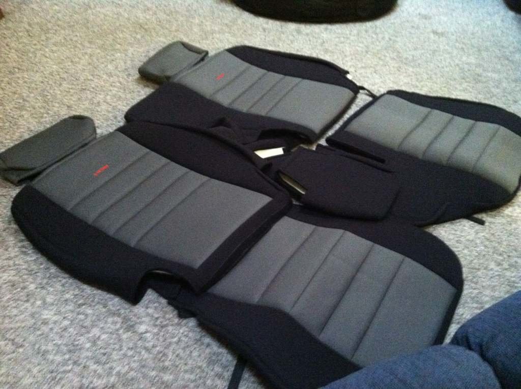

    Got my wet okoles in the mail:

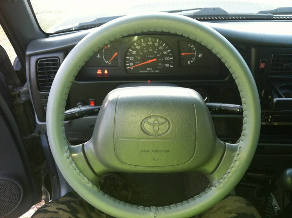

    Installed a "Wheelskins" leather steering wheel cover. Looks factory. Much better than my worn out steering wheel, and much nicer to the touch.
