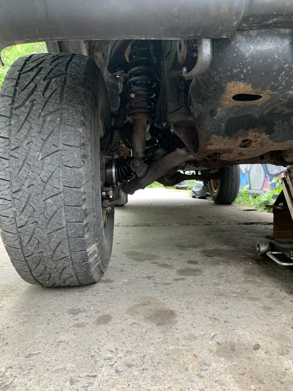

    Help me ID this lift. I want give my lil taco the special treatment but I can’t seem to figure out the suspension lift I’ve got on her. The previous owner has no idea so I’m at a loss!
    Suspension measuring at 18 1/2 compressed (on the ground)
    And 20 3/4 uncompressed top to the center screw

  2. Jun 3, 2021 at 7:32 PM
    tcjacado
    tcjacado Well-Known Member
    Aug 29, 2016
    #195947
    41,586
    Looks to be a 3 inch spacer. The cv angle doesn't look very happy.:(

    Inside tire wear doesn’t look happy either, probably related to the lift.

    Lift too high. Thats why its got new cv boots and it won't last very long. Better research how to do it yourself or its going to get expensive

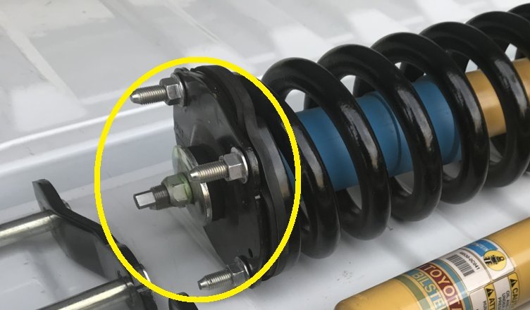

    Then you'd know that the lower ball joint is a large joint that goes through the lower control arm.
    Here is the top of a coilover
    Completely different mounting.
    And the spacer you need to get rid of
