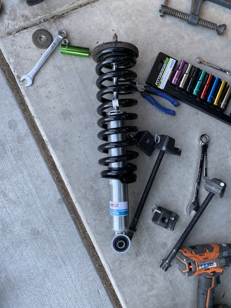

    More like, suspension that needed replacing long ago but yes, just regular coilovers up front.
    I wonder if the previous owner put a block in the rear to give it a 'leveled' look.
    It'll be a solid square piece sitting between the leaf pack and the axle housing.

    It appears so but for all we know the springs could be aftermarket lift springs, can't exactly tell just by looking. Remove the spacer and see where it sits. That looks like a 3" spacer almost...which would give you 6" of lift. Way too much for an IFS 4x4 pickup

    You have a semi-new set of coilovers set for stock height.
    Perfect for the OP if they want stock height, and a quality setup.

    yeah for sure! Wanna buy them OP?

    Bilstein 5100 with 880 coils set at 0. Would be perfect to replace those with. $380 shipped. What’s your zip code?

    ^^ that would be a much better setup. I think the 880s give about 1" of lift which is more than safe for IFS 4wd drivetrain
