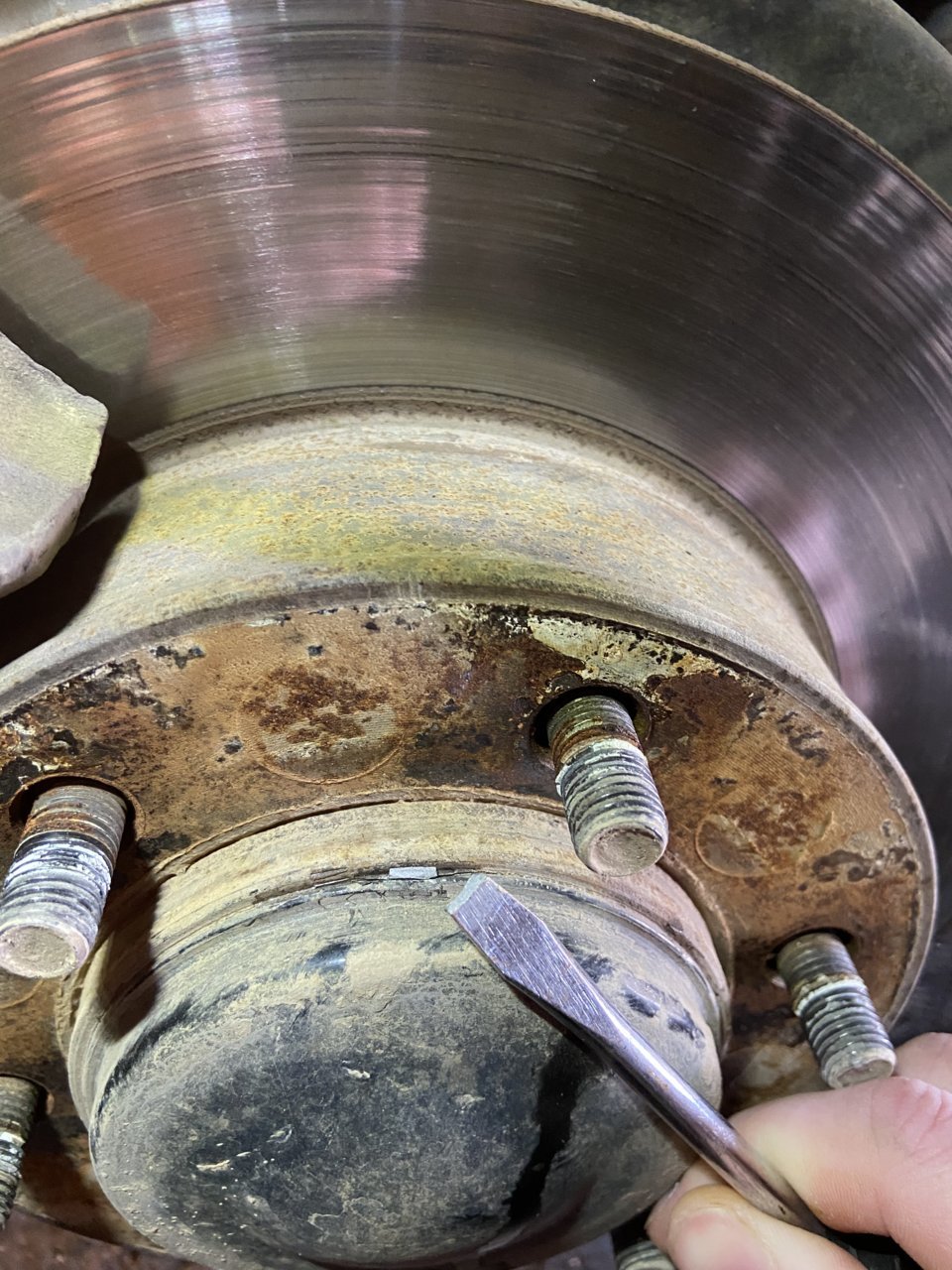

    Aha I found another problem in here. I kind of expected it but I need to do brakes. I was thinking about just doing pads and leaving the rotors but I’m going to do both to be safe I think.
    Anyone know how to tell if calipers are going bad? I don’t have any issues with braking but the pads are worn a bit different (outside worn more than inside) on both sides. I don’t think this would cause a problem with braking unless when I try to compress the pistons or pull the pads out they are jammed up at all in which case I will either try to clean them or get new calipers I guess? Any suggestions?

    Sounds like they're just out of adjustment?

    Usually if they aren’t even it’s because of the guide pins the caliper sits on. It gets stuck and doesn’t slide freely.
