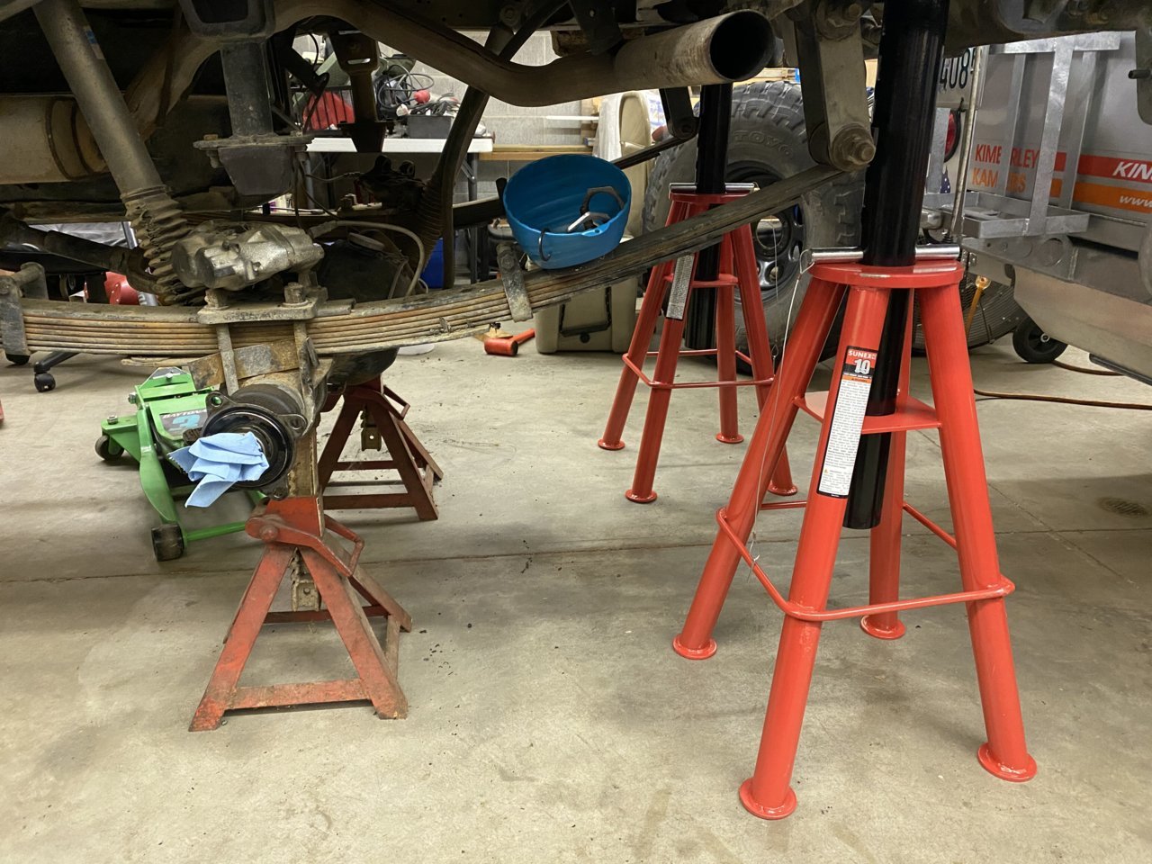

    Pulling the rear axle out of the 4Runner to chop the leaf perches off and weld them back on at the correct angle so the pinion is lined properly with the drive shaft.

    Looks fine, definitely seen worse.

    This is OSHA quality safety as far as the usual shenanigans at this shop.

    Also, are axle shims not an option here?

    They are but we all know it’s a stop gap and will end up being a problem with all the abuse it’s going to get. Just chop them and weld them on correctly to have it done right and behind us.
