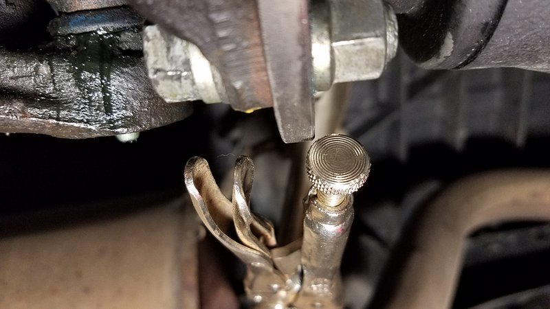

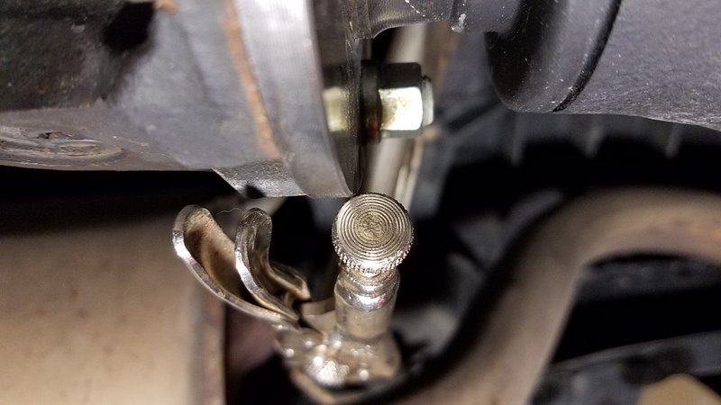

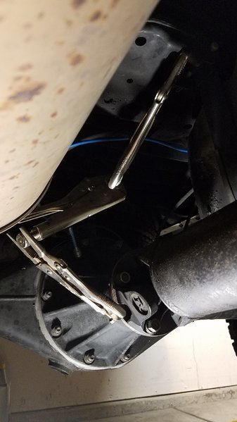

    This stinks! I took off the rear drive and rotated it. It was more for it being seated correctly than placement on the flange. Worth a shot while it's off. The drivers side front cv axle looks like it's out slightly more than the passenger side. I removed it and put it back in with no change in how far it went in. It has the appropriate amount of jiggle back and forth telling me the c clip is engaged.
    The test drive.... Strong vibration 35 to 45. At slower speeds(35 - 36) it feels like it's in the steering wheel and every other speed is in the seat. It sounds like it in the rear but there is not much externally and it all looks good. That's why I rotated the driveshaft on the flange. Oh.... the vibration gets worse acceleration and is a little bit less when I'm off the gas. Any ideas would be greatly appreciated. I'm going to call ECGS tomorrow too.

    I couldn't be happier right now. The vibration source is found! I jacked up the rear of the truck and got the wheels turning 40 mph. The vibration was definitely there. Hallelujah! Now trying to figure out where it's coming from. I don't have a dial indicator so I made the closest thing that I could think of. Vise grips.20170313_174741.jpgI put the round adjustment nob on the back corner of the flange and turned the drive shaft.20170313_174838.jpg 20170313_174828.jpgIt's a little bigger than what the picture shows but you get the point. Bent flange!!!! ECGS was super cool about it and is sending a new flange out. Although he did say that he's never seen that before. Either way the problem is identified.

    I hate those moments where you clearly weren't thinking. So I have this bent flange and I was frustrated because ECGS "new" flange won't get here till Thursday and the vibration is pretty bad. This morning I walked right past my old third members and Ding Ding Ding! Hello! I have a perfectly good one sitting right there. :facepalm:Swapped it out after work and the vibration is gone. Except it must have been bent pretty good as it broke the spring in the pinion seal. I'll take care of that another day.
