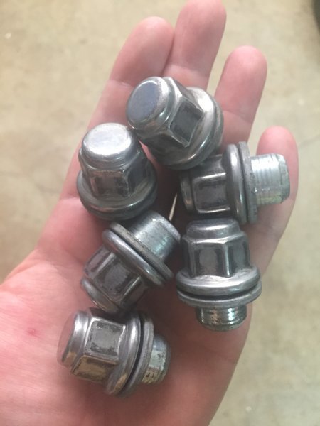

    Bought a set of secondhand OEM lug nuts and they arrived and I just noticed that they are a bit shorter than the ones my Sport came with. Anyone recognize these?

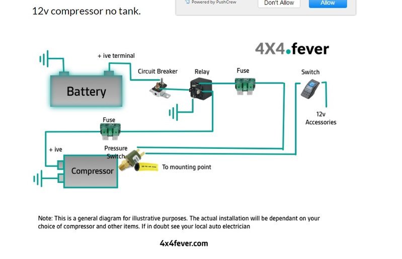

    @VangaSTL I've ordered the Viair 300p compressor and want to have it wired in the engine bay. Could you help me out in what I need to purchase to be ready to do it? Along with those little rock lights I talked about previously.
    I already have CH4x4 buttons on the way, along with the switch panel for the cubby hole someone designed on here.
    At home I have rolls of 16 guage wires black and red. Oh and some of the metal things for the wire ends to hook up places. And i think there's a solder tool in the shop too, lol.
    I'm ready to buy this relay on Amazon. Though I just found this switch/relay in one. Would that help simplify it? and what kind of fuse I would need.
    With those low power, lights I have... I think you said an inline fuse would be enough before?
    Not sure what else i would need aside from how to mount it. (Ill figure that out)..Im really just clueless on the electrical stuff. Been watching a few intro videos, but I'm a hands on learner.
    and now I've found this.

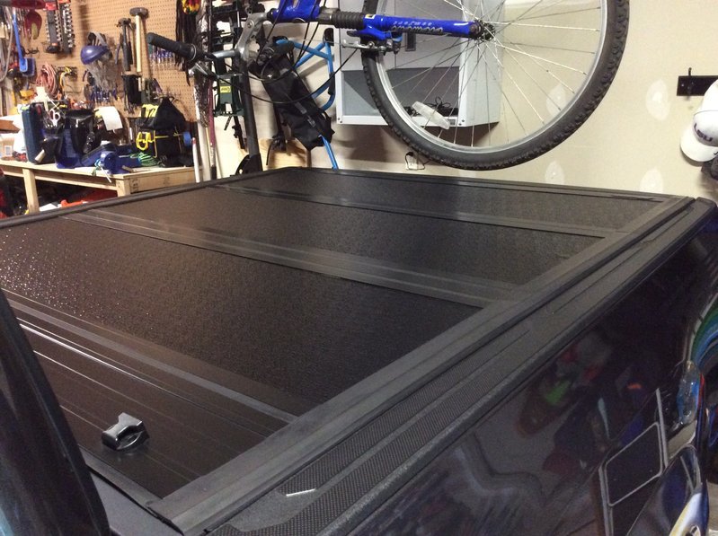

    Thats a sweet cover! Hope someone needs it so you can do whatever you're doin.

    Me too! If not, that's ok too.

    You need to find out what the power consumption of the compressor is. (Either Watts or Amps) that will tell you how big of a relay and fuse along with what guage wire you will need to power it.
    Edit: I just looked up your compressor and it says max power draw is 30 amps so you will need an inline fuse holder with a 30amp fuse. Next you need to determine how far away the compressor will mount from the battery, depending on the distance will depend on what gauge wire you can use. My guess is it will be less than 10 feet so you will need to use a minimum of 10 gauge wire to power the compressor, you can use almost any gauge wire to hook up the switch, I usually use 12 or 14. Same with the rock lights, they are such low power draw you can pretty much use any size wire.

    I got the compressor in the mail today. It actually has an inline fuse already attached. I didn't realize it would.
    Would it be feasible to cut the wires from the alligator clips and just add new ends for the battery attachment? Or should I still buy some larger gauge wire?
    There is a large space behind the air filter that it will fit/mount easily.
    Thanks again for your help.

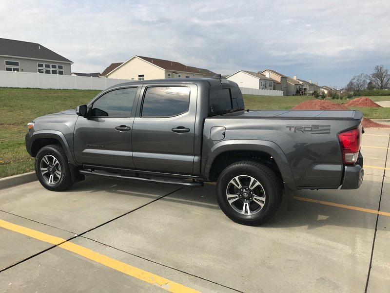

    Will that fit a double cab 2011 SR5 Tacoma?
