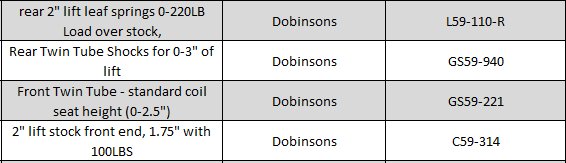

    Can anyone suggest a good shop around Columbia that has experience with lifted/modified vehicles or just aftermarket wheels? I installed my lift in January and had a local shop mount my tires and do the alignment but it still isn't right... I get a slight steering wheel shake between 40-55mph. Shop re-balanced twice and insists everything is "in spec". I'm thinking maybe a shop that works on more modified stuff might be my best bet.

    Running Dobinson's 2":
    Wheels/tires: SCS blaze10 17x8.5 w/ LT285/70R17 Cooper Discoverer AT3XLT

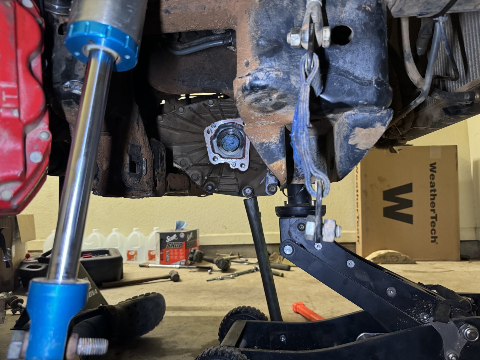

    Front diff is just loving life

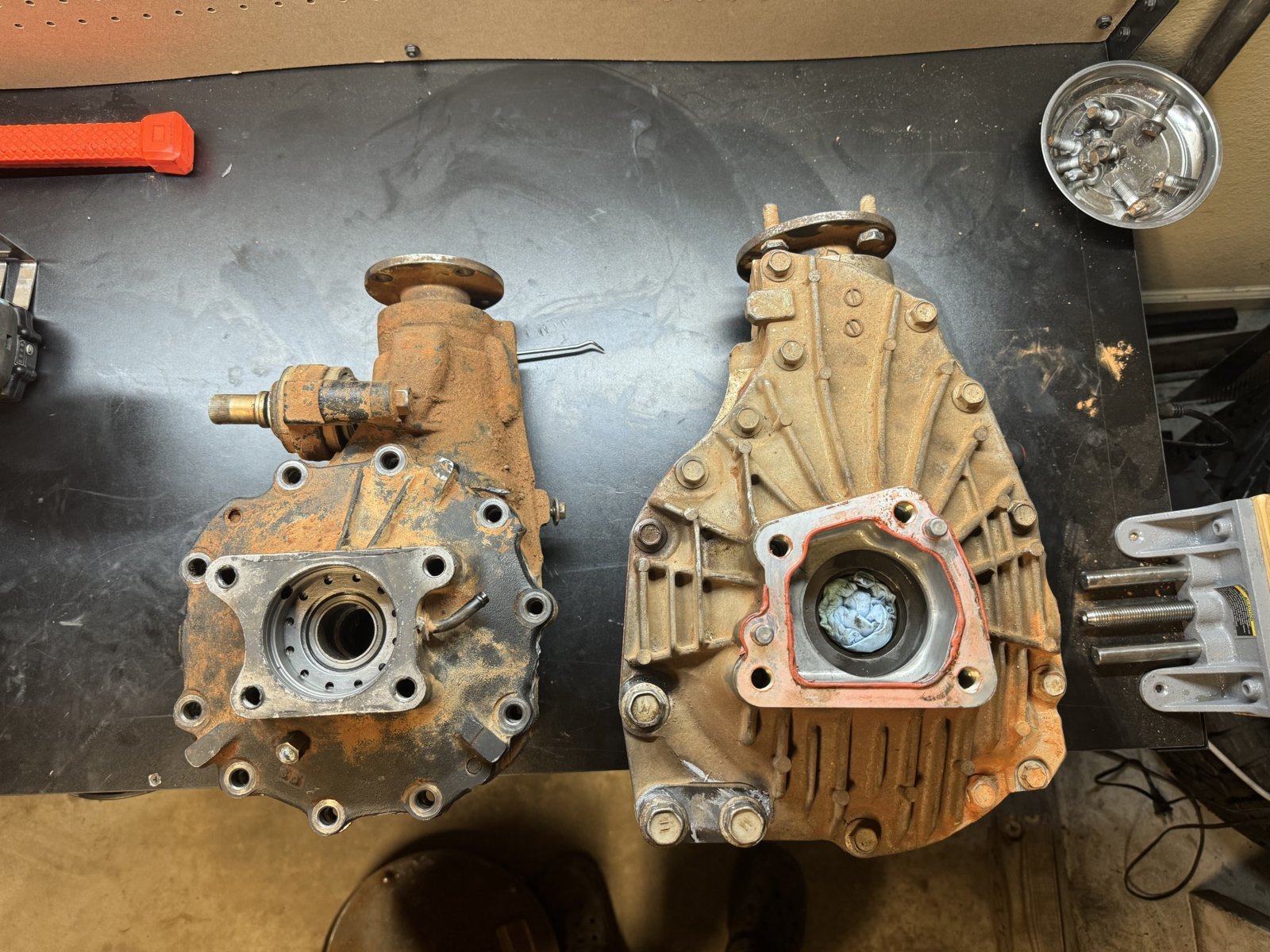

    Nah I keep a few spares so I don’t get caught crosseyed. Haven’t had one bend after I redesigned tie rods and I bent a few.
    I will say the clamshell isn’t bad to work on at all, figured I would have to press bearings or something to get the bonded seal but just open and knock off the ring gear then split the carrier. Seal housing has passenger side race inside it so I had to beat it out but a big dead blow and it all went back in well.
    Think I just screwed myself driving it home after breaking a jack shaft because I was too pissed to swap it.
    Hopefully I can solve those problems soon…

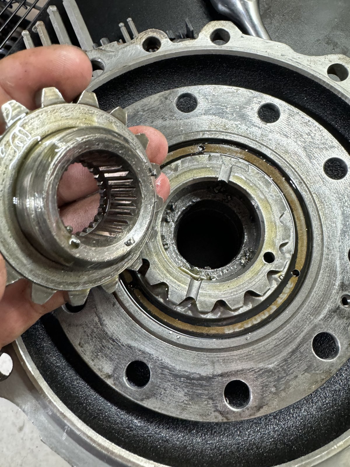

    bet it is the needle bearing.
    drive at 45-55 ish when you have the vibrations and shift in 4wd to see if they stop. if so swap the ECGS bushing for the needle bearing in the diff and be done with it
