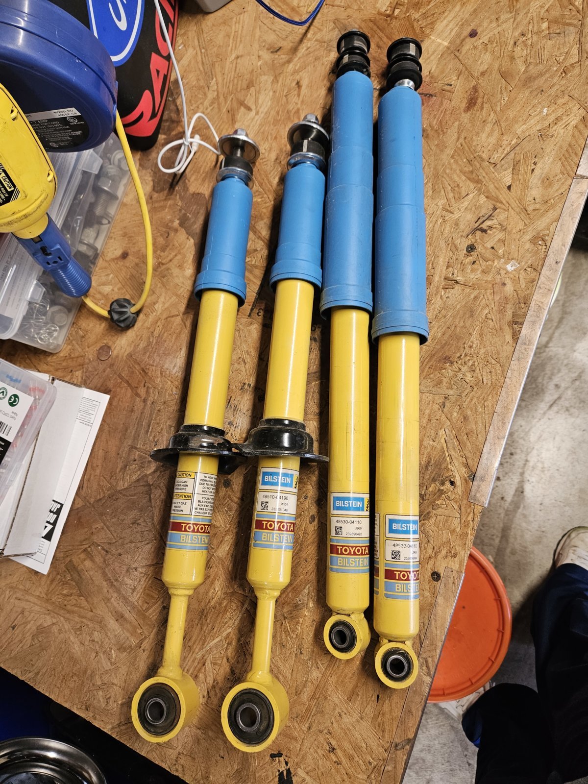

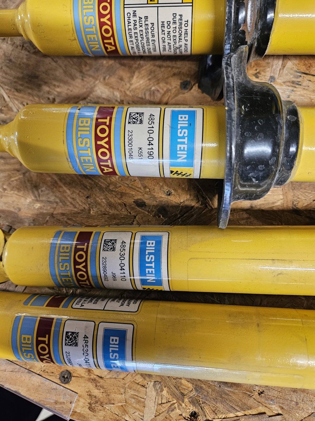

    Right on. I'm not sure I'm ready to go trailing yet. I'm pretty much stock on a new truck. Just did 5100's and 265/75r16's this week. I'll keep an eye on this thread.
    Also, if anyone needs stock TRD OR shocks and struts I got mine. They have 2100 miles on them.

    How much for the stock suspension out of curiosity?

    Meh, idk... $150?
