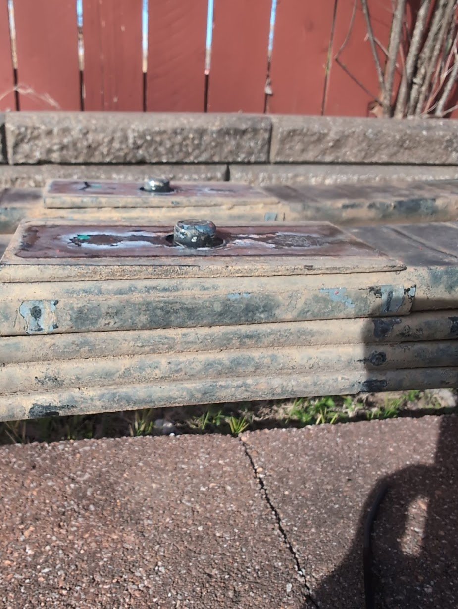

  12. Jun 3, 2024 at 5:18 AM
    TenBeers
    TenBeers Well-Known Member
    Jun 5, 2009
    #18067
    7,695
    Rich
    Bentonville, AR
    2018 TRD Pro Cavalry Blue
    Yeah.
    The shim is easy to miss and seems to be epoxied to the leafs. Here's a pic of my OEM leafs.
    AP1GczM9OQvfuzH91QsaTHH_N68PAO0_W91EuEPW_d1964e40e6d20315f26e3dde032a7f8fc8eccab4.jpg
    CygnusX191 likes this.
  13. Jun 3, 2024 at 9:53 AM
    DeeKay20
    DeeKay20 Well-Known Member
    Sep 29, 2020
    #342293
    245
    Danny
    Columbia MO
    2020 Tacoma DCSB TRD OR 6MT
    Dobinsons 2" lift, 33s....other stuff
    none on mine... weird
