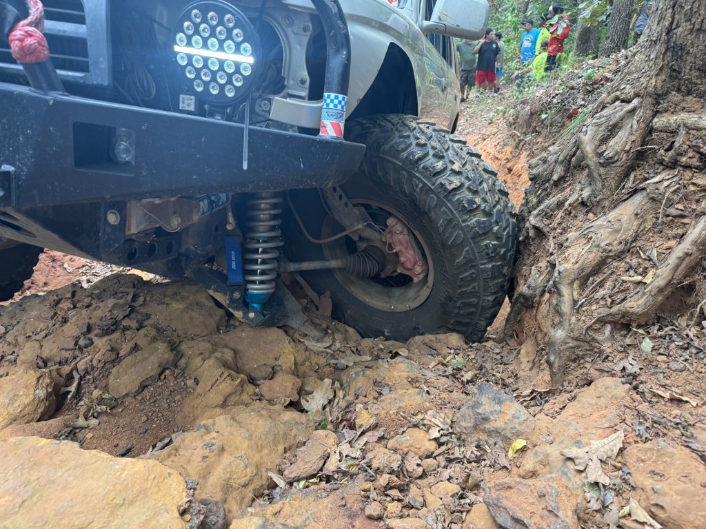

    So. Many. Stickers.
    With tundra steering

    Nah. Hydro

    Tie rods and steering rack are all good brother I drove home on them

    Ew
    "Good" and "this picture" Are two very different concepts :rofl:
    So what ended up happening?

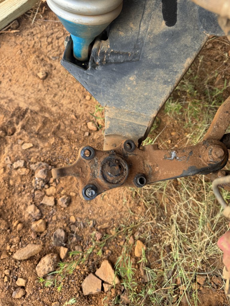

    Guess I caught the edge of that root at the same time I was hitting a ledge maybe driving too fast and the 4 lbj to spindle bolts sheared off.
    winched it up into a tree and pulled the tire off then dropped it down on a 2x8 that was ratchet strapped to the bumper and skidded it out, drove a good bit in 3wd and had to pull cable the rest of the way.
    set it up on two tires and replaced the spindle, lbj, and a fresh set of oem bolts and drove it home. Had to pull cv also since the rcv inner pulled apart. All the clips are still in place so I still need to figure out why it came apart and reassemble that, may just have been the extreme angle.

    I think that's more than just bent :eek:
    I retract the statement, after viewing the sheared bolts. Damn!
