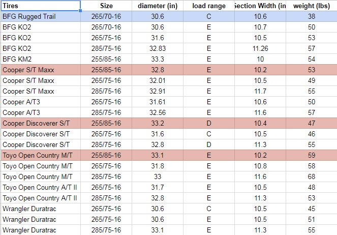

    here is some info I gathered when I was figuring out what I wanted. Food for though.

    The 255/85's?
    I prolly have 5k mi worth of good tread left. Which is 3 months for me. I have time to shop around if the deal comes back somehow.
