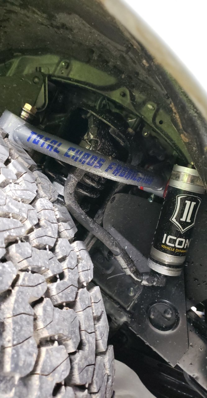

    What are the tires rubbing on? If they're rubbing on cab mount then yeah it might be a caster issue. If they're rubbing on UCA or LCA thats a whole different problem.

    Definitely on the cab mount. I'm going to try and call them today and see if they have the spec sheet. I need to do some more research first on what everyone has been able to achieve on their caster numbers. Most threads say 3.0+ is ideal. Just need that wheel pushed forward just a tad !

    So on 3rd gens factory caster is +2 I believe. I'm sure someone will correct me if I'm wrong but that's always what I've been told. I'm personally running +2.25 on Total Chaos Uppers. I've also found that a lot of those generic tire stores like Dobbs adjust caster by moving the Upper Control Arm instead of the lower. So to achieve positive caster they'll move the Upper rearward which will actually move the tire closer to the cab mount. What you need to tell them is to adjust by moving the lower forward. Again someone please correct me if I'm wrong but that has always been my understanding.

    Yea i think the tolerance is between 1.75 and 2.5 from factory ? I'm not sure how they could adjust the UCA but i also know nothing about aligning a vehicle other than with the LCA haha.

    Factory UCAs have an adjustment to them to move forward and rearward I believe

    Sorry didnt mention that, TC UCAs not factory

    Ok yeah those are not adjustable so theres definitely something up with your alignment then

    Those are definitely not adjustable. Neither are stock UCAs. The tacoma has always been a lca adjusted alignment unless you buy spc or heimed uppers.

    yeah thats a type-o, I meant to say NOT adjustable for the TC Uppers but I stand corrected on the stock UCAs not being adjustable.

    I figured that was the case. I put them on so i was wondering how the hell they adjust them since its just a bolt and washers holding it to the mount hahah. All good brother, thanks for the help :thumbsup:
