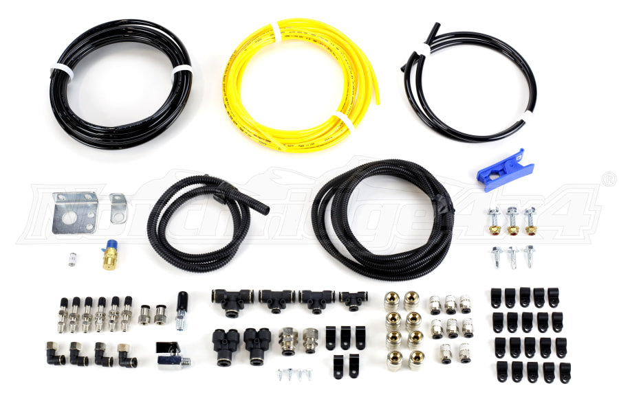

    rago sells a kit like that - the price is pretty painful though... Really not that hard to make on your own for a fraction of the cost.

    I was just thinking something like the MORRFlate system but much cheaper to make yourself cause those run $180-$200

    Looks like a direct knock off of Dean’s system. Dean died of a heart attack about three years ago and his wife just sold everything left from Rocksmasher and is doing her own thing now.
    I agree that if enough of us here wanted to have it on our cars we could bulk buy and everyone would save. I’ll put myself on the list.
