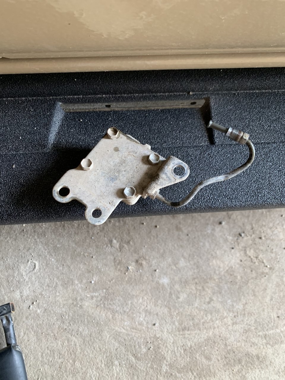

    Any of you guys with the MT, need to rip out this POS. Best $20 ever spent

    I've been looking at that. Did you buy it from the dude on the forum or make your own?

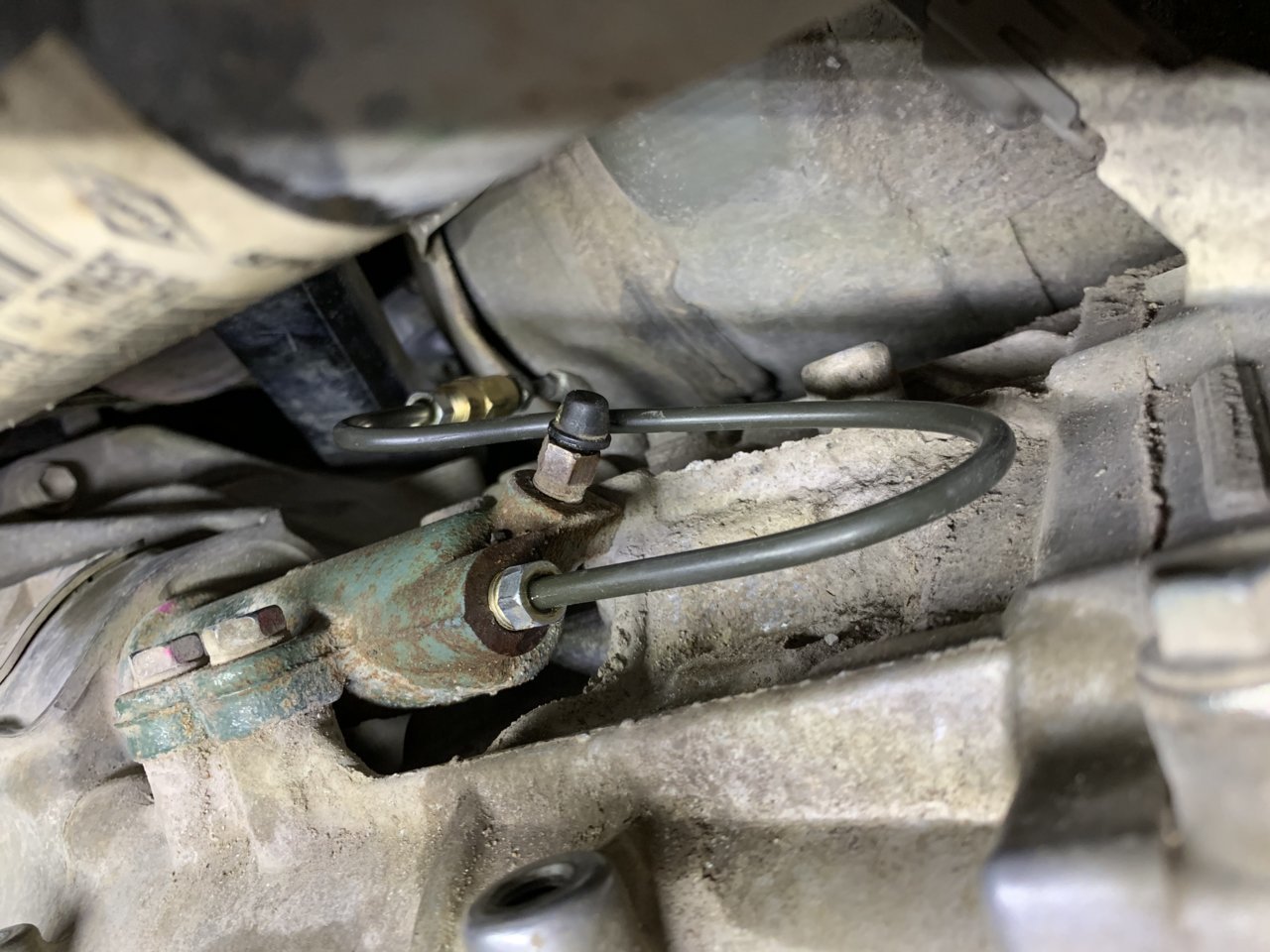

    I bought the parts and made my own. Once you get the accumulator out you can use that for somewhat of a guide. As long as you get a good seal on both ends, it’s all good

    I wish I would have done it Day 1 (87,xxx miles ago for those wondering). It’s amazing how much different it is

    I've seen some posts about this ADM(od) but never a good, concise explanation as for why it needs to be done.

    The accumulator is basically a big stupid restrictor value. Toyota put it in to slow clutch engagement or disengagement. Without it in place, the fluid flows unrestricted and it is much smoother and more predictable.
    Think of it this way, with the accumulator in place, the slave cylinder is always behind what your foot is trying to do.
    I wasn’t sure how much difference it would make, but it was immediately noticeable.
