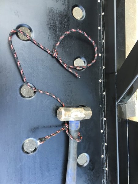

    Copied SE overland, hopefully this will pull the CV without fuss

    Interesting. Are the truck cvs supposed to be a pain to pull out? Ive never had issues on any other cvs/cars.

    It has a C clip on the inside that keeps it in place, most say its a pain to get out. This method is supposed to make it easier and no damage to the seal

    That should pull the CV no problem. I used braided steel cable for mine, but it came out easy. Hardest part was getting the axle out of the hub, be careful with the axle nut if you have to hammer on it to get the shaft out. I jacked up the threads on mine doing that and had to buy a new nut, they are super soft compared to the axle. The rest of the bushing job is pretty easy.

    I thought about even running 2 snatch blocks but common sense is telling me I shouldn't use a winch to pull my CV out :rofl: My wheel bearing is pretty clean so I'm hoping that it will slide right out
