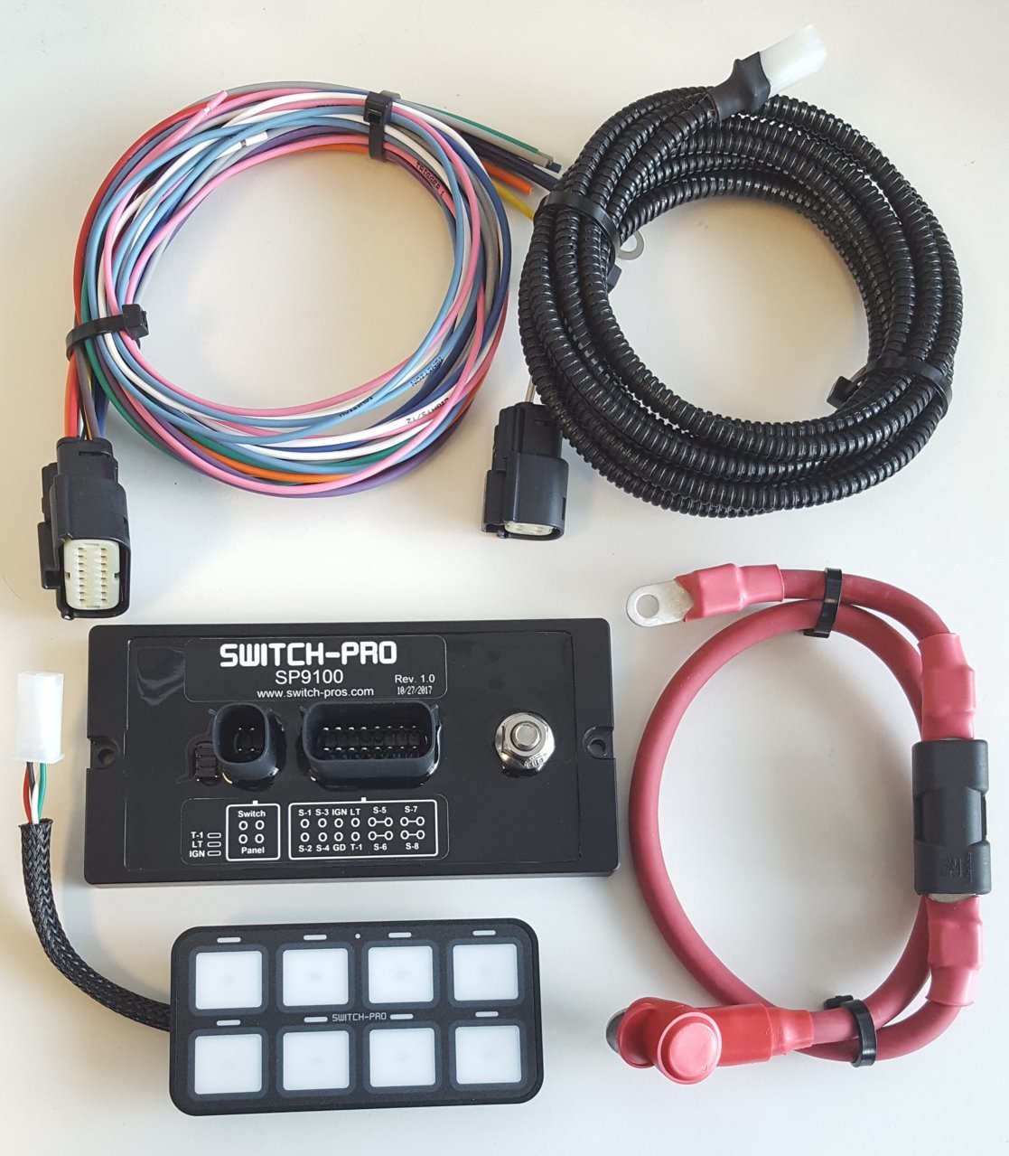

    Yeah. There’s way more to it than just being a button
    there’s also an App that you can use to control and configure everything

    When you showed just a picture of it like that, didn't look like more than just a few buttons haha.

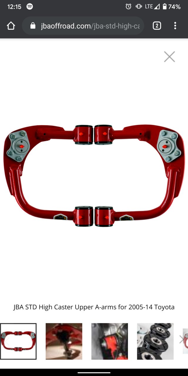

    I keep seeing yall talking about uca and lca's swap outs... ..will adding these help my alignment issues or is it just strengthening the hardware and making more capable offroad?
    I havent had much time to research or work on my truck lately so sorry if it's an easy searchable answer.

    https://store.switchpros.com/sp-9100-switch-panel-power-system/
    Red one to the battery
    Black shielded one to the controller
    Other one has the leads for your accessories and control wires

    Okay, that is a insanely heavy duty setup.

    My camber and toe are in spec, but caster isn't. Before I put my C4 bumper on, my truck wandered a little bit on the highway. Steering felt all loosey-goosey... I think adding the bumper and that weight has helped but hoping the caster that these will provide will fix the issue properly.

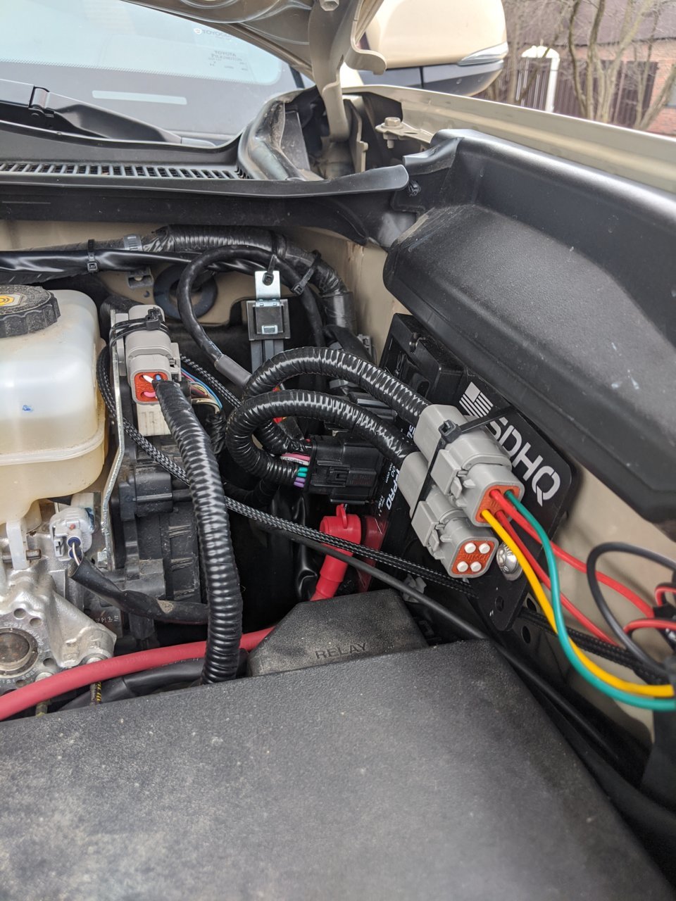

    I kept things as simple as possible under the hood. Saw someone on the Switch-Pro thread use Deutsch Connectors so I did the same.
    Drilled a small hole in the bottom of the fuse box for Ignition, lights and trigger wires.
