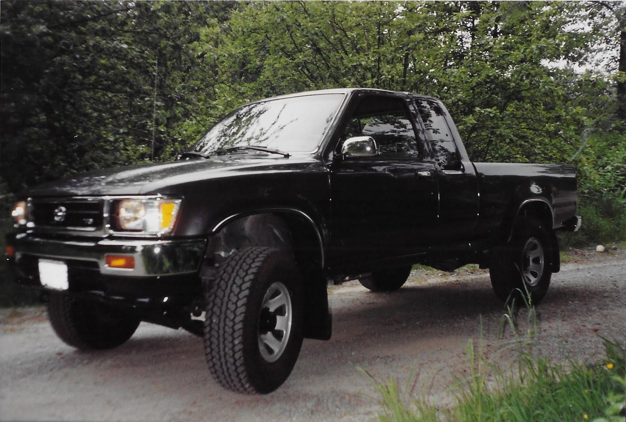

    I have a 1 year old Tacoma that I bought new last year. Prior to this I had a brand 1992 Toyota 4X4 Truck. Owned It for 14 years and the only thing to rust was the rear chrome bumper & Hitch. Everything else was okay AFAIK.
    Just wondering if there are any local, original 1st, 2nd or 3rd gen Taco owners in the Lower Mainland who use any products to prevent rust. I don't like undercoating, I'm speaking about only using Fluid Film Or Krown. Just wondering if anyone living here full time bothers to apply a rust inhibitor on their Tacos Frame/Undercarriage?
