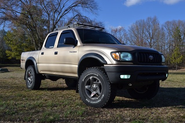

    How it sits as of 7/19/13
    Mods to date:
    Engine and some
    -3.4L V6 (stock)
    -TRD e-locker
    -Deckplate Mod
    -Engine bay light mod
    Suspension
    -Bilstein 5100s
    -Eibach Coils
    -AAL
    Coming Soon..
    --Dakar leaf springs
    Exterior
    -5000k Morimoto H1 retros from TRS
    -Fog light mod
    -Sockmonkey black badges, black hood retro stripe and "TRD Expedition" bedsides
    -Bed rack mod
    -Painted bumper and grille duplicolor bedarmor (black)
    -Front Runner style custom roof rack
    -custom rear bumper
    Interior
    -Wet Okole seat covers
    -Maglite mount
    -Ultraguage
    -Peripheral PXD Ipod Adapter with custom mount
    -Garmin 40LM GPS
    -Fire Extinguisher
    -Factory alarm system mod
    -White LEDs in the dash
    Future Mods:
    -4x4 conversion (someday)

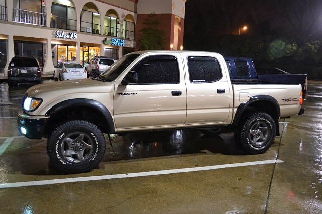

    Stock photo: Bought in October of 2012 with 123,236 miles for $12,000 out the door

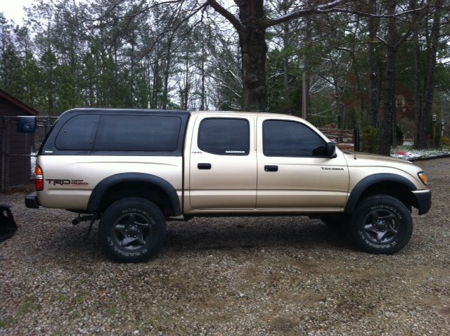

    Got this Snugtop camper but after having it for a few weeks, I decided I wanted to go a different route for now.

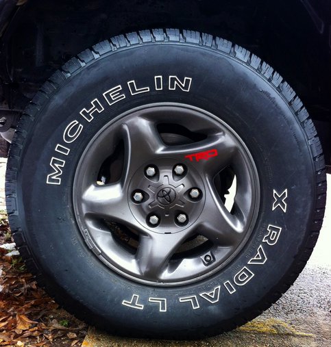

    Also got some TRD stickers from Sockmonkey and threw them on my stock wheels I painted Duplicolor "Graphite." I think they look great! Thanks Sock!
    A few people were interested in the paint I used and what my process was so here it is:
    There are two kinds that are basically the same color. Duplicolor or VHT "Graphite".
    1. Sanded with fine sandpaper
    2. Sprayed brake cleaner as a degreaser and cleaned them up really good.
    3. Rustoleum self-etching primer, and gave them some heat with a heat gun. (not too much or the paint will bubble)
    4. 1 coat of "graphite", heat gun, another coat of graphite, heat gun
    5. 1 coat of rustoleum wheel clear coat, heat gun, another coat, heat gun.
    After each coat, I used a heat gun and slowly heated the wheel and then let sit for about 5 minutes before I added another coat,then used 2000 grit in in between each coat on the small imperfections. Also, make sure no dust settles on the wheel between coats.
    AND WALLAH! They are holding up great!

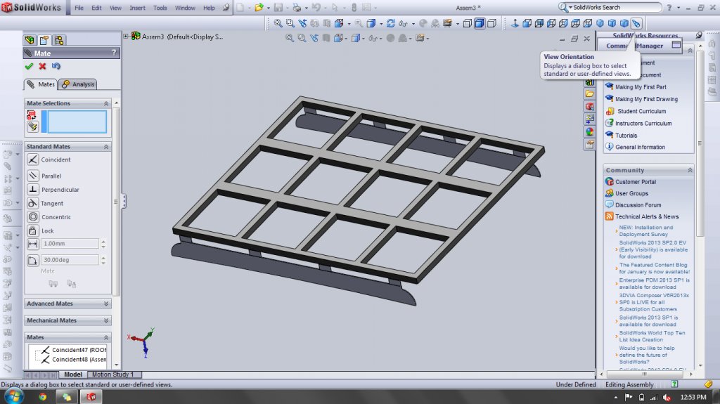

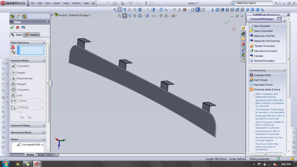

    Tried to replicate (as best I could) on a CAD software the FrontRunner mounting rails since they no longer make them and sent the .dxf cut files to JLee at B.A.M.F. I'm getting him to cut the main piece and then I will weld on the tabs and any other mounting points I need to the main frame that will be CNC'd. Here is a mock-up of a basic rack on the roof rack rails. There are a few parts not shown in the picture (feet, side mounts, etc), but you get the point. Also I slightly changed the design from the first picture to the picture with the rack. Hopefully, in the end, this rack will be a little more low profile that the FrontRunner one. I just hope that it functions as good as their design.

    Be careful of the height (or lack of height) in those rails. The roof of the truck is not flat so your rack will be closer to the roof in the middle than it will at the rails. I'm sure you can make the adjustments necessary in the tabs you weld to it to get the height just right.
    what do you intend to do for a pad between the roof and the rail?

    I initially had the tabs being cut with the main frame, but I thought pretty much exactly what you said. I didn't want to chance my measurements and screw up the whole mounting system because I made the tabs too low, so i figure I can just weld them on myself and make it sit at the exact height I like.
    As for the pad, kind of hard to explain, but my grandpa has a roll of "rubber sheeting" that I'm going to cut and hopefully I can make that work. If not I will come up with something.

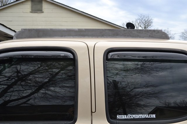

    So, let me make one suggestion for the rubber pad you put under the rails. The thing that makes the Front Runner ones so good is that the rubber pad they used has a slot that slides over a "foot" that runs the full length of the rail. That rubber extrusion is also what made it so expensive for them to produce and why they ended up discontinuing the product.
    I was working on some designs of my own for quite a while (exactly like what you're doing) and was going to use some easily sourced rubber pad. The problem is that you'll need to find some way of having the pad actually attached to the rail. If you don't, the pad can vibrate out from under the rail. I was surprised that even with what I thought was a lot of clamping force holding the rack on the roof the pads could shift and wiggle loose (especially if the roof got wet in the rain for example). That creates the potential for the metal rails to come in direct contact with your roof and really jack with your paint.
    I think the best option is if you can find something like a rubber pad that has 3M adhesive on one side that can be stuck to the bottom of the rail. I even considered using weather stripping adhesive. But I wasn't able to find something that I was satisfied with. I'm sure there's something out there I just didn't look long enough.

    That's going to be my biggest problem IMO. Because even the 3M adhesive may have a tendency to shift, causing the metal on metal contact, especially with circumstances like a load or rain. I won't get my rails until next Friday, so until I actually have some metal in my hand to work with, all I can really do is think about it.
    One possible option is the thick version of weather stripping typically used to seal a camper shell. Another would be to somehow make a channel in the heavy duty rubber I have for the rails to slide in. (not really sure how i would manage that though..)

    That's exactly what the Front Runner ones are. The rubber extrusion to get the groove in the rubber is what made it cost prohibitive.

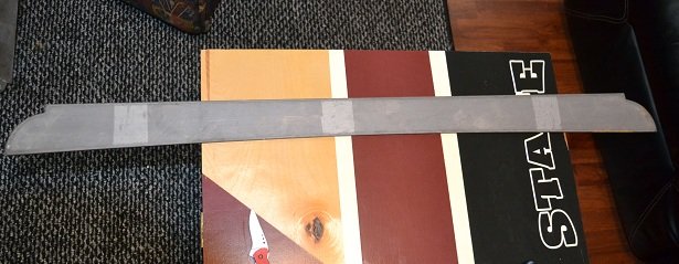

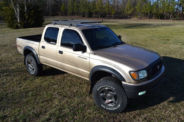

    Got my roof rack rails in that I got JLee at B.A.M.F. to CNC for me. They fit perfect! I can't wait to get to welding and finish this up!
    Also got my Treadwright Warden A/Ts in today! Here's a sneak peek, more pics coming tomorrow when its not raining

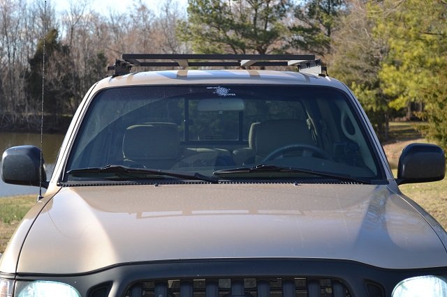

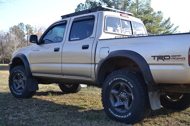

    Started my version of a Front Runner roof rack. I'm not completely done with the rack, still have to add a few cross beams but the main stage is done. All in all it turned out great, I can stand on top of my roof without causing any problems. I have to make a few adjustments here and there.
    I sent a .dxf cut file to BAMF and got them to CNC my main mounting frame and got a lot of steel from a local warehouse. (1" square tubing, 1.25" flat stock, 0.5" angle iron, and 1" x 2" square tubing) The brackets that connect the rack to the cab were the hardest part, but after a long day of measurements and welding here it is.
