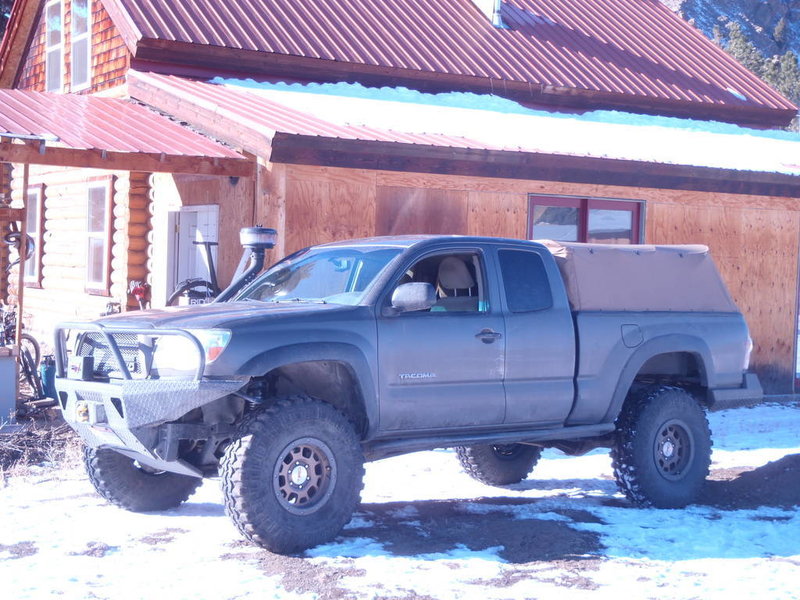

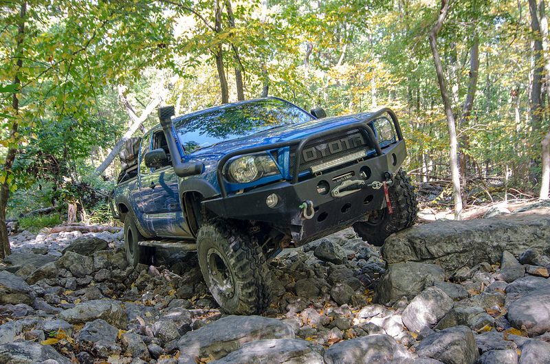

    Builds I've been using as reference while I figure this out:
    BabyTaco's setup: 315 MTR's, 16x8 wheels, +.75 spacers
    (I'd rather my tires not stick out this far but it could be his lack of flares and oem bumper making it look that way)
    Nate87's Setup: 315 MTR's, 16x8 4.5BS, +.75spacers
    (Same specs as Babytaco but look way different.. has to be the flares)
    PSU Taco87's setup: 36x12.5 TSL's on 16x8 4BS
    n0rth's setup: 36x12.5 TSL's, 16x7.5 4.3BS, +1.25spacer front, +1spacer rear.
